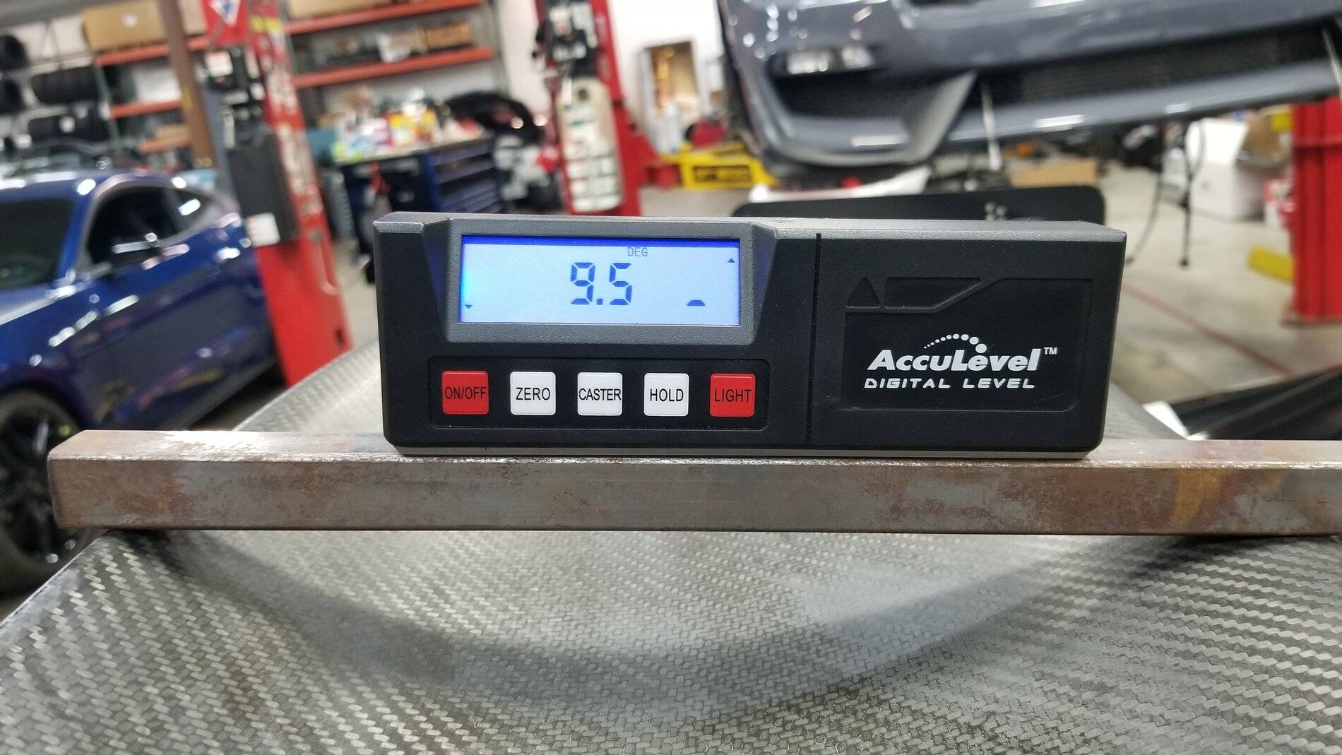

I have a project going on and am looking for some data. I need to obtain AOA numbers for the CFTP wing with the vehicle at rest on a level surface. I have some CAD numbers but need to verify from an actual CFTP car. If any CFTP owner can do this I'd greatly appreciate it. And while I'd love to get the numbers for each of the two available settings, if you can only supply one number I'll do my best with that but just need to know which one it is (the more aggressive or less aggressive setting).

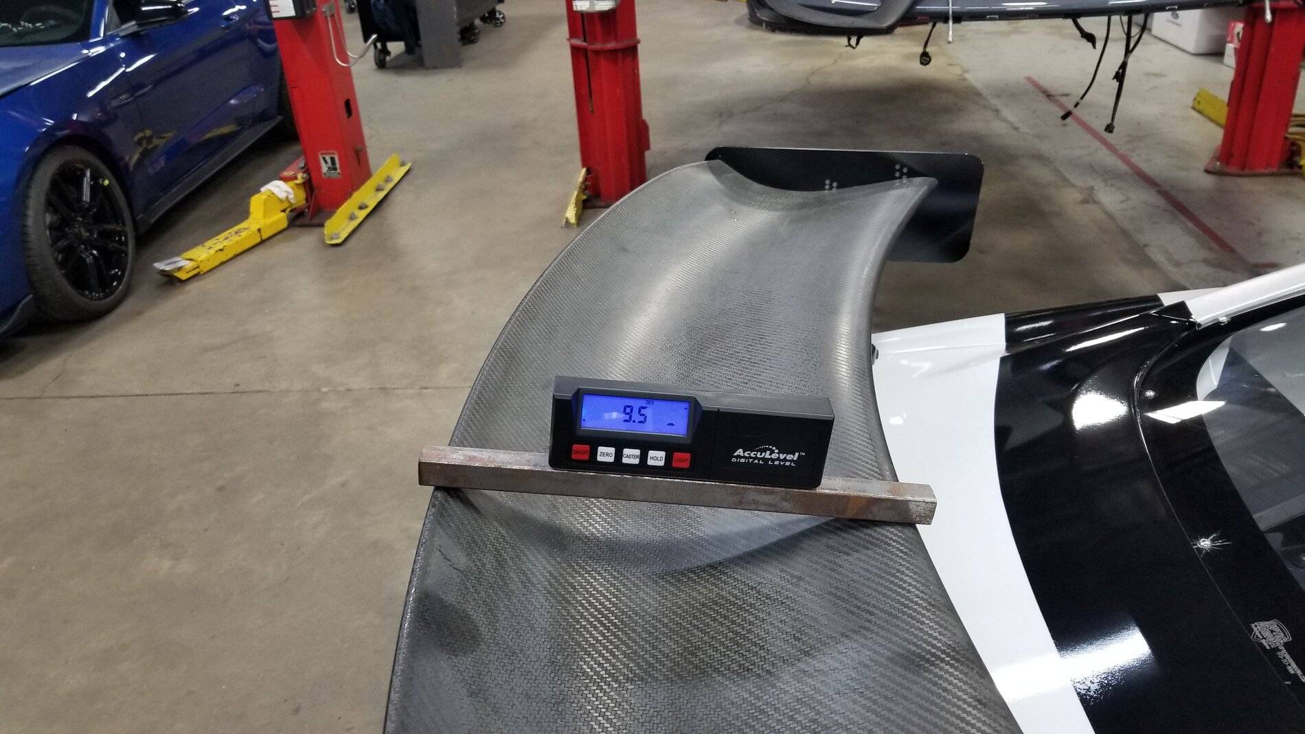

I measured it on an actual GT4 car a couple of days ago. Note that there is a much wider range of adjustment on the actual GT4 car but again, I'm just trying to find out what the CFTP angles are. Here's how it was measured, a straight edge was placed across the airfoil section longitudinally and an angle finder was placed atop it...

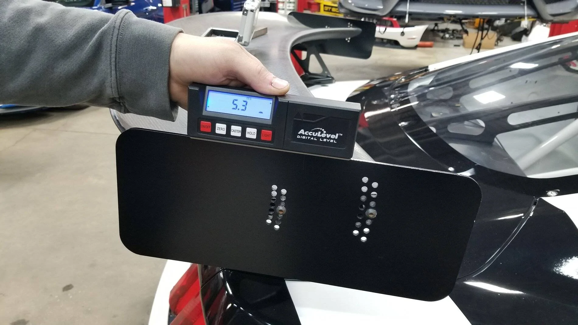

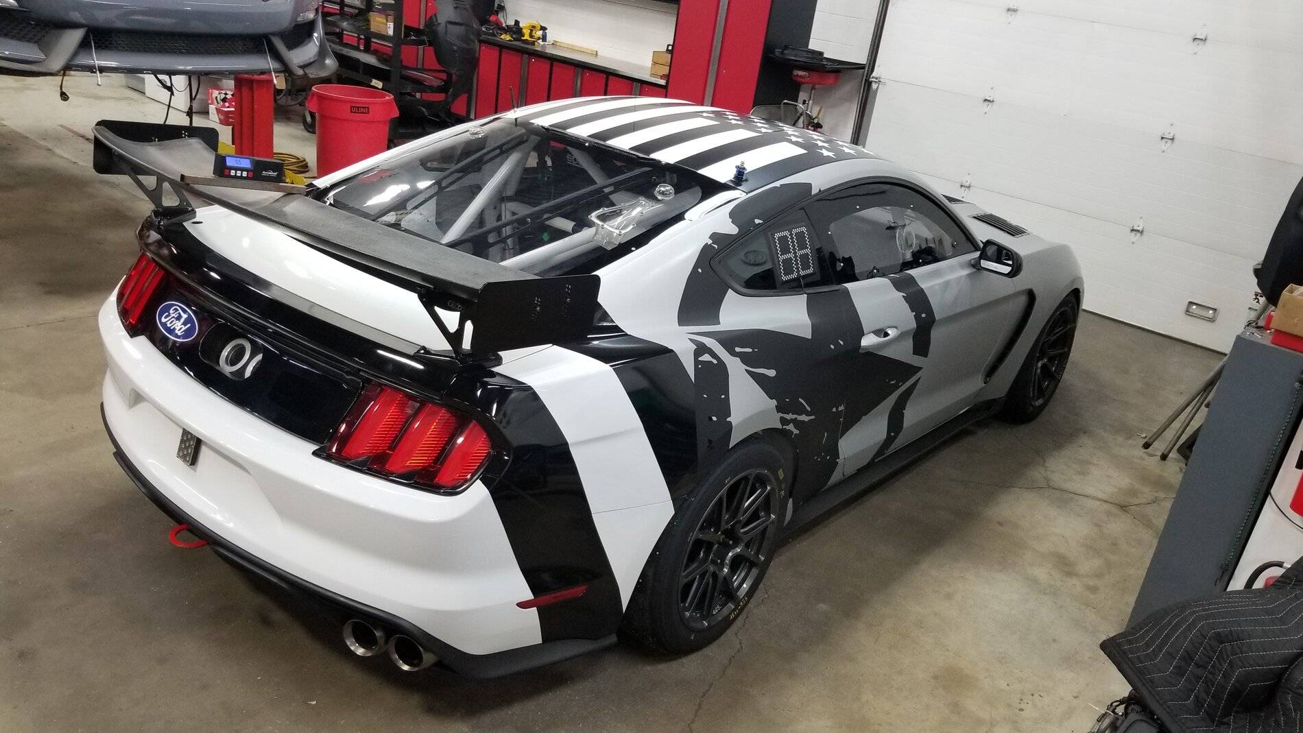

I'd also be interested in the winglet/end plate angles for a given AOA. This was what the GT4 wing was set to...

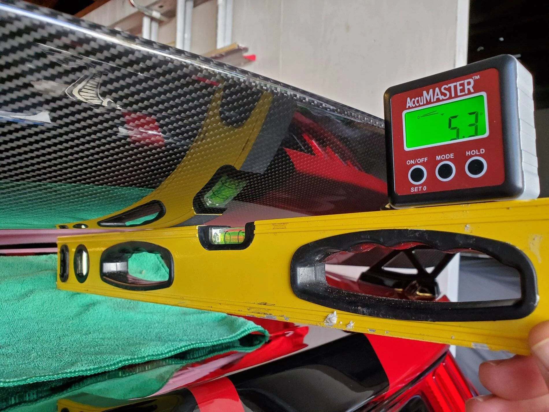

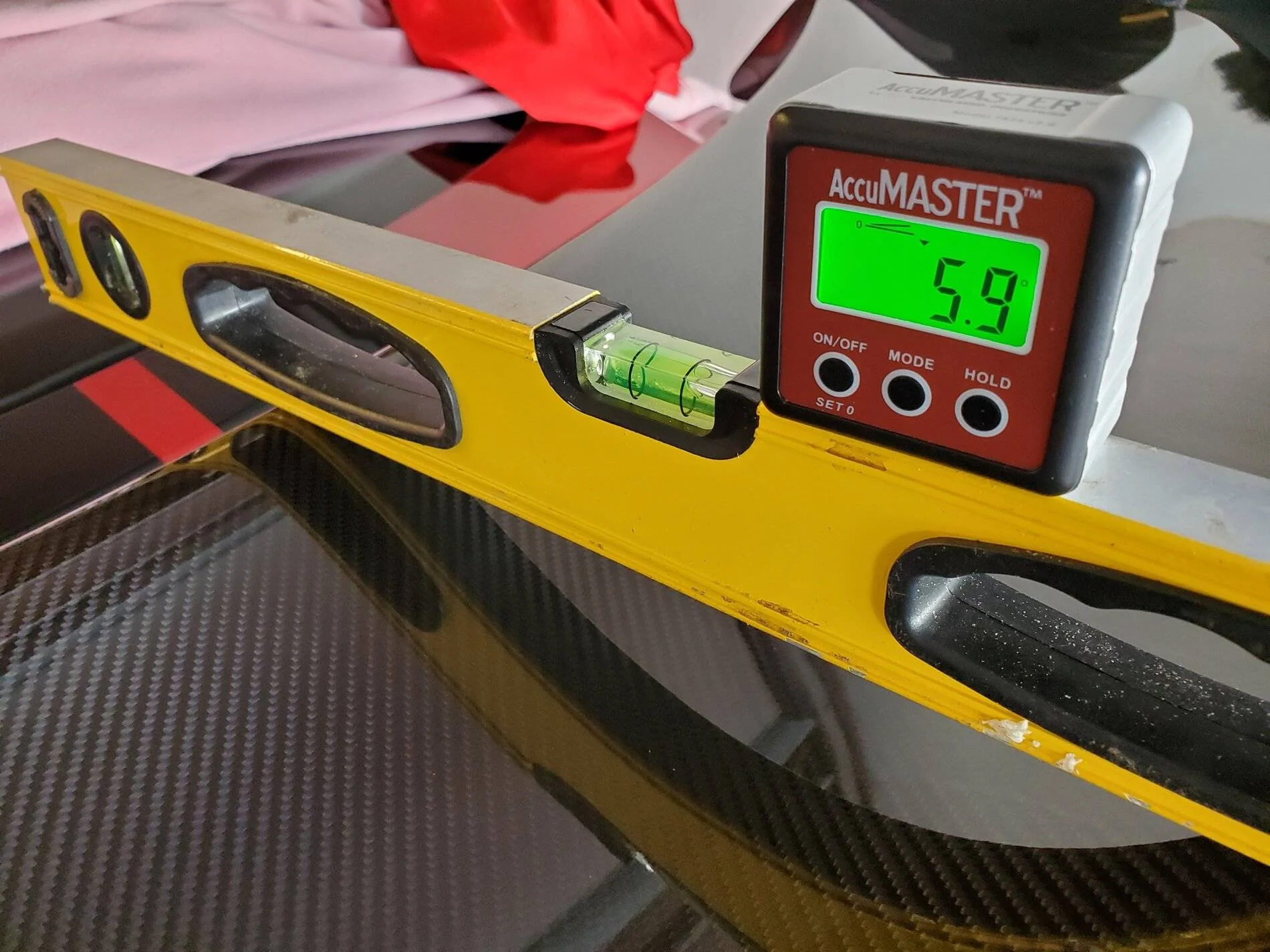

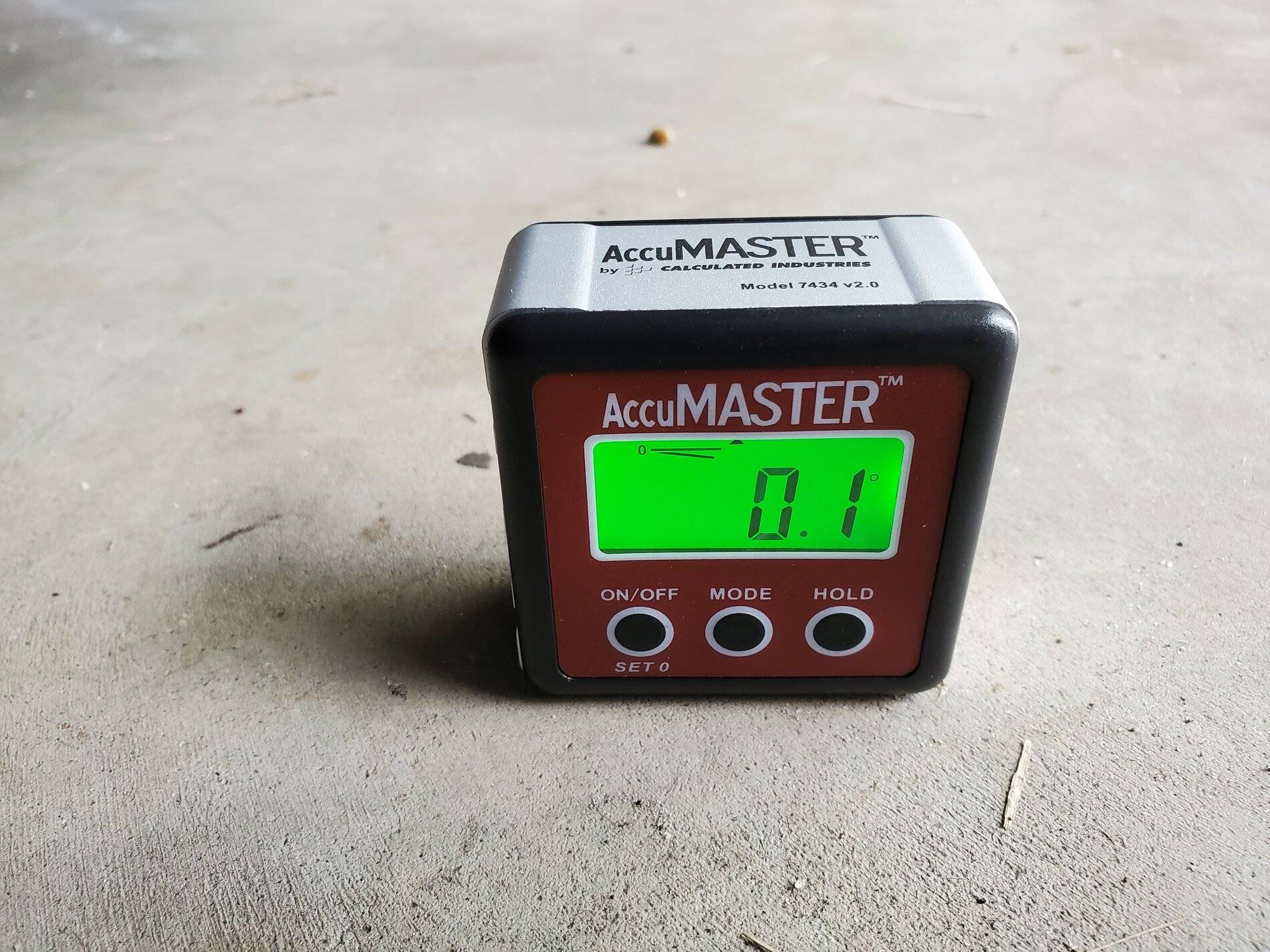

Here ya go.

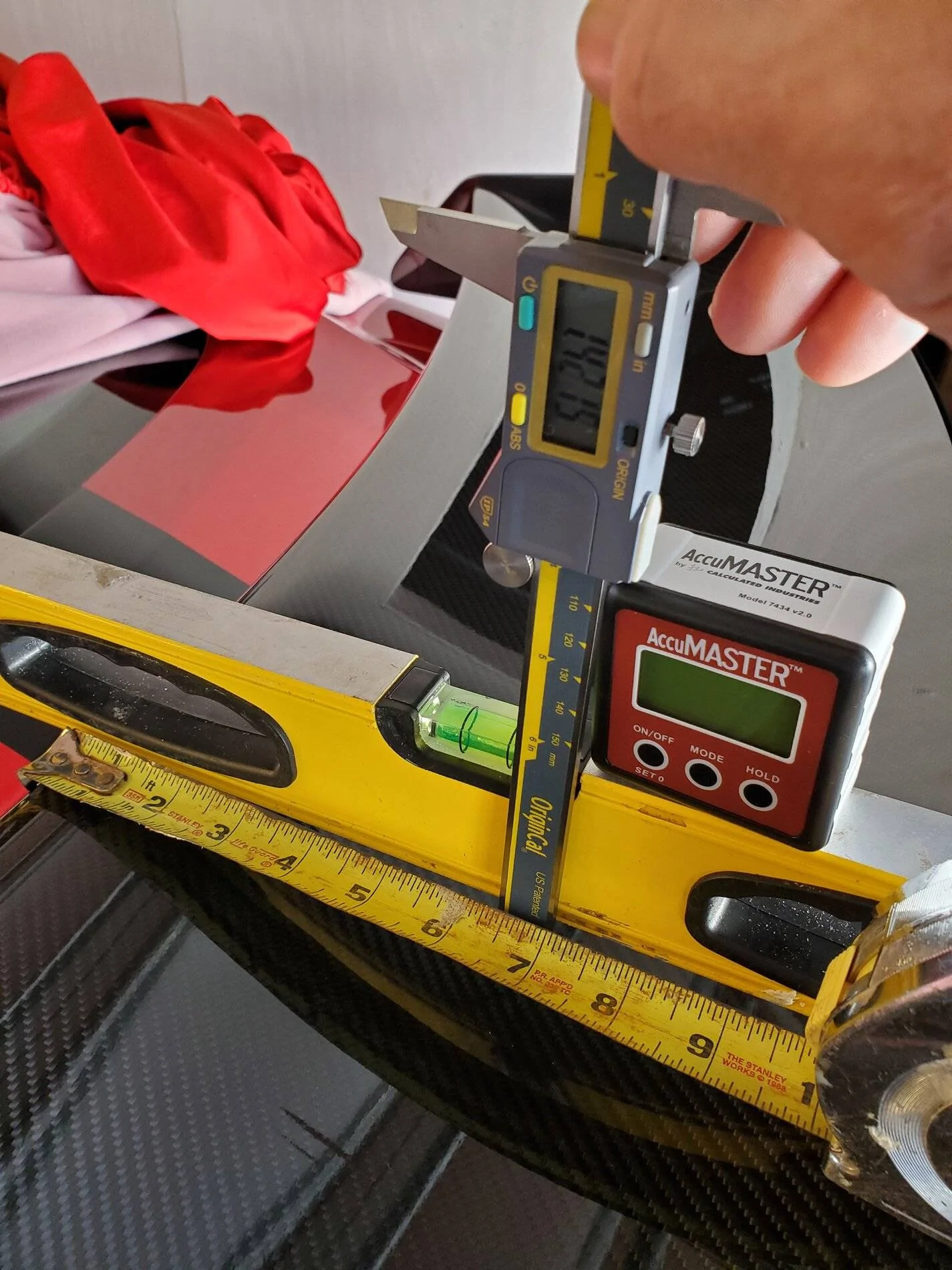

To be sure this is an apples to apples, you have to also verify the camber of the wing as well as geometry.
The first photo shows the floor is essentially level.
The next is the angle of incidence.

Maximum camber occurs at about 4.5" aft of leading edge and is about 2" deep referencing the leading edge.

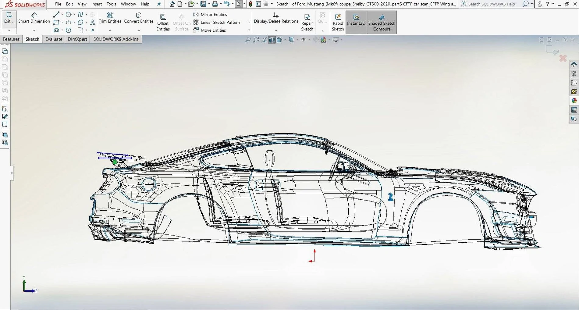

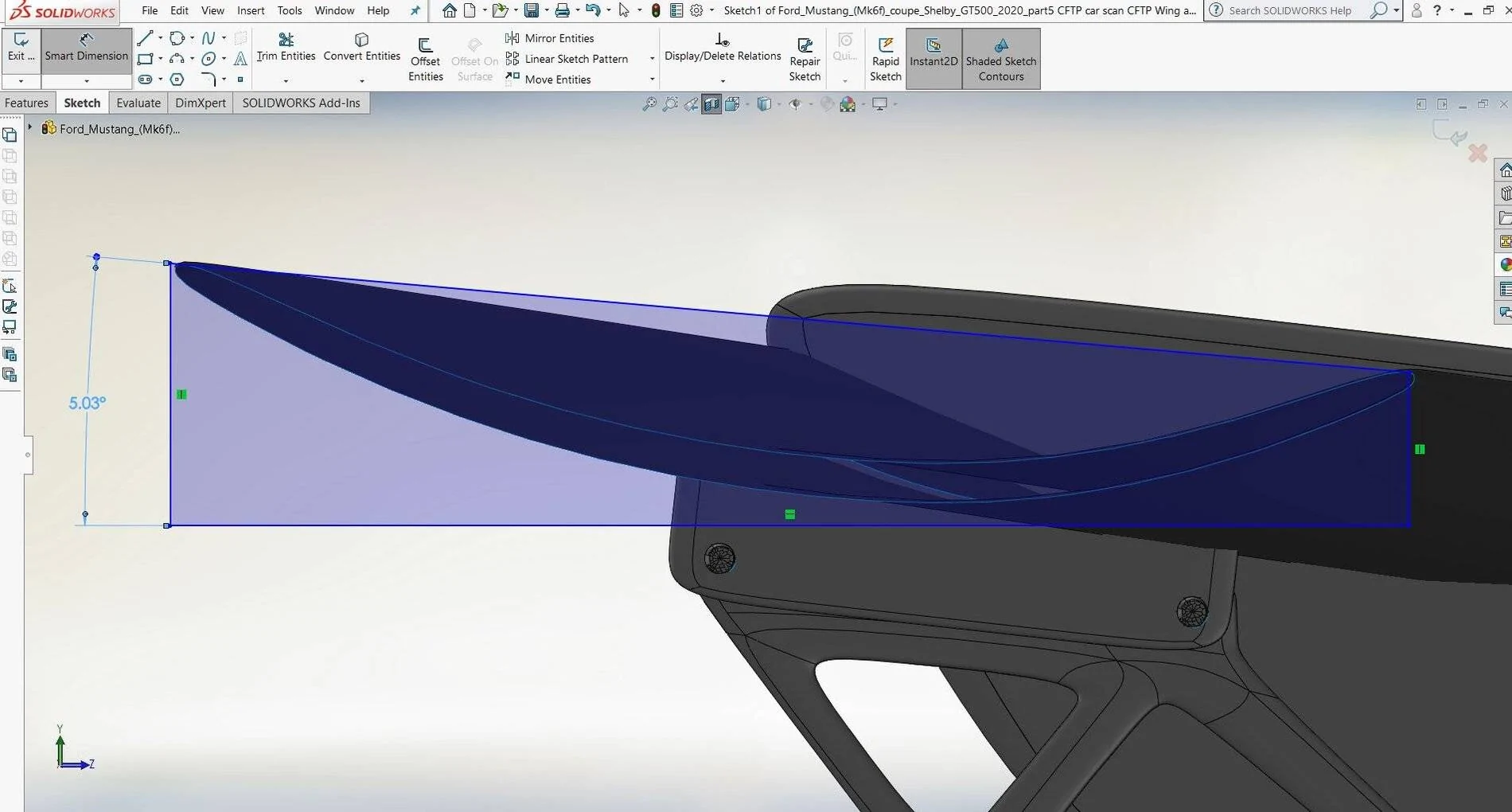

If it matters, I looked in CAD at a side view. I sketched a horizontal line beneath the wing and then ran another from AOA point to point to give me a number in degrees. Not sure if the 5* I saw correlates to the milder street setting or not.

The settings I sent you were the angle of incidence (for the wing track setting). Angle of attack is the angle of the airfoil in relation to the airstream. Angle of incidence is the angle that is fixed to the chassis. In aircraft, the angle of attack varies with the angle to the airstream. In a car? The angle of incidence is probably about equal to the angle of attack, because the car's deck angle really doesn't change much. In normal circumstances, the difference is probably insignificant. What does change is the speed of the airstream and resulting downforce, which makes me wonder if this has to do with the artificially induced 180 mph speed limitation. The faster you go, the more downforce. You reach a point that too much speed could result in too much downforce. Think about the load on those rear tires..... it could very well be detrimental.
