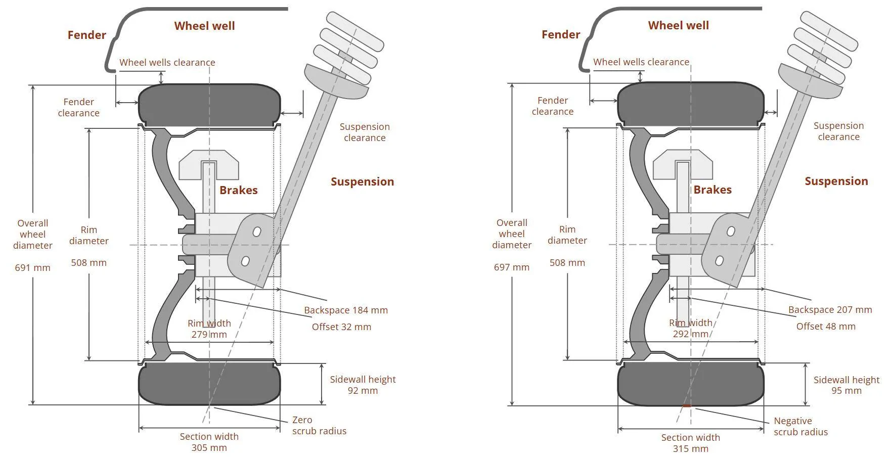

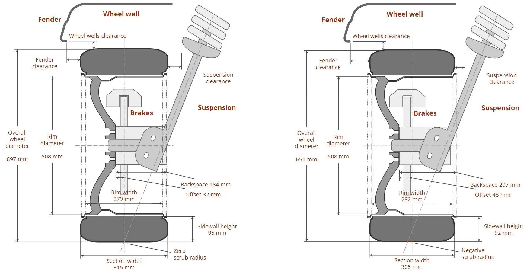

Continental ExtremeContact Sport 02
I found 305/30ZR20 103Y XL in your front wheel size. If it was me, I would buy 4 same size tires. The rears would be slightly stretched compared to fronts, probably hardly noticeable. (See image below, modeled for your 20" rims and OEM tires.) Also, when you buy all four tires the same size, the warranty period is not cut in half.
Otherwise you can get staggered 305 & 315 in the Pilot Sport 4.
This image models a 315 tire on your 11" front rims, and 305 tires on your 11.5" rear rims. The left shows a slight bulge, while the right shows a slight stretch.
For reference here is the OEM fit for rims and tires:
