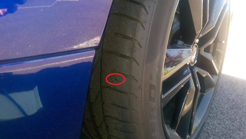

Also, wondering if this would turn into a big deal at the track (it hasn't been on the street/highway...):
It was a tiny piece of gravel that got imbedded in the tire tread. I popped it out with a key, and it left the mark shown above :crazy: And yes, those are the stock P-Zeroes...it's on the Left Rear.

I track on the stock P-zeros (gt rears), no that rock mark shouldn't be a problem.
And just a hint, the stock tires like 36 psi hot, anything more and they tend to get greasy.
