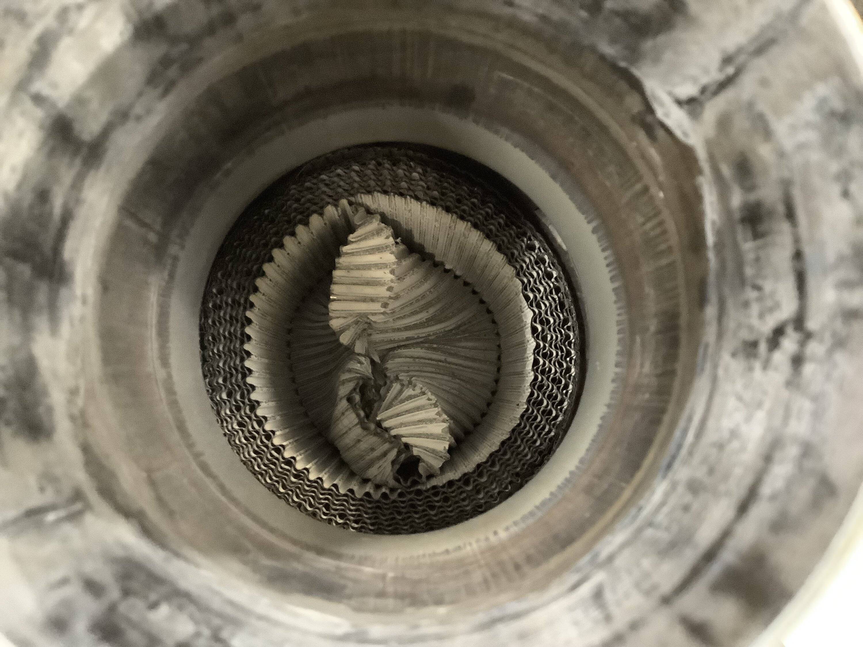

Has anyone pulled their exhaust and done an inspection of the pipes to see if there’s an indication of the cats loosening up and starting to fail? When mine failed, I could hear the immediate change in the exhaust note. Pulling the exhaust confirmed what I had suspected. The cat material was being sucked in and blown out during acceleration and deceleration.
Adding Vibrant race mufflers in place of the cats definitely increased the sound of the exhaust note too.
Scary stuff right there.
Now I have to go home and pull my cats and inspect. Thanks alot
