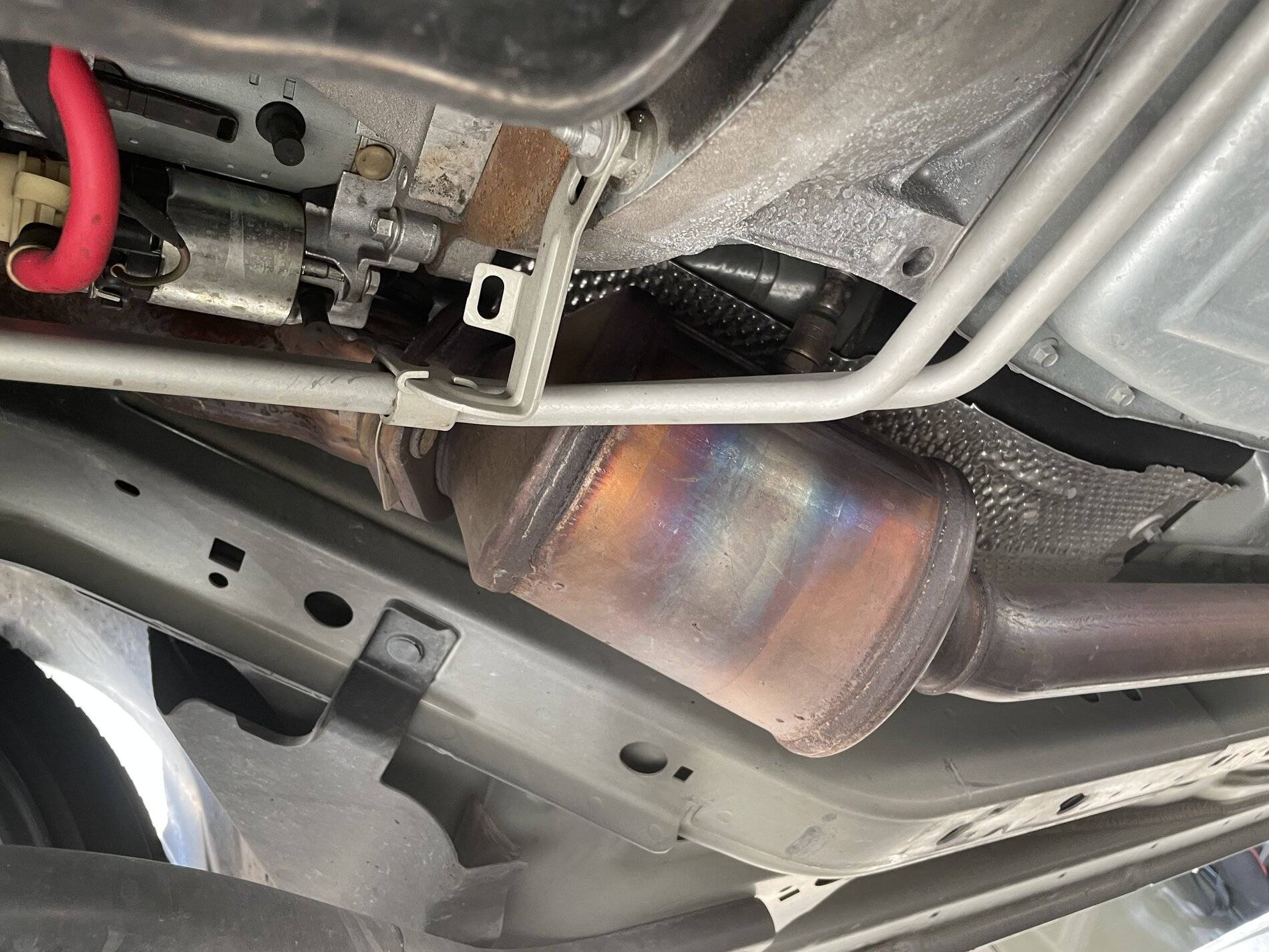

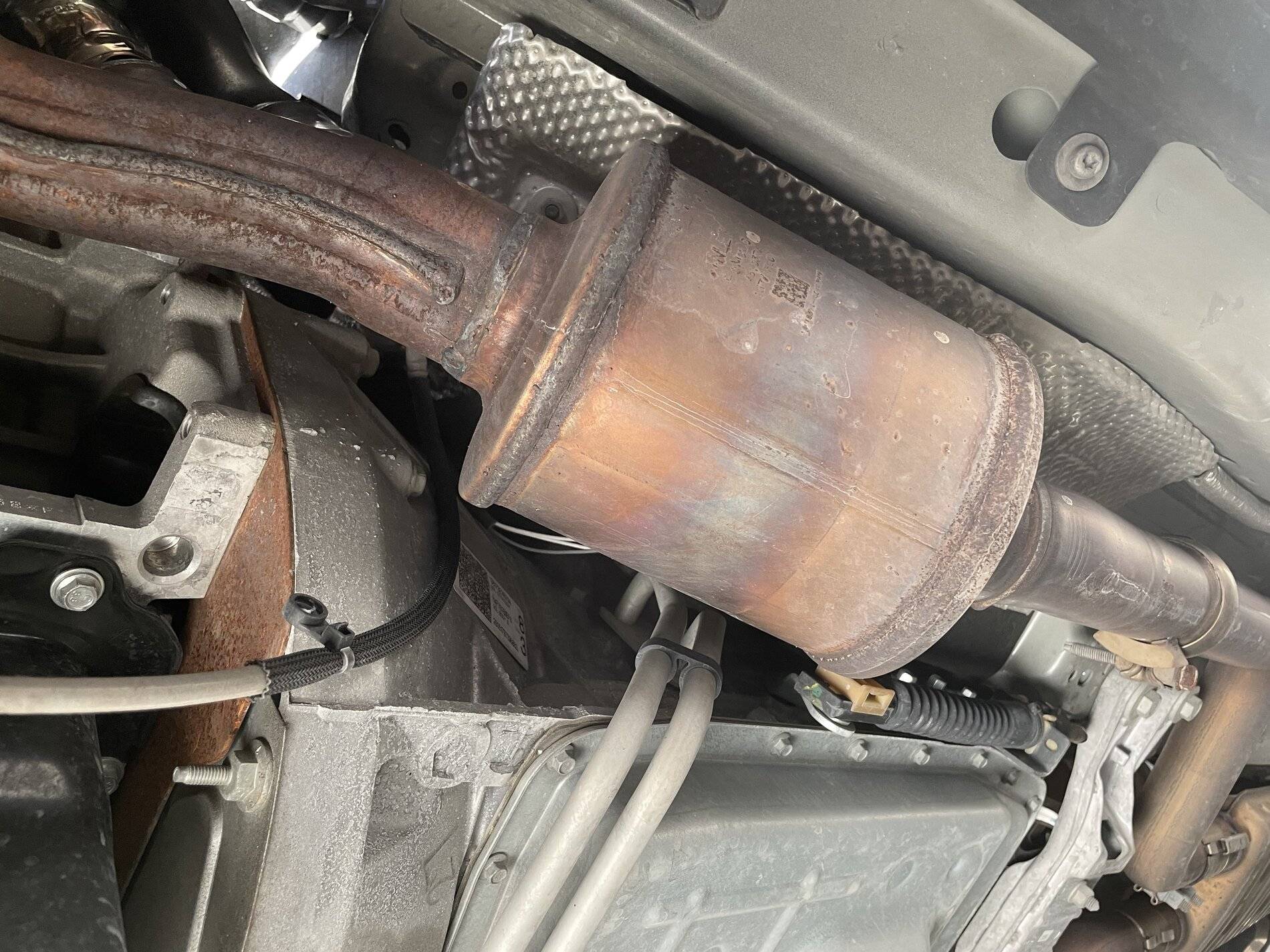

This is how my cats looks like at the mo

So what are your thoughts on my pics above? I can see where is the most heat located.
I do think that you'll have to unbolt them and inspect them from the front. I don't think that you can determine the condition of the core, just by looking at heat patterns on the body.

Not if they are factory OEM.
My cats are oem because the headers and mid pipe are my last upgrade on this car in the future, but I guess I’ll pass on that upgrades. Honestly, all I do is 0-80 mph or 20-80 mph and nothing else. So I guess I’m not really beating up on my car.
