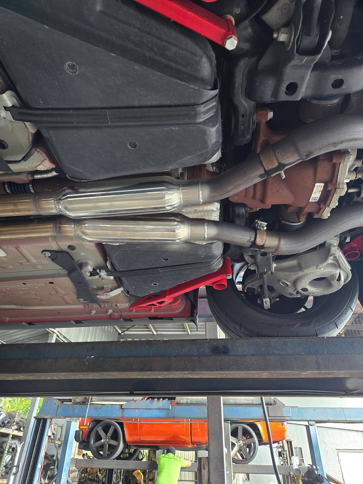

Along the subject, my shop custom made the 3" Cat delete for my setup which I see it's customary in the "Cat delete" scene. My question is, should there be any modifications done additionally or a custom H pipe 3" to match? I currently have the Steeda H PIPE which is not 3" does this matter.
A customer at the time of install made a comment about my exhaust from factory headers to catback was a "Bottle Neck" setup?
any insight on this?
Are you still using the stock resonator? If so, it has a 2.25" factory connection at the front and I believe necks down to 2" at the rear for a short section before going back to 2.5".

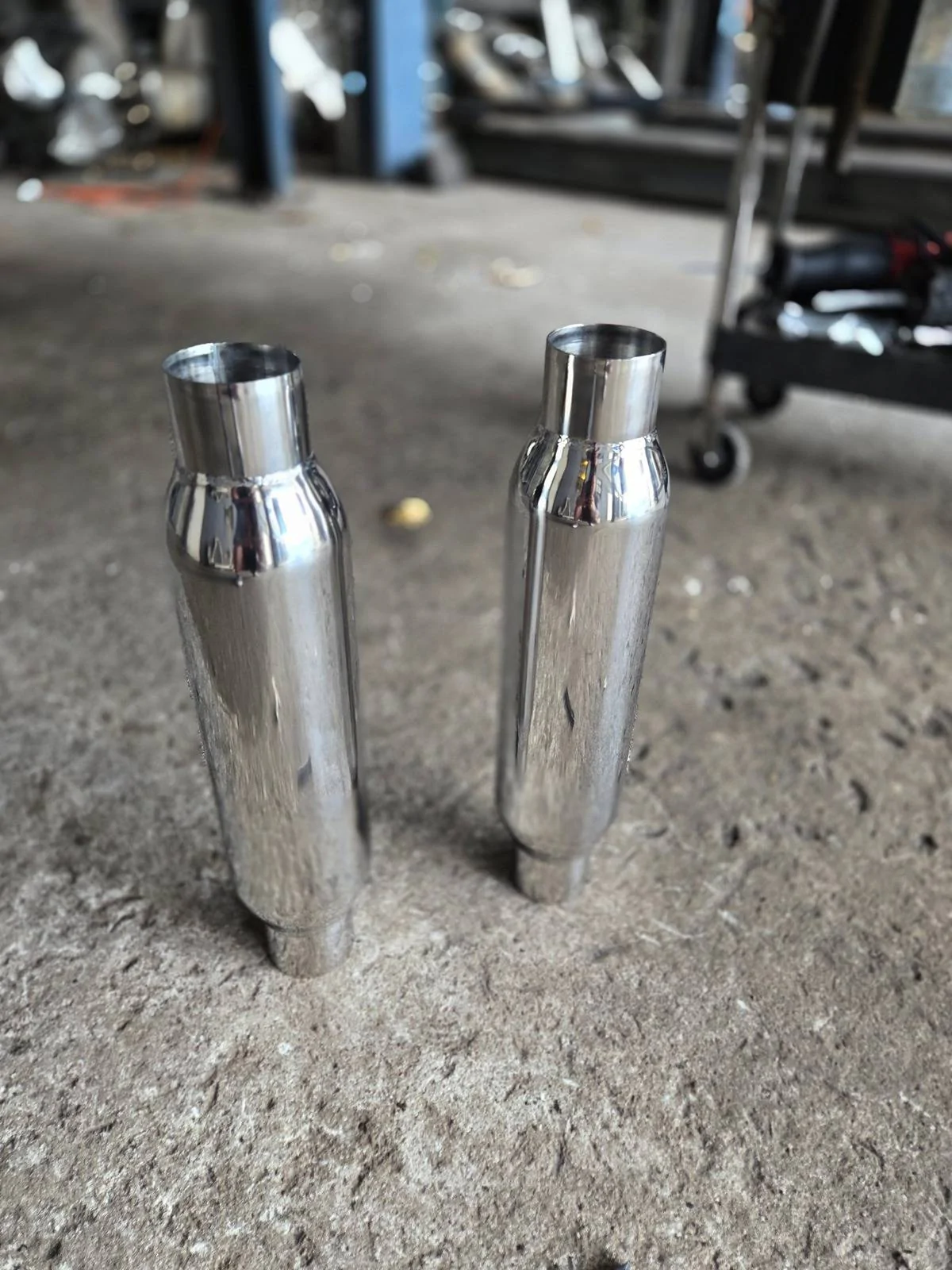

No Stock resonator, added the Steeda H. (Today I am adding the 2 vibrant resonators to refine the sound. I understand that has nothing to do with performance 😅) I'd hate to come this far and ultimately sacrifice the very thing we are all after - (PERFORMANCE) 🫣

It's going down guys. Vibrant resonators are in the works.

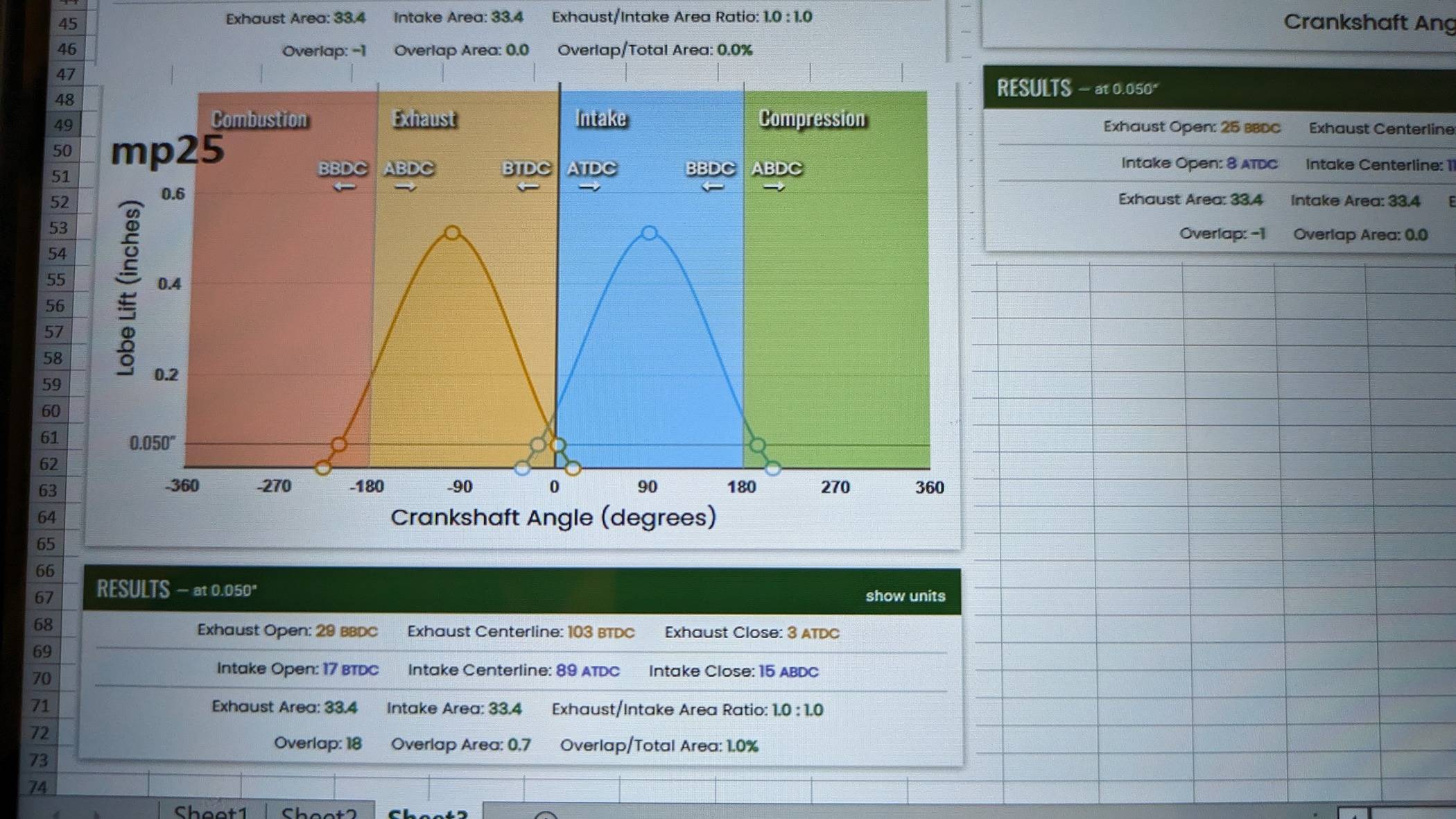

What ivo/evc did you see this at for blow through if youd share? Boosted usually runs from -20ivo to 0 ivo and 15 evc. Some tunes run near stock ivo retard though into 15ivo north of 6krpm.
Id need to double check I plugged things in correct but gen2 cam producing this at -20/20. Most significant overlap by far.
This is an interesting subject that I’ve spent a ton of time working through.
At wot it's generally accepted that EVC of 15 works well. It's not very influential to power output. There might be a little bit of power way up top by advancing to 5-10 at 7500 rpm. So, the focus is on the intake cam timing.
Virtually all modern Coyote tunes advance the intake cam to -20 in the lower/mid rpm, which generally traps more charge in the cylinder before dynamic effects come into play at higher rpm. Usually around 5000 rpm is when the dynamics start to matter and that rpm range is when the intake cam is in the middle of retarding.
In setups where intake runner dynamics can affect airflow (NA, centrif, turbo), the intake cam retards a lot, all the way to 15 to as much as 25 IVO.
In PD blown setups, the blower size, speed, and inlet pressure dictate the airflow, so the air dynamic effects in the port can't affect airflow. It becomes a game of efficiency and knock (if on pump gas). In general, advancing the intake cam has less tendency to knock, but retarding it helps reduce pumping losses which improves efficiency. And by efficiency, I mean producing more power from the same airflow. Why it reduces knock by advancing the intake cam is up for discussion, but I think it has to do with purging hot gases from the cylinder during overlap. The Roush stock calibration only advances the intake cams from -20 to -12.5 and they run it much more advance up top than anyone else. Is this due to them wanting to maximize performance on 91 octane? Maybe. Most others such as Whipple and major tuners retard the intake cam to around 0, +/-5. Note that this is still a lot more WOT overlap than stock.
So back to the original question....I had optimized cam timing for 93 octane so it was somewhere between -5 and 0 IVO, and 10-15 EVC. I was hesitant to retard the intake cam much beyond that due to the amount of time I spent arriving at those numbers to begin with. For sure, more retard would have reduced overlap and, thus, blowthrough, but would borderline timing have been reduced as a result? And would the trade-off net more power? I don't know. To be honest, this happened on the dyno and it took me probably a week to analyze the data and figure out what happened...plus the cats are back on the car so I don't think blowthrough is currently an issue.
By the way, blowthrough logic is active on ecoboost and the Roush supercharger kits, but not GT or even GT500.

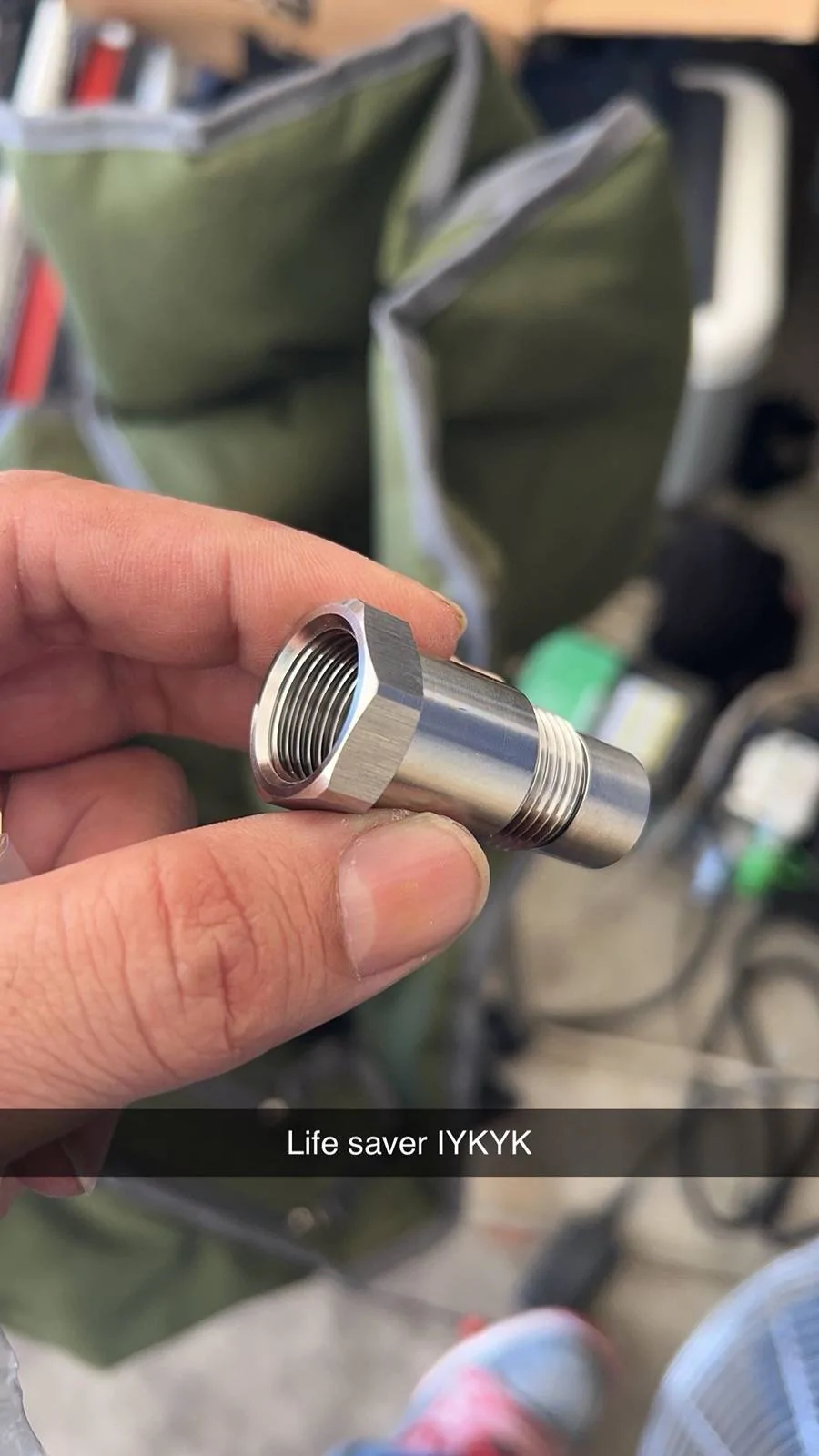

I’ve been cat less and the CEL never turned off. I had the spacers too and it didn’t help. I have high flow cats right now and they still haven’t turned off. I think you have to get a tune to turn them off.
Have a bad cat and those worked for me
