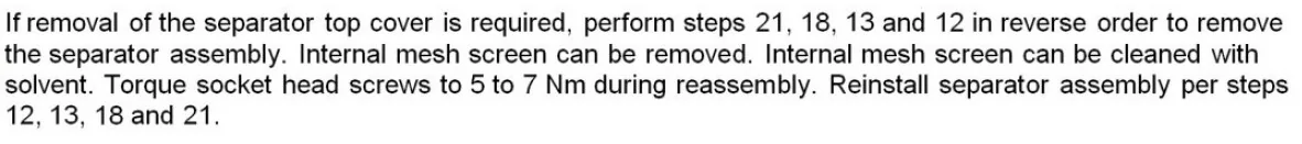

I only asked because it is rather self explanatory as to how it works. You could service it if you felt you had to but you would have to remove it from the bracket and place it on a table for disassembly or you could remove the STB which would give you access to the top cover bolts on the separator. However, with the drain in place there is really no reason to have to take it apart.

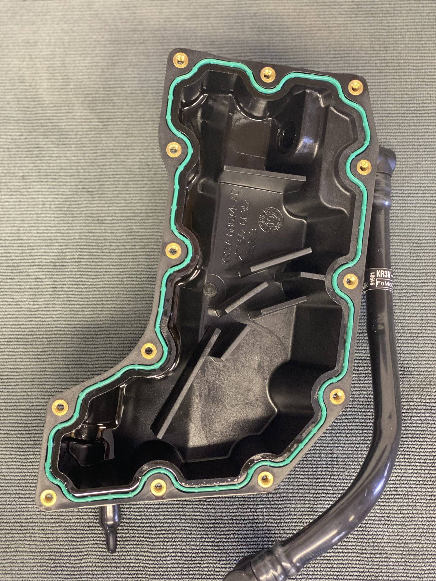

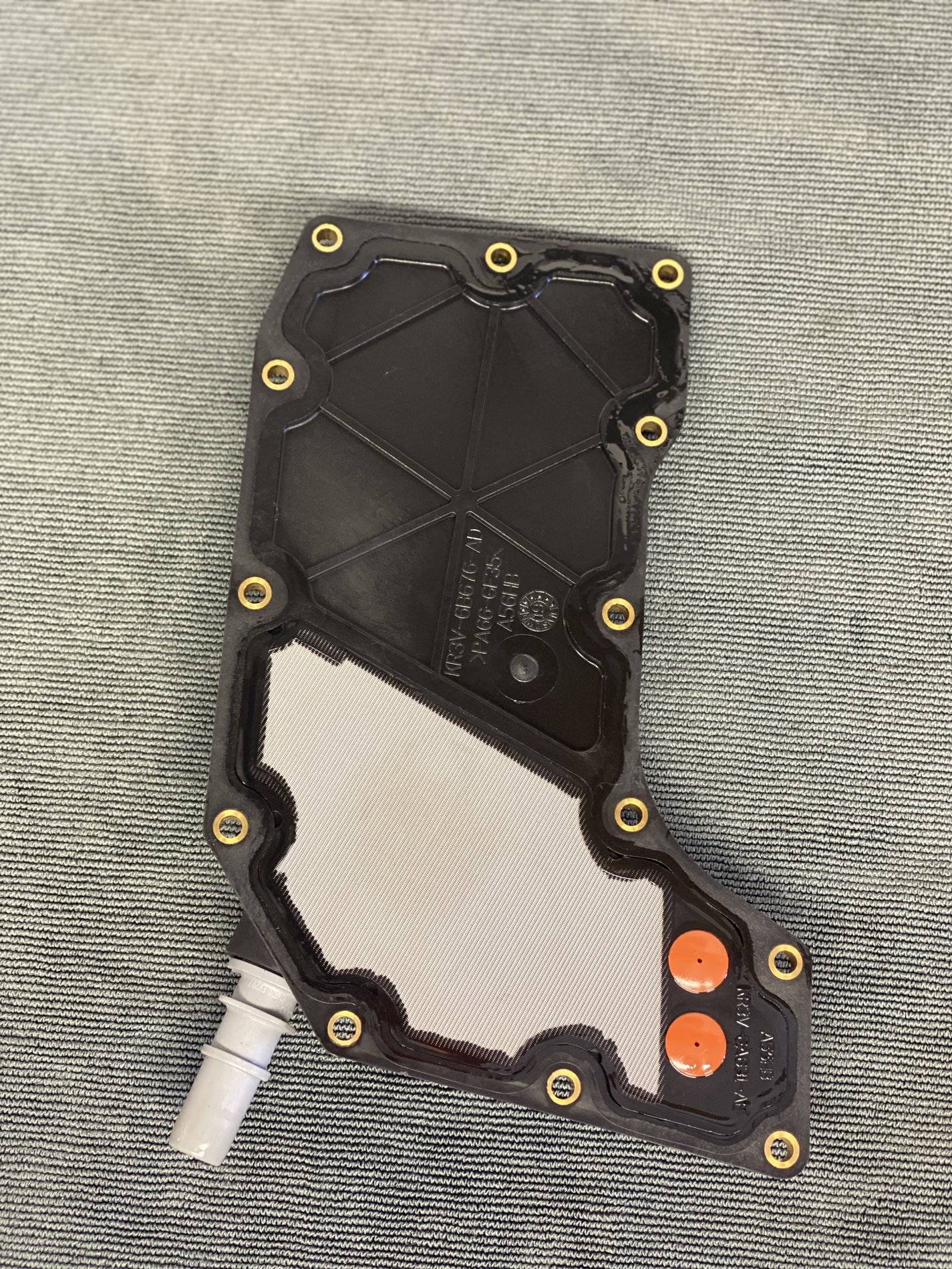

I was bored today, so I decided to peek into the optional, factory designed & built, oil catch can. My car only has 700 miles on it, and as you can see in these pictures, it is already catching oil.
Also, the oil mist is being captured and returned to its original form before it drips back into the cam cover. This satisfies my theory that this being designed by Ford engineers means the catch will work properly, and return OIL to the engine, not the frothy crap substance that most aftermarket cans produce. I am very happy to see this.

Also, the oil mist is being captured and returned to its original form before it drips back into the cam cover. This satisfies my theory that this being designed by Ford engineers means the catch will work properly, and return OIL to the engine, not the frothy crap substance that aftermarket cans produce. I am very happy to see this.

I haven't used Bob's can, but I have used JLT, UPR, Moroso, and Misimoto. All of them produced frothy crap, I can only assume due to the style of their cans. I mention this only because some people were hesitant to return the collected fluid back to the engine, because of how ugly the froth from other cans looks.

That would certainly explain some of the peoples reluctance to embracing the new style catch can from Ford.
