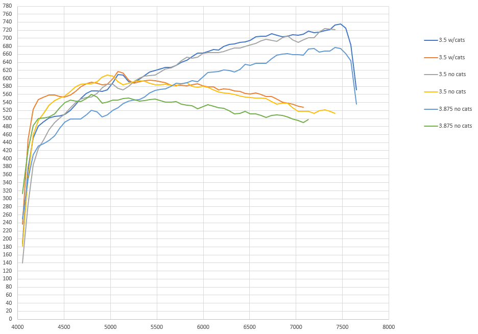

Just to confuse everyone more, I had my car on the dyno a while back with 3” cat deletes commanding .78 lambda. I swapped in a pair of gt500 cats on the dyno, richened it up a bit to control exhaust temp, and made another pull. To our surprise, it gained about 15 hp with cats. We thought it was a fluke so did another pull and it repeated. After reviewing the log, the fuel flow didn’t really change (neither did the airflow, but that’s another topic) due to either blow-through effects or FAOSC, so this more-or-less isolated the exhaust dynamics as the reason for the change in power.
It would be fun to see some CFD models of the header to mid connect using stock cat, GT500 cat, No cat.
I’ve always been curious to see what is actually happening to exhaust flow pre and post cat.

I have CFD software but you’re talking about a few days to a few weeks of modeling.
