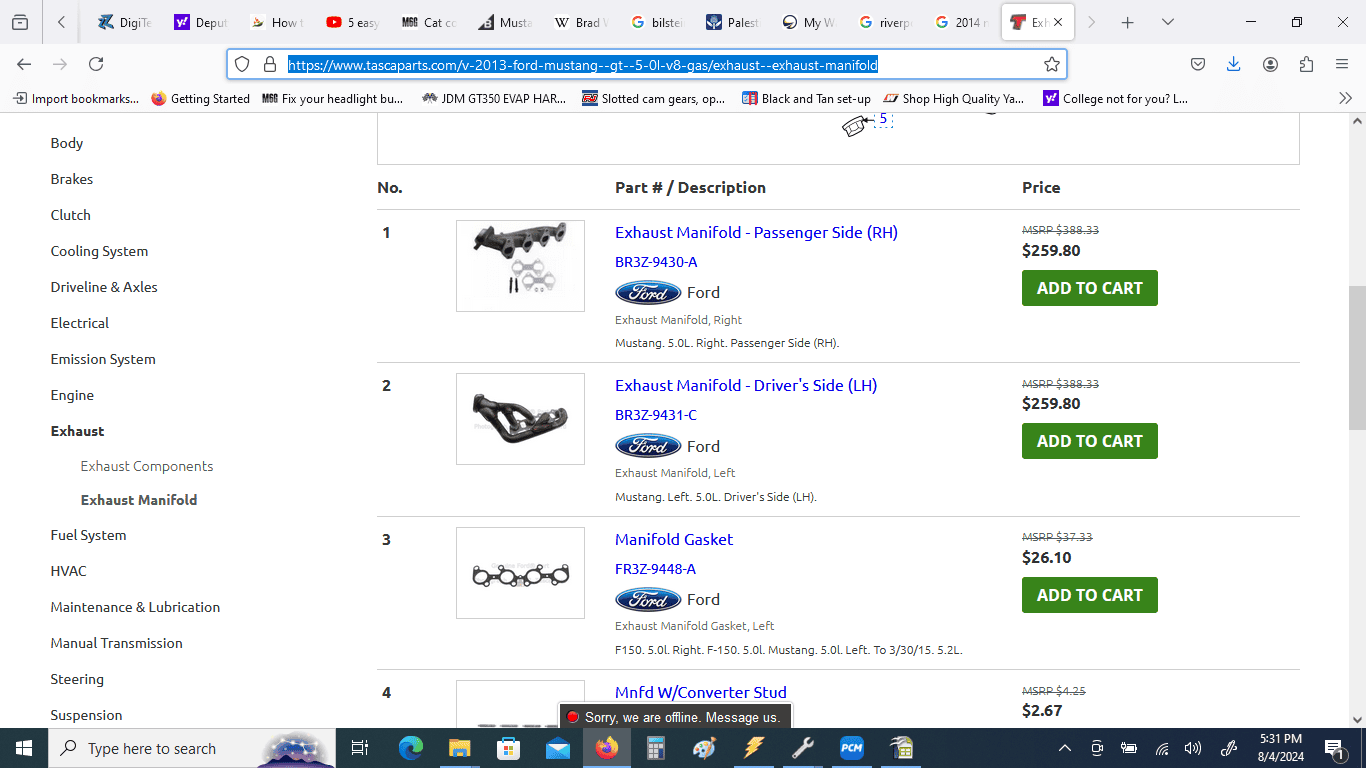

The easiest way is to get a gen1 driver side header. They have a flange. Then all you need to do is have a shop cut off the flange on the MAK pipe and re-clock it for the new manifold.
Welding the flange to the original header really needs to be done off the car by a real welding shop. Stainless will eventually crack if not welded properly.
I have a guy that will tig it with stainless filler. It's not to tough to weld it inside the flange
I looked at Tasca Ford. All of the years show the cat welded to the header. And they are 900 dollars. I have a guy that can tig the flange on the car with stainless Filler wire.

That's for a 2013.
