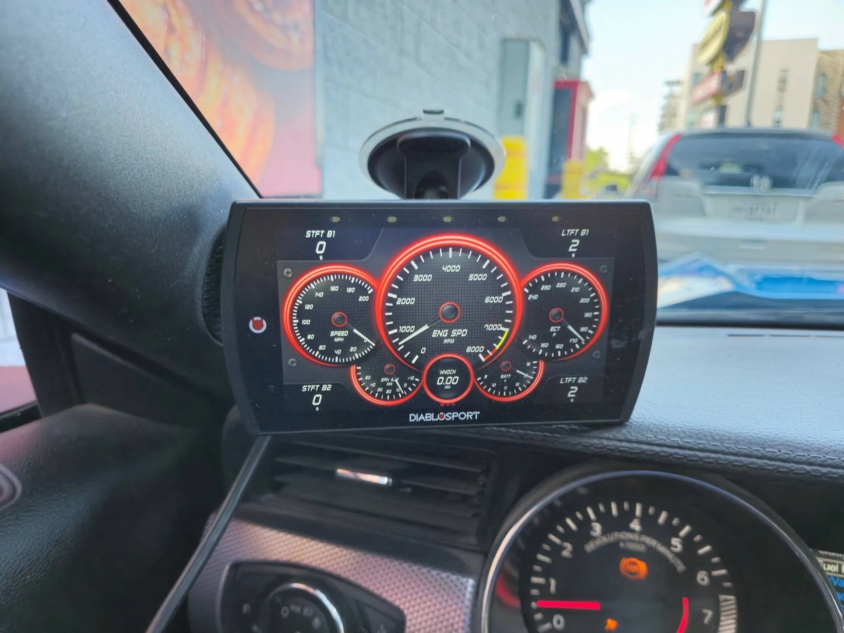

One problem with gutting cats is that it throws off some fueling functions as well, at worst, and at best you’ll never get a ready status on emissions.
Care to be specific on which fueling functions ?
My meows are gutted.
Ready status all good with the exception of the rear o2's.
Everything trims out nicely. LTFT have been at 2% on 91 forever.

The narrow band (rear) o2 sensors are more accurate than widebands, over a smaller range. Ford logic uses the rear o2 signal to calibrate the fronts and then you have the best of both. It’s called FAOSC. The problem is that in the process of converting exhaust polutants in the cat, the rear o2 signal has offset error as well, so the calibration and logic account for it. When you gut the cat and a p0420/430 is set, it stops doing FAOSC because it knows it is inaccurate. Installing spacers or defoulers will stabilize the signal so it won’t set a code, but the logic will proceed to apply the now-inaccurate FAOSC correction. We’ve tested this and found a 10% error as a result, with the engine running richer than the widebands were reporting.
On the flip side, if you disable the FAOSC and run spacers, then you’ll never achieve an emissions ready status and your front o2’s don’t get the benefit of the FAOSC calibration. Locally, you can’t get an inspection sticker if they plug in and the cat test gives a not ready status.
Right. And in real world applications not having the narrowband amounts to, from everything I've read, basically nothing when it come to performance or reliability.
IF it did, then FORD would most definitely have the CEL triggered / power reduction mode like a lot of other manufactures do, no ?
