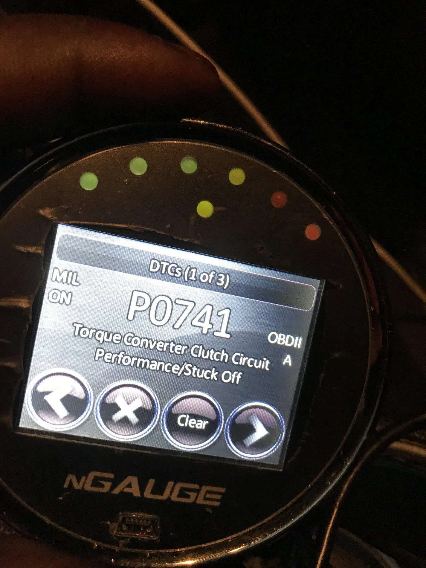

It is sitting on 305/45R17 ET street R's lol! The converter lock up issue has been an on going thing throwing P0741 a few times a day. Converter doesn't even lock up during normal driving!

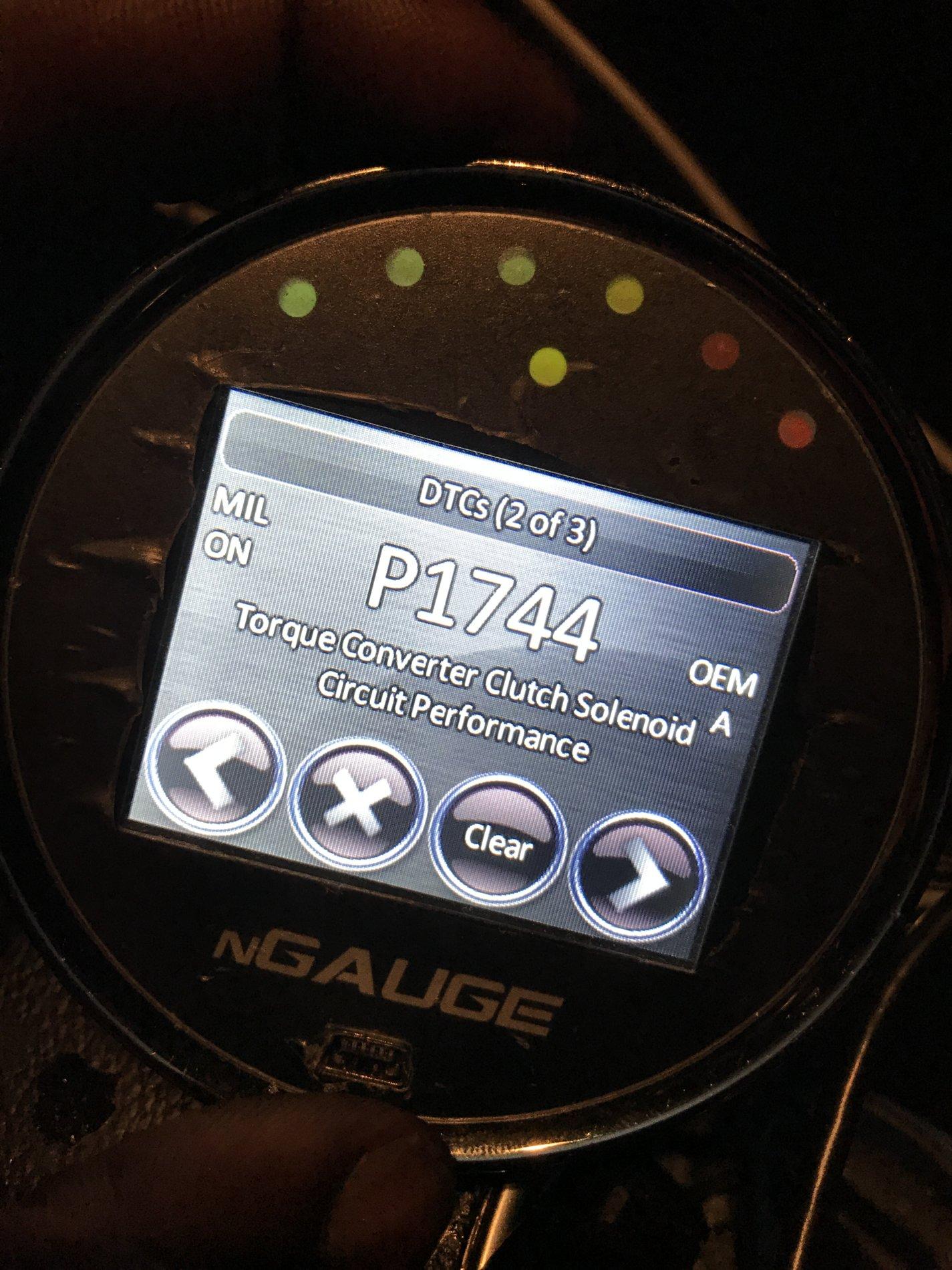

I know this is 3 years old but got same code after only 5th pass on newly installed 10r80 converter
Just limped car home 70 miles and
I think I broke something in converter.
Codes are TCC codes .
Waited a couple of hours to make a pass hoping for decent air .
Normal burn out and car uncharacteristically spun real bad and I aborted the pass .
On return got a wrench light .
Backing up to pit noticed left back tire was leaking air and almost flat .
Thankfully I got some help and was able to plug the tire .
Car jerks in every gear but was able to limp it home leaving it 6th (drove best intangible gear and was not shifting but was was going 59 mph ).
Hoping I did not damage the transmission anymore by driving it but could not get a tow when I tried(at least for 3 hours )
I am so sick and tired ......This is the final straw .
I think my drag racing days are over.

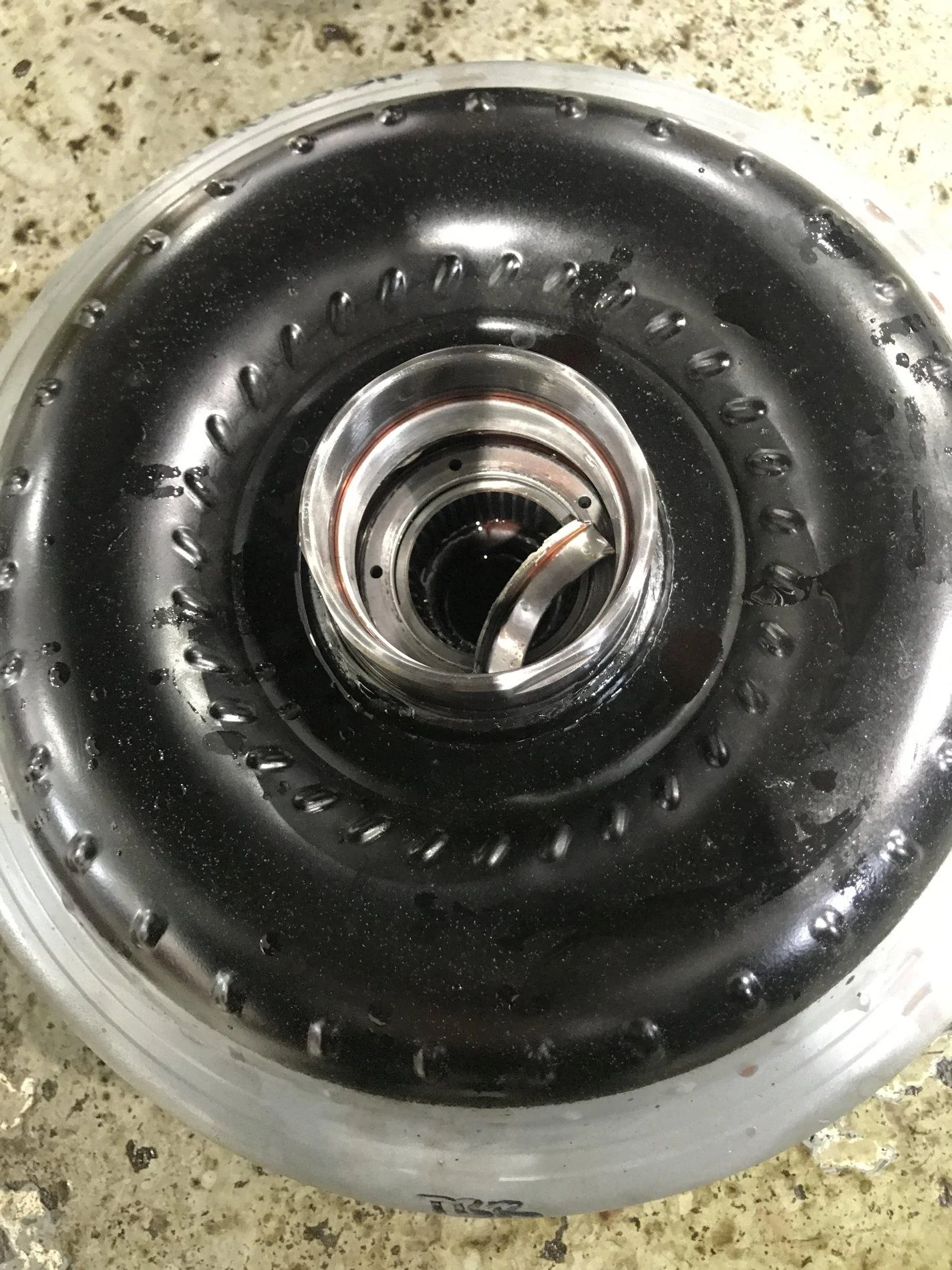

Sounds like there is something wrong, maybe a bad converter from circle d.
Yup . Just hoping thats all . Swapped back stock converter and replaced valve body . I have not driven it yet as want to make sure lines are flushed real good .
