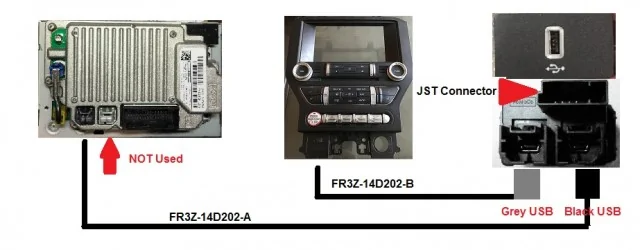

In the base cars that grey USB plug on the back of the APIM is used to power the front USB port for charging only. The premium cars don't use that plug(Jim pictured above) as the front USB plug comes from the powered USB hub from the center console. I wonder if they used a base car USB port from the back of the APIM to the front USB port and that's why it's power only now as it isn't powered from the console hub anymore.
I'm guessing this because my base 2018 has a sync swap from a 2017 and it still has the base USB cables installed and is wired like a base car. My front USB port is charging only(wired to grey port in back of APIM) and the console hub does my apple car play with a powered hub.
Just a guess and good luck.

I just pulled the armrest hub. The cables are port-specific, and keyed to the correct port. I did notice that both cables are still covered in the factory wrap. If they replaced just the front port console cable, do you think the tech would have bothered re-wrappedIng the cables together? I hate to be so suspicious, but if they really did replace all these parts, something doesn’t make sense.
Mulestang
Oct 26, 2015
191
Jacksonville, FL
2015 Mustang
As much as I hate to have to do it, I guess I’ll disassemble the bezel/front panel to access the APIM and check. However, with the APIM ports being keyed, I don’t think it’s possible to plug my black premium harness into the grey port on the APIM.
I see what you're saying. I meant they used the grey cable from a base and plugged it into the APIM(grey port) as your "replacement front cable" but it's just a guess though. I can't see a tech removing the bezel and forgetting what cable to reinstall but crazier things have happened. You'll know right away if you take it apart unfortunately. Interested to know what USB cable they replaced if it's a factory wrap on a console hub...
Exactly! Both cables are sourced separately. I can’t find a part number for both cables wrapped together as a harness assembly. If they replaced just one cable, would they have gone through the trouble of unwrapping and re-wrapping? It still looks OEM.
