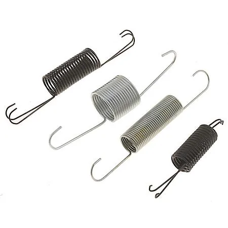

No adjustment,
But if you are feeling daring, open up the pedal box and fiddle with the return spring.
Or..........
get a set of these and drill a hole in the pedal arm. Adjust as needed.
