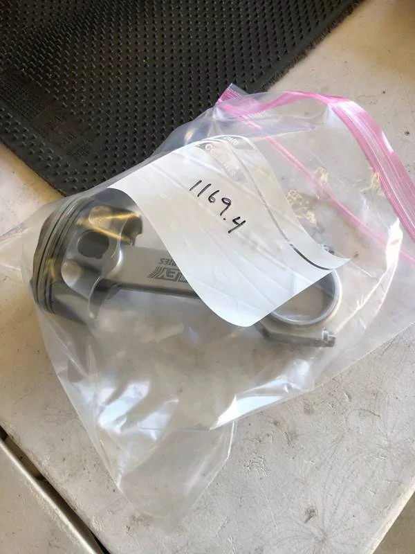

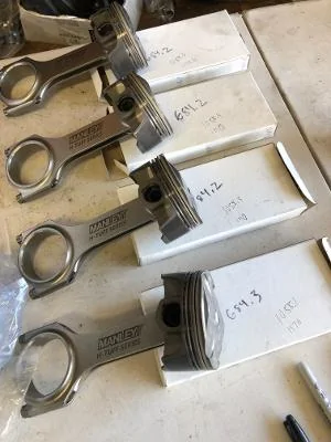

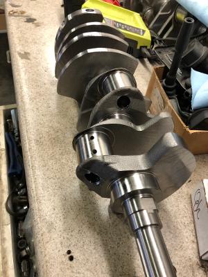

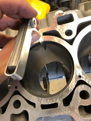

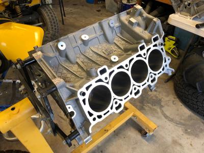

Yep, Mr Dipshit is in the middle of an engine build right now in his garage....... and will not be "upgrading" cams.
But WTF do i know? Do yourself a favor and ignore everything i say.
