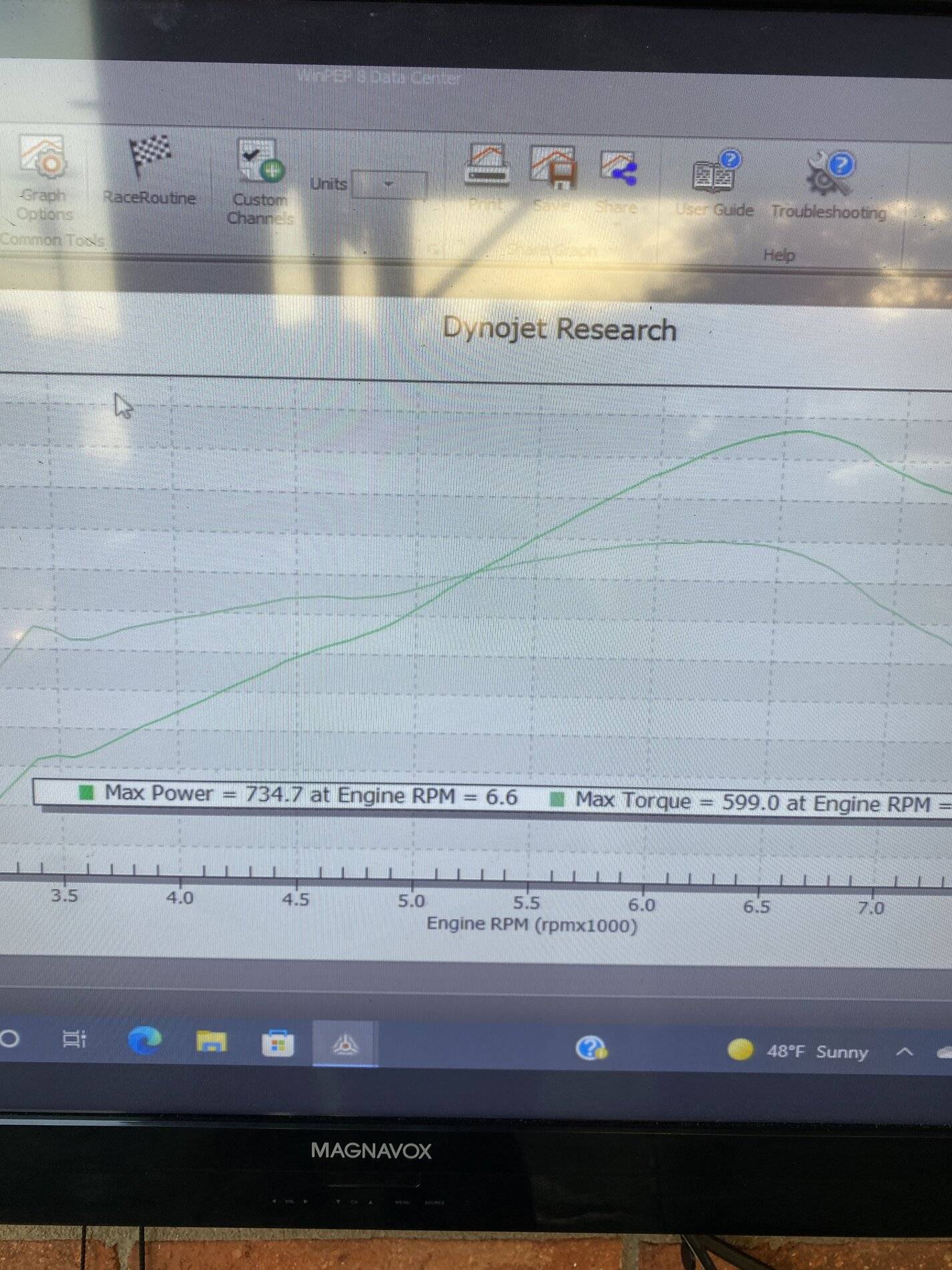

I recently purchased my 2018 mustang with a vortech supercharger on it. The car is very fast but doesn’t feel as fast as it should be. I had the car dynoed and it proved by concern. The car seems to die off after 6k and it has a major boost leak somewhere. I need help finding it if anyone has had similar issues.

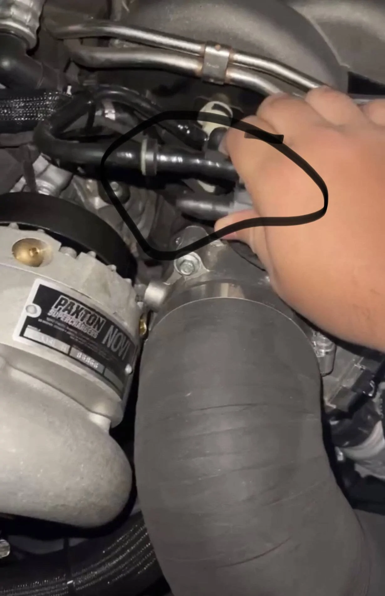

One thing I found is that my car has this open and not ran to anything while the persons pictured has his capped off and Vortech themselves have it re routed to the intake. Does anyone in here have a similar setup with no air filter that knows what to do with this?

cap it off that's a vaccum tee and is most likely the problem

The car feels much faster then it has ever felt now. Seems to be what the problem was and most likely what the previous owner couldn’t figure out
