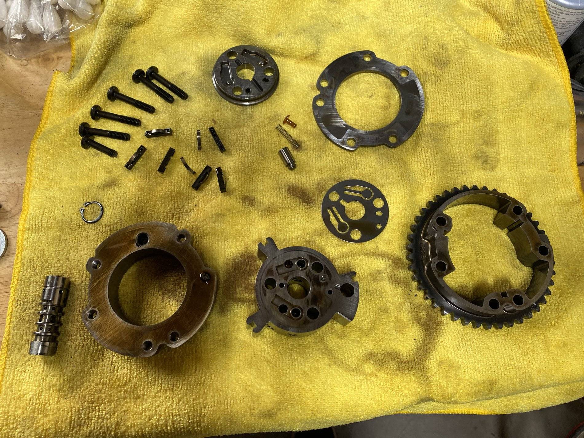

Anyone experience a bad camshaft phaser on a 2015-2017 GT?

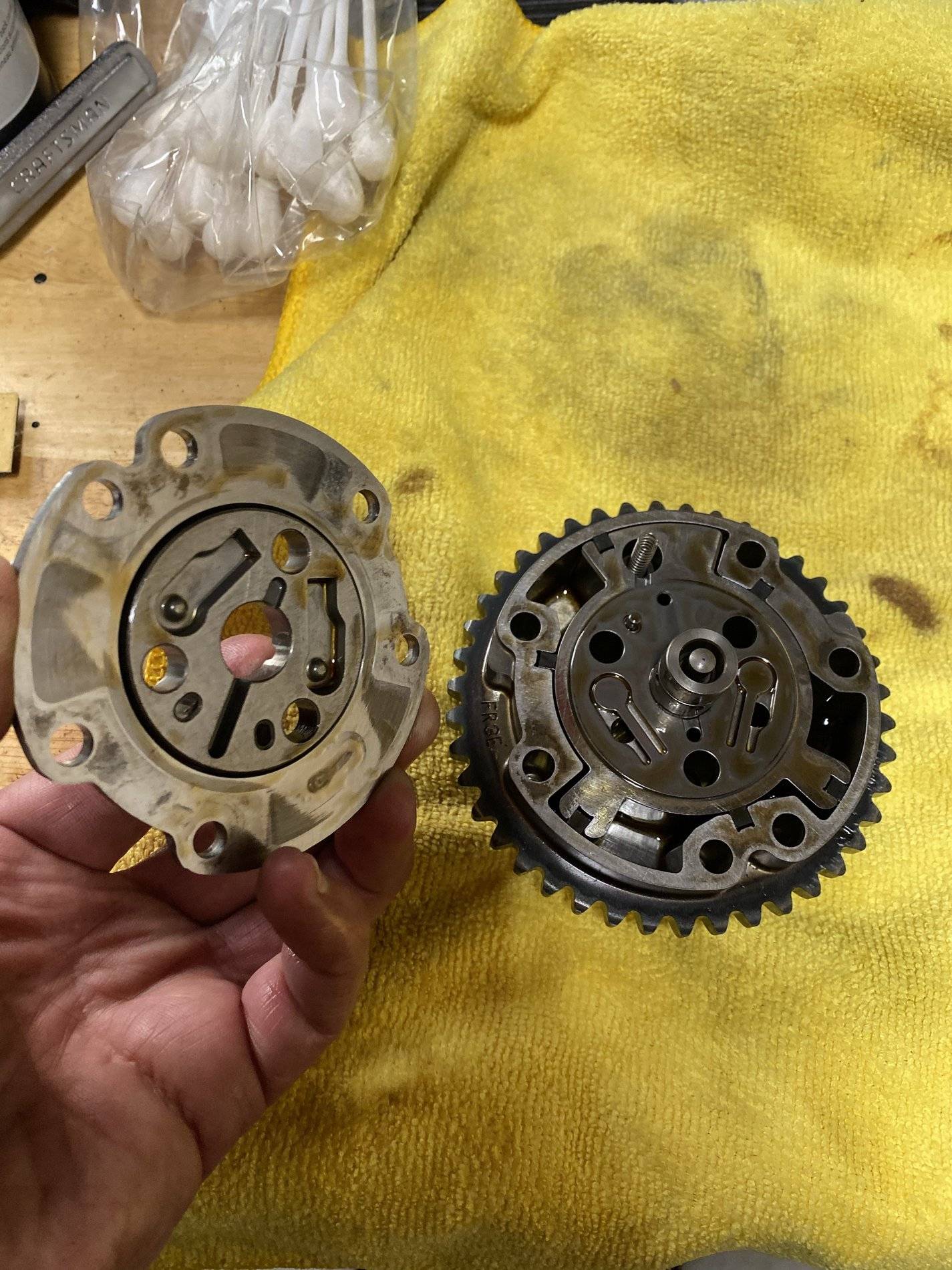

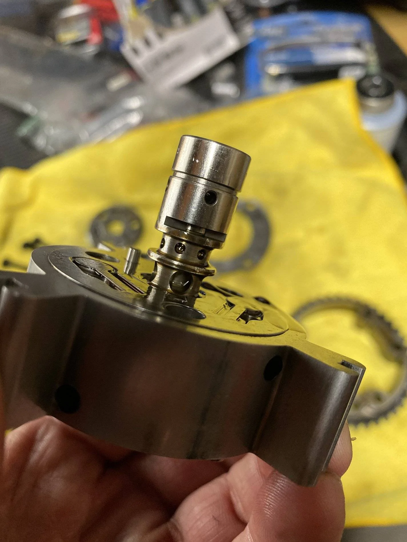

I’ve replaced one for someone else. Their right side exhaust phaser was stuck open giving him a code. The pin that gets pushed in from the solenoid would not compress. Tried dissecting it to see if I could find the problem but couldn’t get into the valve system without cutting it open. Installed a new one and issue resolved.

Thanks for the reply. How did the car run with the bad phaser?

It would start fine and be driveable but I think he noticed power loss since the cam couldn’t advance/retard properly. I never drove it beforehand. I believe the code he had referred to the cam being stuck in an over advanced position.
