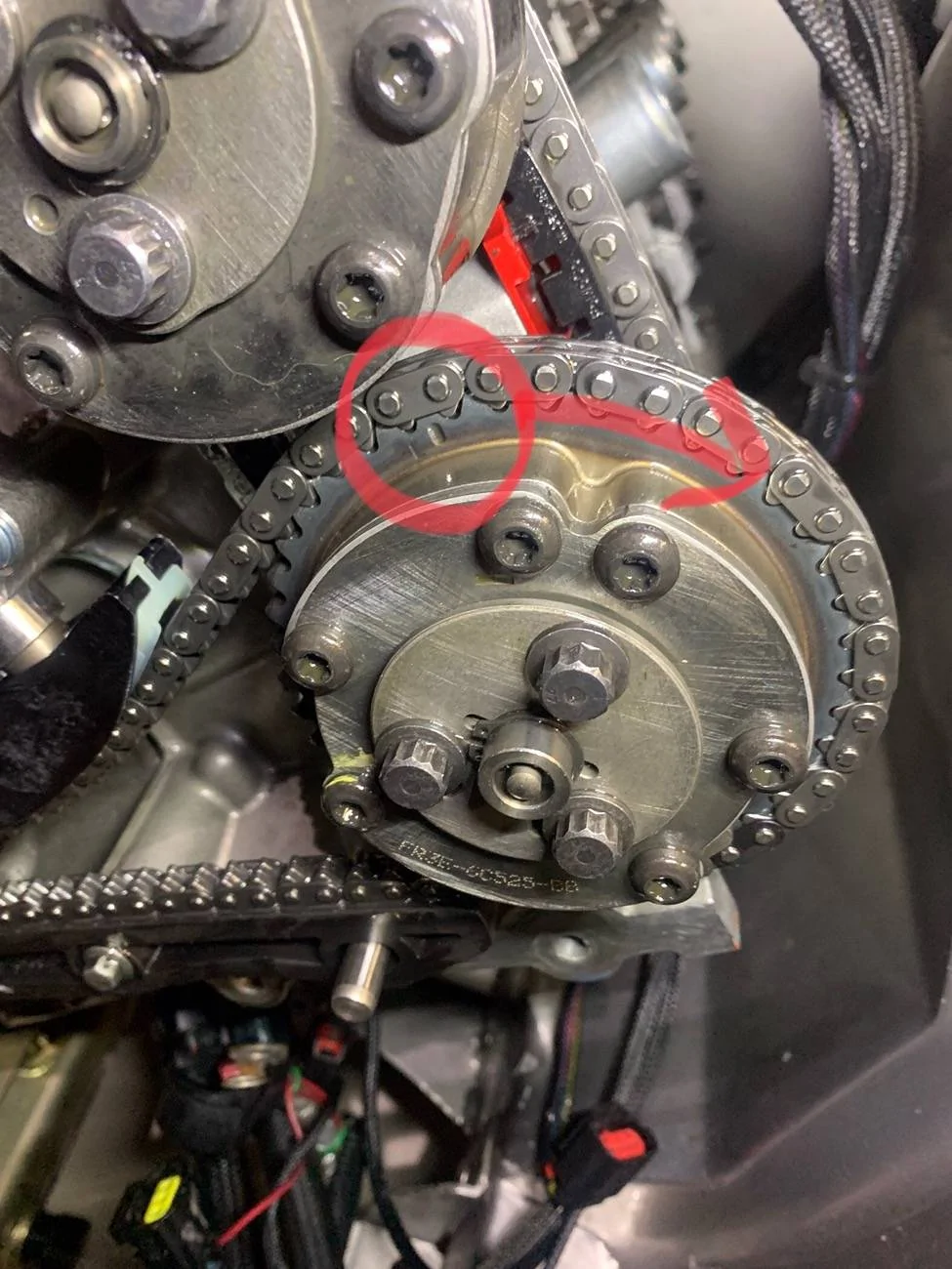

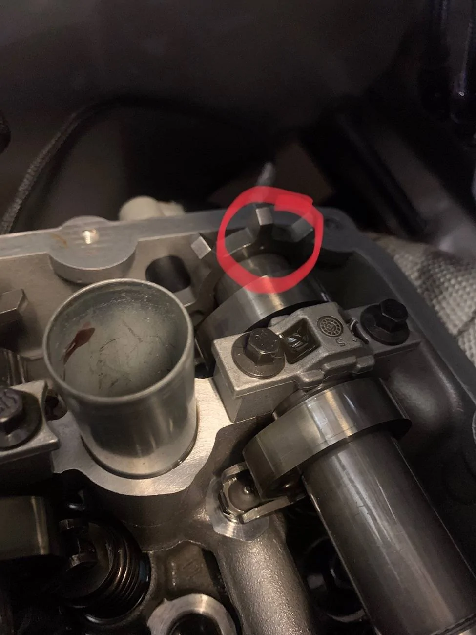

Hi , I need someone that may have a left side( drivers USA) exhaust camshaft handy, need to find the positioning of the trigger wheel at the back. Easiest would be from the dot that’s on the wheel to where it would correspond to the L on the phaser. Mine is about nine teeth clockwise. Or if some one knows where I can find the info. Engine was in a wreck and the rocker cover was damaged and I want to make sure it hasn’t moved. I am getting po390and po394 codes and I’m out of things to try
Thanks in advance
