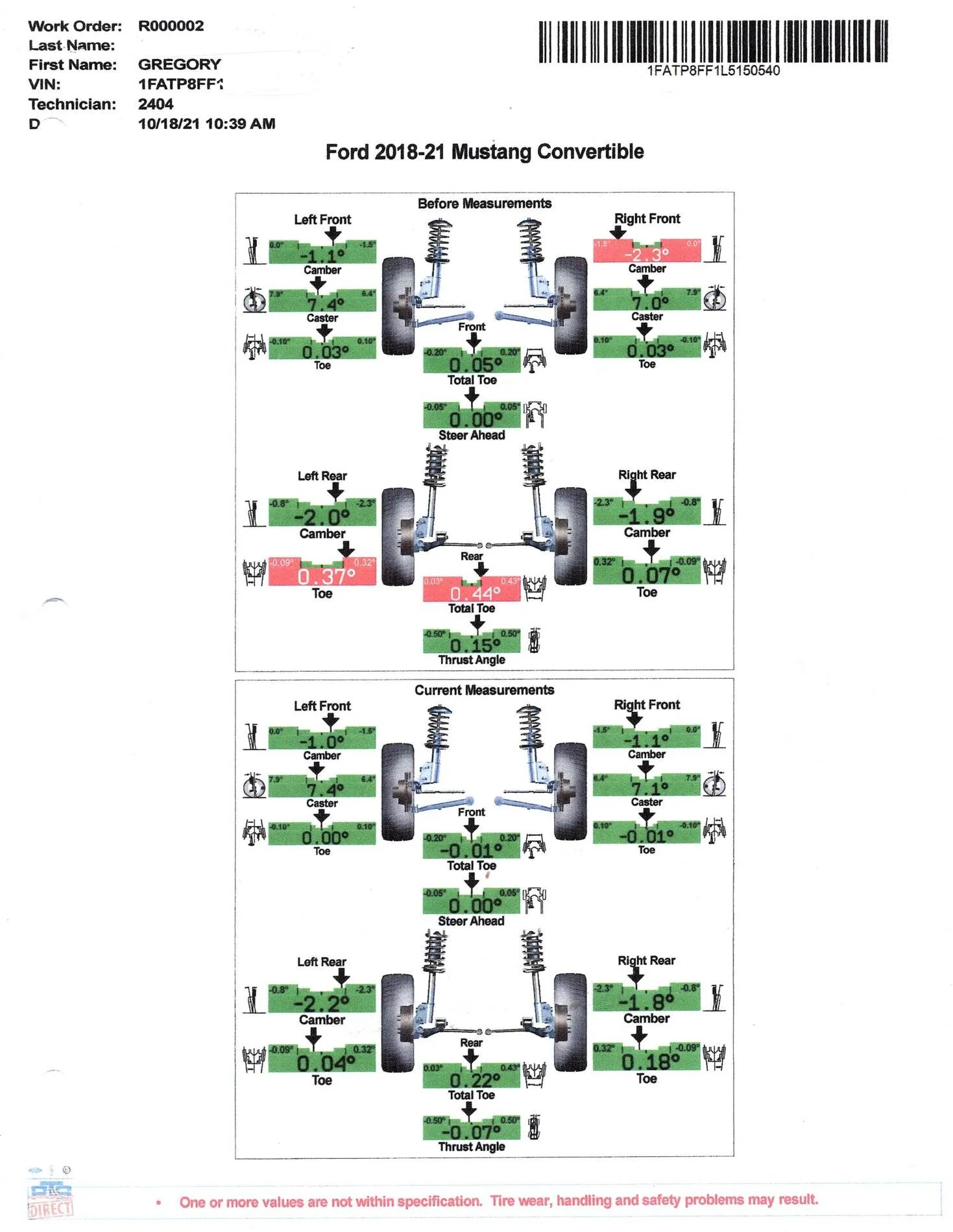

I got a deal I couldn't refuse on a set of Maximum Motorsports Caster/Camber Plates. Got them installed last week and got the wheel alignment done today. Done.

Why so much negative rear camber and not front? I would’ve gone -1.5 all around for a street setup. Or -1.5-2.0 front and -1.5 rear.
Supposedly my -2.7 in the front isn’t even that bad on tire wear (mainly track).

Why the fairly substantial left/right difference in rear toe as well? I would get that evened out.
Agree with @TundraOnKings on the camber. If you want the car to turn in better, you should always have more front camber than rear.
