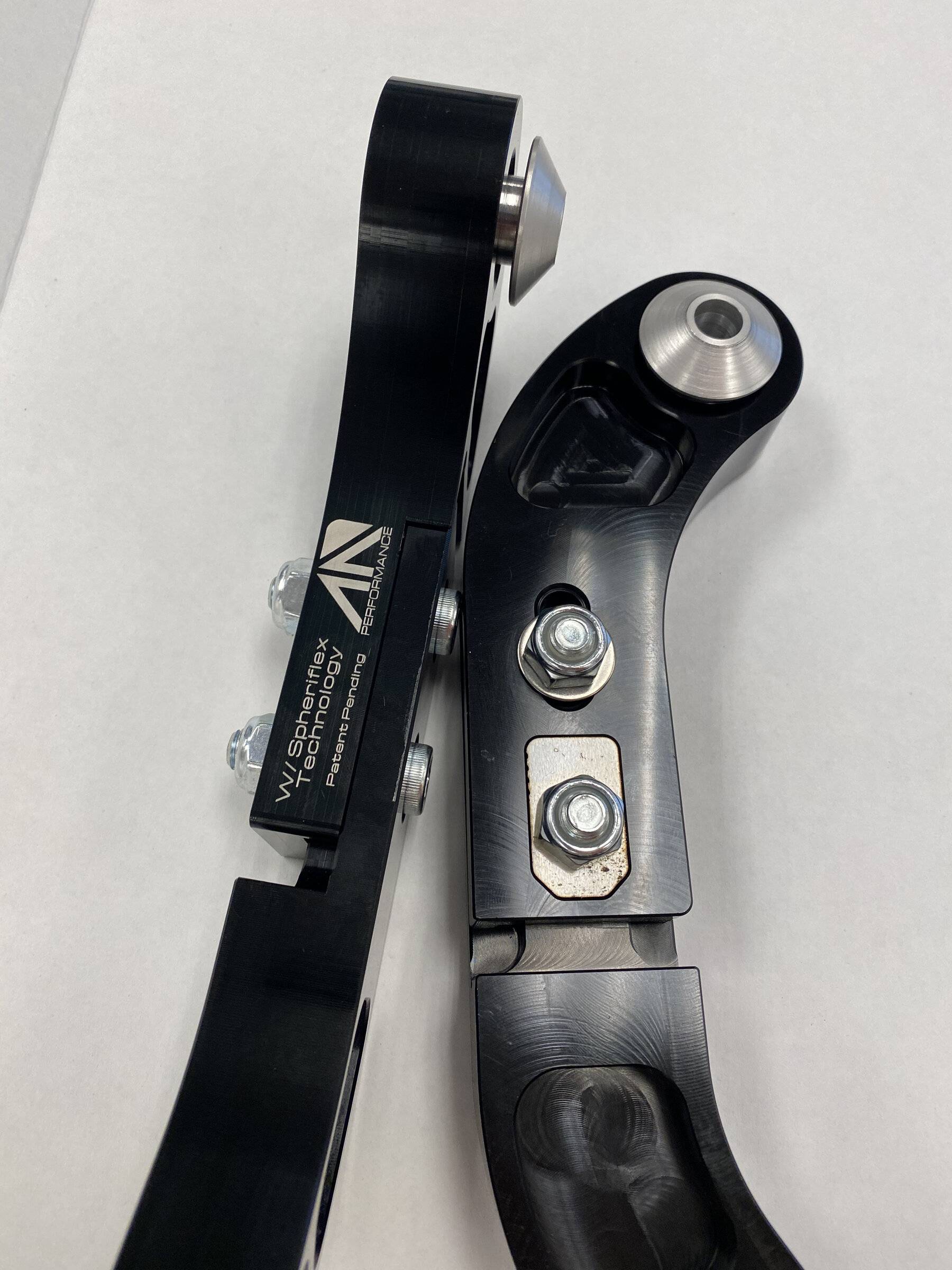

Our camber arm and toe links lock the factory adjustment slots, and use an integrated tab system in the arm to make adjustments, no threaded rod and jam nuts. Ours have no chance of static alignment shift once locked, and offer the ability to quickly swap back and forth from race to street alignment, repeatably https://aadperformance.com/collections/mustang
The tombstone shaped tab seen in the arm, interfaces with a slotted hole; so different tabs have the bolt hole in different locations along the length of the tab. This allows for precise alignment and repeatable alignment changes.

As for the sliding, the stainless steel tabs are recessed into the aluminum arm, You’d tear the mounting ears out of the cradle before you’d get the tab to push through the aluminum in compression. The two high strength bolts are loaded in shear, while the arms use a tongue and grove system to eliminate other forces acting on the bolts.
We test all our products in FEA software with a large safety factor to ensure our products can handle anything.
We also use this system on all our charger/challenger products which see substantially higher forces due to their suspension design and weight of the vehicle. 7sec 4200lb fastest redeye in the world couldn’t break our parts.
There are no grease fittings on the part for good reason, contrary to many products out there. You don’t want the bushing to rotate in the arm, you want the metal sleeve inside the bushing to rotate within the bushing. So adding a grease fitting would be a detriment to the design. We pre grease the bushing bores upon assembly and include a packet of grease with each order that has these bushings.
Our adjustment in our CAMBER arms is rather fine, we can go plus or minus 9mm in arm length, which is a good range but excludes the extremes of negative and positive. To solve this we developed an offset lockout that can be flipped based on your desired camber out come. So you are either locked outboard(closer to zero and can get positive) or locking inboard(can get -3.5* to 0*)
So we can hit -3.5* to +1* camber, and our toe we can really go anywhere with.

The lock out design has a small amount of play to account for variations in the cradle, the mounting points for the camber arm are stamped out of steel and welded, there are tolerances to this. If we designed it to match perfect with the factory cad models, it wouldn’t fit in some cars. It’s just the nature of manufacturing. The “slight play” is about 0.007” or about a .178mm which equates to 0.026 degrees of camber based on our findings (which is well within the error of an alignment rack, so it’s a negligible number really). But once the bolt is torqued down they don’t move.
What you are setting when you set your camber is your static camber, camber changes as the suspension articulates up and down, all road going cars do, how much depends on the vehicles suspension geometry.
The cornering of a vehicle does exhibit at different load on the camber arm than that of a drag strip launch, these arms aren’t designed to do just one or the other.
When cornering, the arm on the outside will mostly see a compression load (the knuckle trying to collapse in towards the centerline of the car), and the inside will see some tension, while both see a bending moment.
These loads are much easier to deal with than the shock loading of a drag launch.
We have parameters that the designs must meet, based on suspension geometry, vehicle weight, and possible loadings. We exaggerate every scenario to the extreme, and have yet to have a control arm failure yet.
Parker (the owner of AAD) and I are both engineers, we’re not fabricators playing connect the dots with steel tube. We take the testing and development of our parts very seriously and are dedicated to producing the finest product we can.
