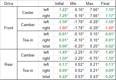

I just passed a regular annual check-up at my dealer and I asked them to check the wheel geometry as well. They found out that all the parameters were at stock values except the front right wheel, which had camber -1.8° (-1.78° was the limit). The front left wheel had -1.58° (so apparently set up for track).
The value for the front right is not that far from the limit, but what was worse, they claimed that this could not be corrected and speculated that either the bearing housing or the suspension was damaged (or both) and suggested a replacement. Since I had the front right shot and repaired last year, it looked like some unfinished business, though the wheel was not visually damaged (or even touched).
I know that regular Mach 1 (without the adjustable camber plates), does not have a user friendly adjustment, but I would assume there still has to be means to adjust it, if only to be able to go for either street or track settings (-1.03° vs -1.5°). So I would assume even if the right wheel was somehow damaged and moved from -1.58° to -1.8° there should be some leeway to compensate (not that I would want it without understanding the cause), but since the shop said they could not do it, I assume something else has to be in play.
Does anyone know what are the limits for the camber adjustment for non-HP Mach 1, and what could cause that it is not correctable?
It’s the same as any other S550 without camber plates. There really is no adjustment either than slop in bolt holes at the top of the strut or knuckle. Your options to adjust are either camber bolts (ghetto) or camber plates. I wouldn’t be worried at all about the numbers you have unless you’re going to track the car and need more negative camber. Id leave it alone. The difference side to side is not an issue either. If it were a caster or toe difference side to side I’d be more concerned.

What were your caster numbers?
These are the numbers I got from the shop:
The user manual section (posted above) mentions different camber settings for "street" and "track" and my values would correspond to track (front, the rear is the same for both).
How am I supposed to change street vs track, from what you wrote, without camber plates is not clear to me. How is the shop to adjust the values is not clear either.
Anyway, while I agree that the margin by which it exceeds the recommended values is negligible, the reason why I asked for the geometry check was that at maximum turn to left, while driving on sharp winding road, the front right tire seems to be colliding (and screeching over) the front vent.
The shop concluded that since the wheel cannot be set correctly they would not look into this issue either. I am sceptical about the wheel setup being cause of this, it looks more like a loose vent (not properly fixed during the repair), which gets pushed onto the tire when driving a bit faster (~25 mph). At a shopping mall parking lot I cannot reproduce this.
