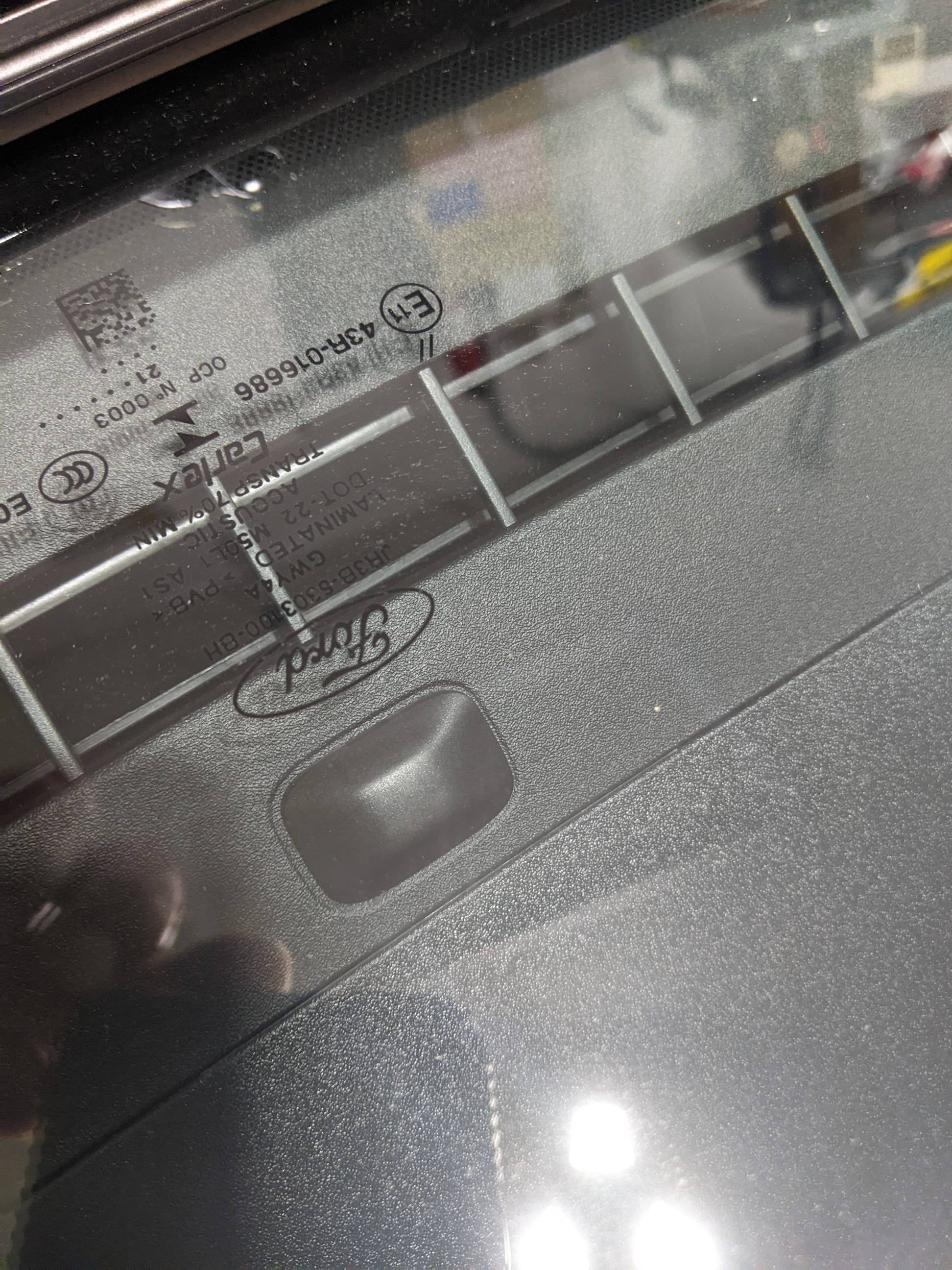

Not sure what sensor reads the light. The small eye in the upper glass or the one on the bottom close to the glass. Last gen was the lower.
I am a bit lost :). What is an "upper glass" and where is the bottom "close to the glass"?
I am only aware of the two "things" in the rear mirror mount/base. One looks like a camera, the other might be a rain sensor, or ambient light sensor or what not. But both are basically in the same place. I was wondering if there is another sensor inside the cabin, which measures the ambient light in the cabin (as the two on the windshield, cannot have a clue what is an ambient light in the cabin).

stageron
Feb 17, 2015
31
433
734
Bellmore, NY
Ronnie
2021 Mach 1 M2559, Lexus NX300
It is the lower sensor on the dash, center, right near the windshield. If you cover it during the day the dash will switch to night mode
