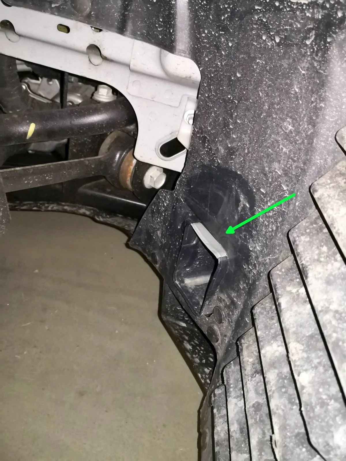

Anyway, while I agree that the margin by which it exceeds the recommended values is negligible, the reason why I asked for the geometry check was that at maximum turn to left, while driving on sharp winding road, the front right tire seems to be colliding (and screeching over) the front vent.
The shop concluded that since the wheel cannot be set correctly they would not look into this issue either. I am sceptical about the wheel setup being cause of this, it looks more like a loose vent (not properly fixed during the repair), which gets pushed onto the tire when driving a bit faster (~25 mph). At a shopping mall parking lot I cannot reproduce this.
Screeching over what front vent?
This one. I put a duct tape over the edge which I suspect to get brushed by the tire.
Well, if you look at the page from the user manual posted earlier in the thread, there are two different tables. One for Mach 1 without the handling pack and the other one for the one with HP and they have different values. I was quoting the table w/o HP (as the Euro Mach 1s are all non-HP versions). Yet, even without HP (and camber plates), Ford is apparently advising on different camber settings for street and track.
Thanks for the pic.

Do you have aftermarket wheels OR tires?
No, everything stock (for non-HP Mach 1).

The tire screeching over the vent however makes me worried about that there is still something unresolved.
If everything is stock, I'm going to hazard a bet that its not rubbing on that part. It may be, but your tape should show it definitively.
Yep. I do not have an up to date photo of the tape. The one I posted is from when I put it on :).

If it is hitting the vent, something is amiss.
