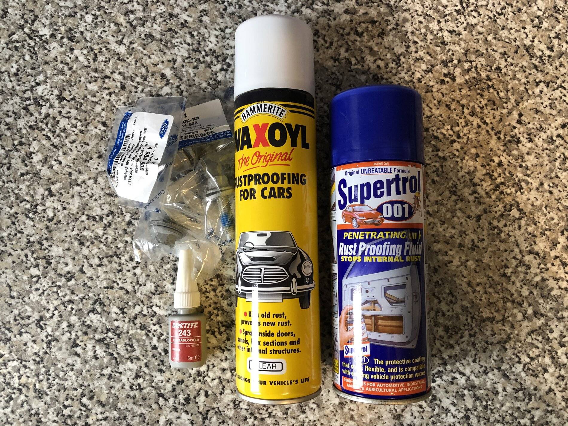

The bags in the top left contain those bolts, hopefully you can get the part number (but it might be U.K. specific ?) :
I would be a little concerned if you have broken one - they are a 10.9 grade bolt, is something else wrong elsewhere ?

I was meaning the part number on the bags might be U.K. specific, even though the part will be common across USDM and euro cars.
I’ve found out on a few occasions that Ford conveniently switch the part numbers for the U.K. market - I was just making the OP aware that the numbers on those parts bags in my photo ‘might’ be completely useless to his local parts guy :like:

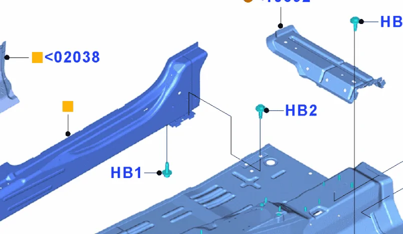

Here's what those bolts are for :
And they refit them to the holes afterwards.
Hopefully the part number from my first photo will help :like:
I think they are HB1's :
And I don't think that number is U.K. specific :like:

Do you have a better pic of the part number?
Ford has several bolts listed as HB 1

@J. Kidd
Thank you! That's what I needed
