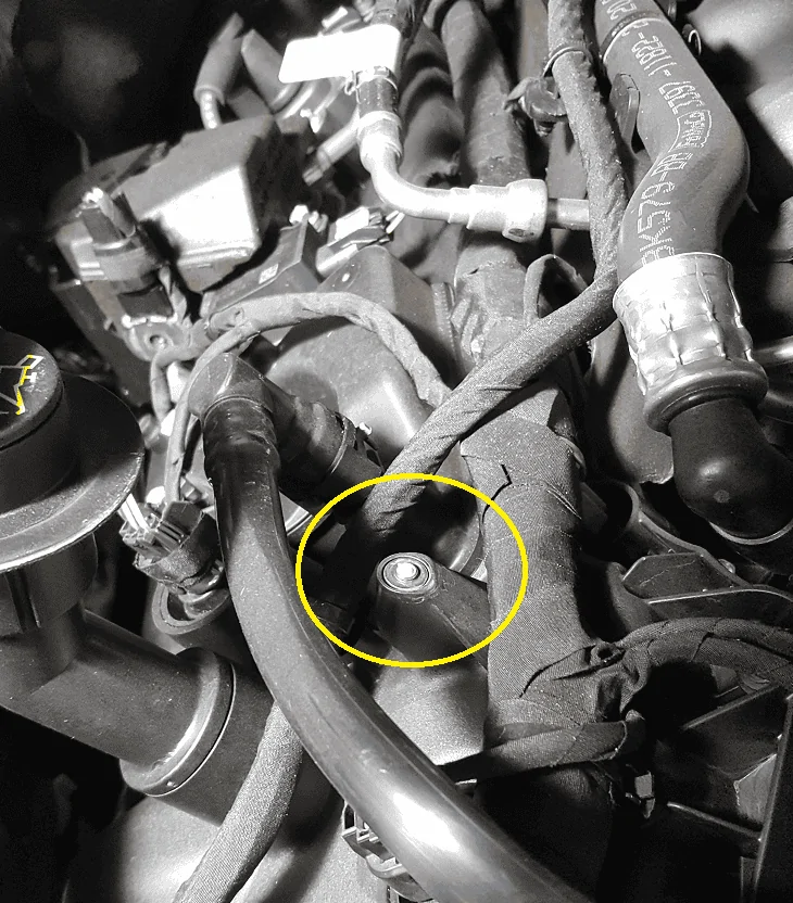

Hello all.
I bought a 2018 GT with just 3k miles, and it's in good shape. But, oddly, the posts that hold the engine cover are broken off. This appears to be a deliberate act. Maybe the past owner was an Engine Cover Delete kinda guy, and it might be common to break these off when you do that. I dunno.
In addition to the broken posts, the engine cover is missing the grommets that go over the holes where you access the bolts.
Why would they be broken like this, and, can this be fixed?

Is that bolt sheared? WTH kind of previous owner was this? Lol.
Welp, according to the responses so far, this ISN'T something that "might just happen", nor is it part of a engine cover delete mod.
It's a local car bought new in April and was traded in October for a big dually RAM truck (to cart his next project to the strip??). Seemed most of the used Mustangs around here were Ford corporate cars driven up in Michigan for 10k+ miles before being sold to auctions in the Southeast. I avoided those. This one "checked out" (according to me).
What else should I look for regarding signs of deleted past engine modifications?

Should not be too hard to get the broken screws out. Just get a drill extractor bit and look for a vid on youtube on how to use it. As long as the screws are accessible with a drill you should have no problem.
Yeah. I was fearing Heli-Coil and all that mess, but you're probably right.

The bolt in the pic at least is an easy fix. There is enough of the bolt sticking out of the hole for the dremel slot method.
Dremel a slot for a flat head screw driver into the top of the broken stud and remove it that way. Those shouldn't be in there that tight.
