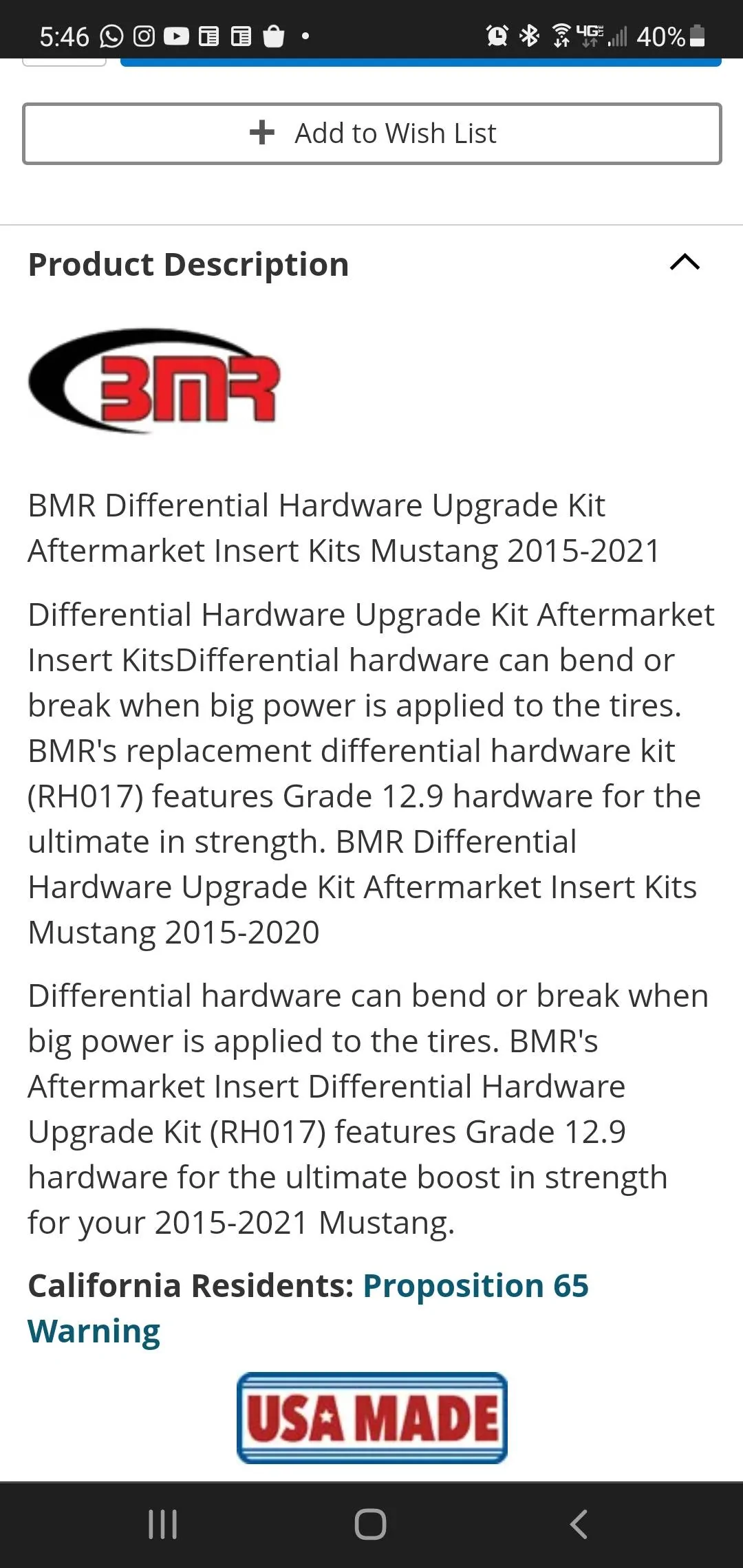

I have no idea why this keeps happening. Did a roll race on the track. Went from 2nd to 3rd and pow!!!. I have the stronger diff bolts, g force halfshafts, bmr vertical Links, bmr cradle, aluminum driveshaft, eibach springs and I still keep breaking the passenger side diff bolt. Please help lol. I have no idea what to get next to prevent this from happening. Car has 3:73s with the Vortech V7JT. Street tire. Any suggestions? Thanks guys

They make a grade 8 that fits in there ?

call arp and get a custom age 625 bolt made for it

Speculating could be all the other components upgrades mentioned have removed some drivetrain compliance enhancing diff bolt stresses.....
Will better shocks realive some of the stress of the diff bolts? Maybe a drag radial or slick?

That answers that, the ARP suggestion sounds like a good start, see what they offer.
After all you have a spec for a base line .
