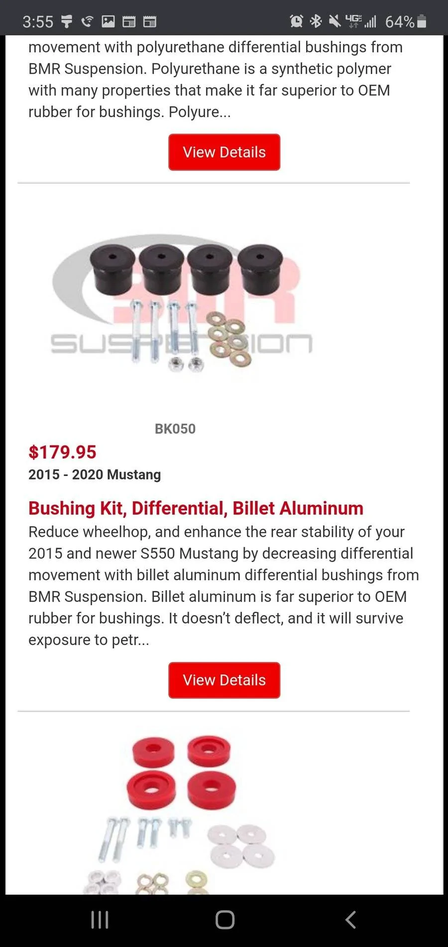

Hard shift into 2nd... wheel hop for a second and boom!! Diff bolt broke again. I've used the BK054 inserts and bigger bolts and it still broke. I guess I'm going to have to get the BK050 bushings. The ones that require you to drill the old ones out. Anyone have the BK050? If so... how bad is the NVH. I really don't want to get these because of the NVH but I cant take it anymore. 3rd time I broke the same bolt in the same place. I also have BMR cradle and links on the car lowered on eibach pro kit springs. Or what kind of bushings are you guys using to prevent this from happening. Thanks

I use the whiteline bushings and even though they’re the softest aftermarket option, they still have some very annoying nvh. Aluminum would be unbearable, I can only imagine.

Do the thru bolt kit. Its stronger than any bushing or insert that dosent change the shear point.
