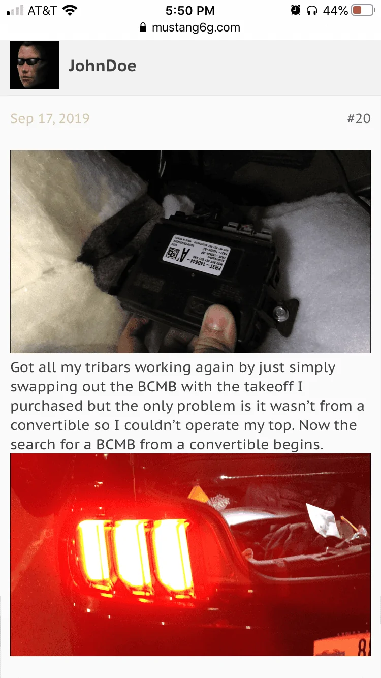

If the Dealership cannot fix the issue via the SSM, then you will definitely need a BCM. Be sure you are purchasing the correct BCM, because the Coupe (fastback) and Convertible BCMs are different and are not compatible due to the difference between vehicle options.
Also to note, be sure you are also getting same model year BCM for your vehicle. On the exterior of the BCM case, there are white labels with production dates and codes as well as Ford Part #s. As long as the Production Date is within the same batch as your original AND some or all of the other codes/part numbers match your original then it should be the one you need.
