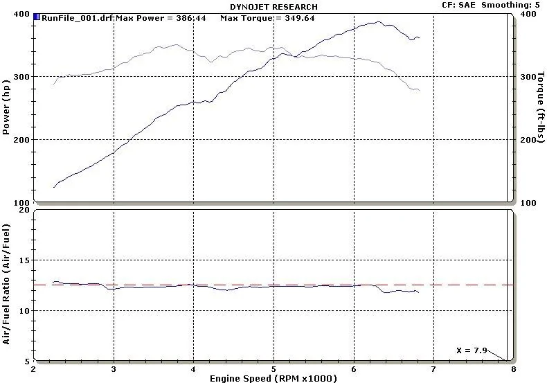

Interesting, i ve seen dyno graphs of cars here in this forum showing 395+ whp with just a catback upgrade. Also the dyno graphs of Gibson and other companies showed gains but that might be the difference of 87 vs 93 octane fuel with a broken in engine. Its hard who to trust here lol.
My dyno before Whipple install with only FFRP Sport kit.
Definitely more than 3-5 hp

What were you putting down before the catback? Because the look of it that graph only shows a 13% drivetrain loss for a stock 435 hp crank horepower coyote! That should be the stock number for the car.

I'm not the be all end all on the matter let me put that right out there lol.
But.... Based on your 13% guess on drivetrain loss a car with 379 rwhp with 13% loss would be the stock advertised 435 hp (379 / .87 = 435.64)
This is assuming the car only has 435 hp but it might be more.
My dyno result with the same equation (386 / .87 = 443.68) is 8.04 gain.
But from what I'm told the industry standard is 15% drivetrain loss
15% stock is estimated (370 / .85 = 435.29)
15% mine is estimated (386 / .85 = 454.12)
This example is 18.83 more hp
Either way is more than 3-5 and based on industry standard its 18.83
Get ready, the flood gates are about to open lol

Yup but i ve seen a lot of dyno graphs here and there is also a dyno adjustment factor to your numbers anyways, the s type also has a 3" setup compared to 2.5" setup on the Touring. That might also give different results.
It is interesting that i ve seen also stock cars putting down wait for it, 400 whp on a dyno graph and it also depends on the dyno. Thats is why people always ask about the stock and after dyno graphs to see the resonable increase. I ll definitely dyno my car before i do the exhaust setup though. The force is strong with this one
