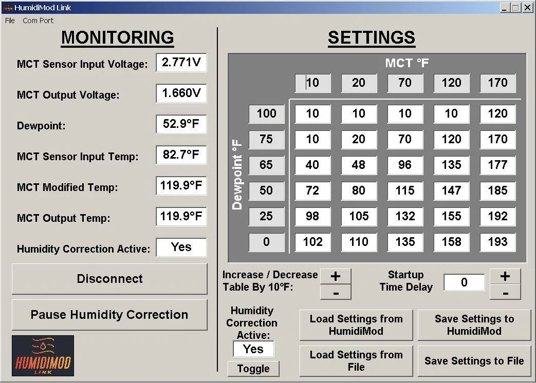

Luckily, I have a close friend who builds circuits and programs microchips for fun. He designed and built a circuit that adds an external humidity sensor, intercepts the Manifold Charge Temp (MCT) signal, and modifies it such that timing is pulled or added as a function of humidity. The final MCT signal is a combination of both charge temp and humidity such that both can be used to adjust borderline timing. MCT was chosen because it has little other effect on the overall tuning other than just for timing adjustments. The following log data were taken within minutes of the above logs on their respective days, but with the humidity timing correction active:

You can see that the commanded spark timing (borderline plus knock advance) went from 18.7 deg without the humidity correction to 17.1 deg with correction for 68 deg dewpoint and 15.7 deg with correction for 45 deg dewpoint. You can also see that only one cylinder had incidental knock on each pull. At a 75 deg dewpoint, there wouldn't be any correction at all and the full 18.7 would be commanded even with the correction on. The end result is less power loss on hot, humid days because the timing will be more advanced, and safer spark timing on dry days.
I'm pretty excited about this because it will allow me to run the same tune year-around and take advantage of an extra couple of degrees of spark timing in the summer while maintaining the same knock safety margin.
