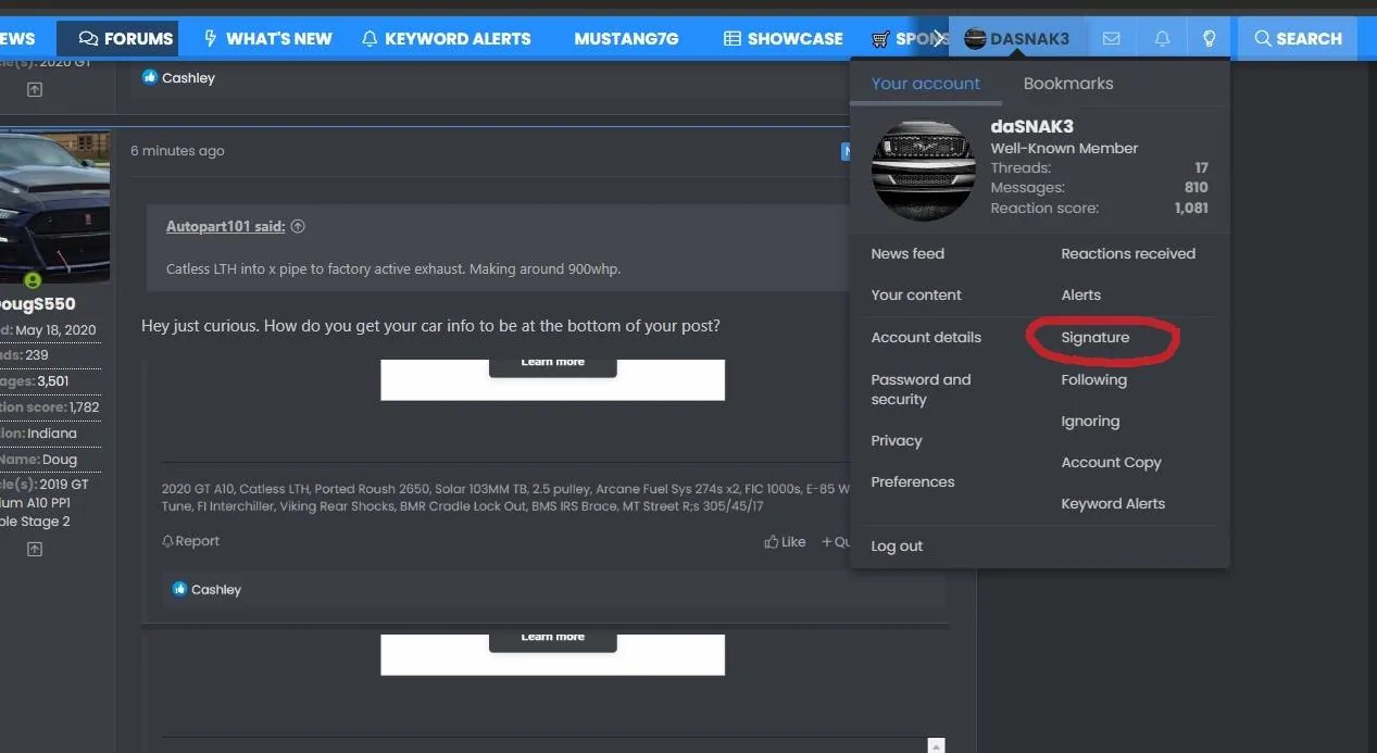

Hey just curious. How do you get your car info to be at the bottom of your post?
daSNAK3
May 9, 2022
1,331
1,893
Cary, IL
Jake
2021 GT
