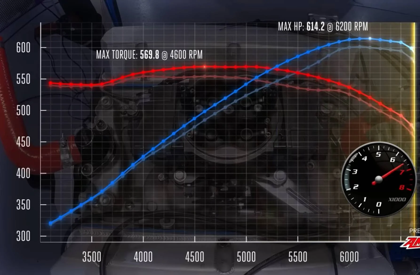

Hello; Watched an ENGINE MASTERS episode season n6 episode 15 again. The have a V8 with a turbo. A 5.3 liter LS (LM7) iron block truck motor with upgrades. They run cast iron exhaust manifolds Hooker Headers specified for a single turbo application.
Turbo is an S480 with an 80mm billet wheel 1200 HP capable but tuned down to 600-700 HP. They use several sensors, back pressure included. Idea of episode is to try configurations a person might rune on the street.
They run 4 inch and later 3inch exhaust pipes with the purpose of finding out what adding mufflers will do to HP and back pressure.
4 inch straight pipe (open exhaust) yields 617.2 at 6000 peak HP & 575.5 torque at 5400
3 inch pipe with flomaster chambered muffler yields 547.6@5900 HP -519 @4800 torque
3 inch pipe with summit turbo muffler yields 461.8 @6300 HP-449.3 @4600 torque.
3 inch pipe with floMonster (straigh thru muffler) yields 579.7 @6000 HP 542.0 @5300 torque
3 inch pipe with no muffler yields 572.6 @5900 HP -536.4 @5000 torque
Kinda odd that the floMonster straight thru muffle beat a 3 inch straight pipe.
4 inch straight pipe short (open exhaust) yields 617.2 at 6000 peak HP & 575.5 torque at 5400
4 inch straight long (open exhaust) yields 623.2 at 6100 peak HP & 579.9 torque at 5400
4 in pipe with a Flomaster 4 in chambered muffler) yields 604.1 @6000 HP -563.2 @5300 torque
4 in pipe with Flomaster pro series yields 617.7 @ 6000 HP -580@5300 torque
Two items of discussion among the three on the show. First they felt the down sizing from the 80 mm turbo to the 3 inch pipe may have been the biggest problem with the 3 inch pipes. The other is do not place the restriction close to the turbo.
Frieberger suggested letting the turbo be the muffler and I guess just run as big a straight pipe as you can fit. The reason seems to be backpressure hurts a turbo system.
Have to take back my recall of an earlier post. pipe diameter can make a difference. I need to look back to see what system the OP plans to use. Likely be a different story with a supercharger. No easy answers I guess.
