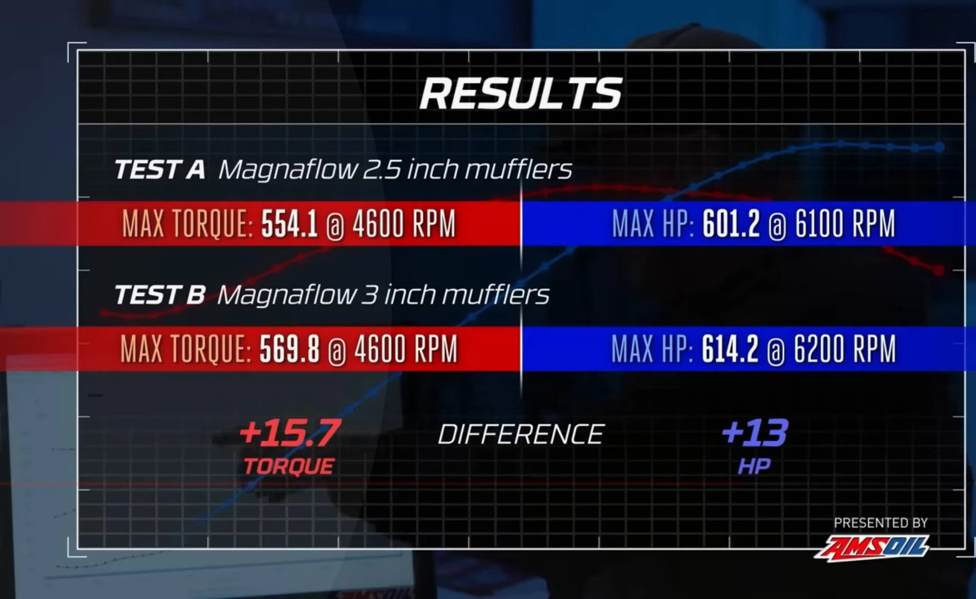

I'm betting gains are neglible
What's "negligible"?
Here's 13hp on a 600hp NA engine
900hp engine is going to be more but then again, how much? 15? 55?
How much HP to spend $1200 on new mid pipe, tailpipes, mufflers. How much is the extra weight worth? Extra volume?
