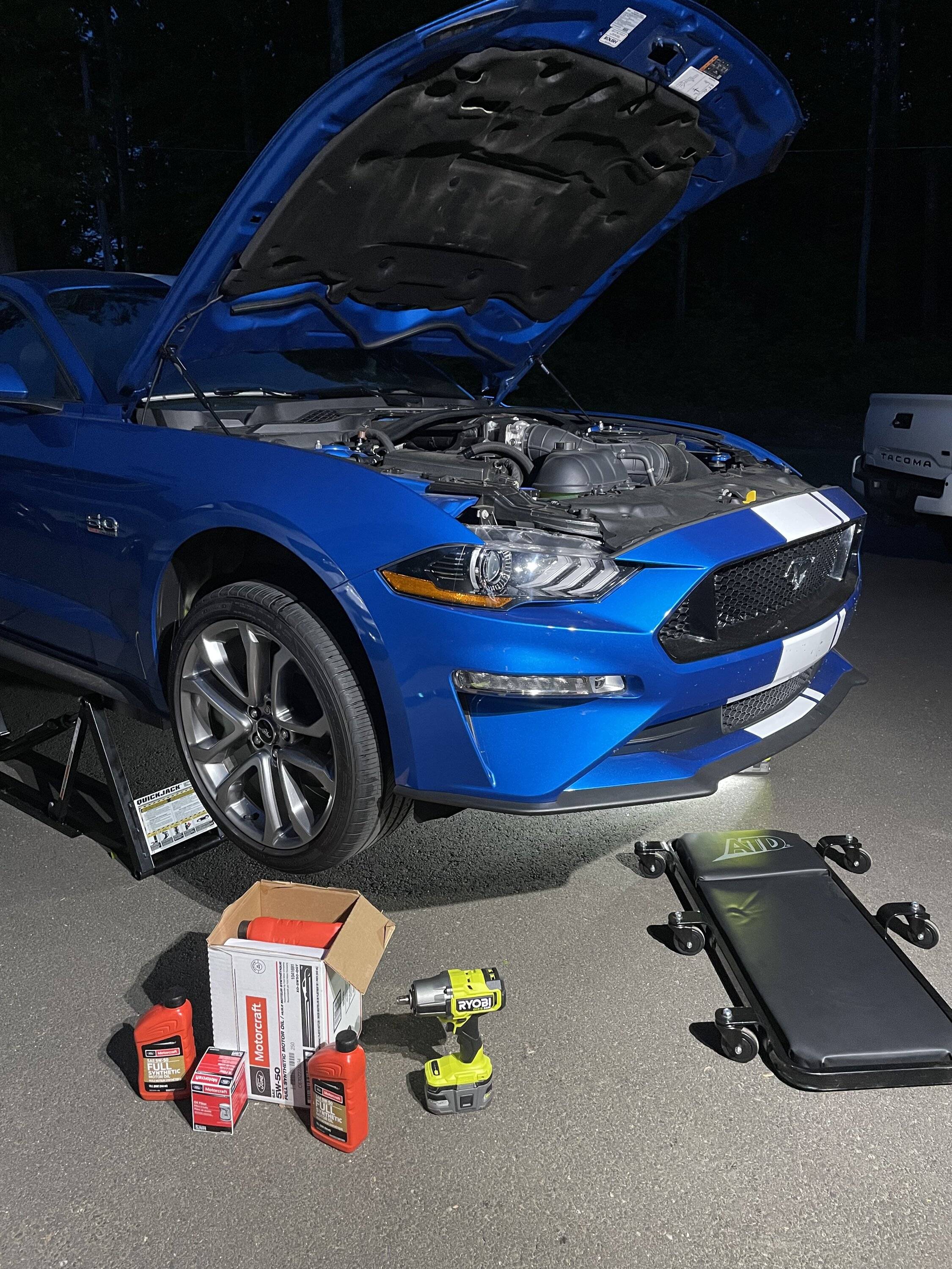

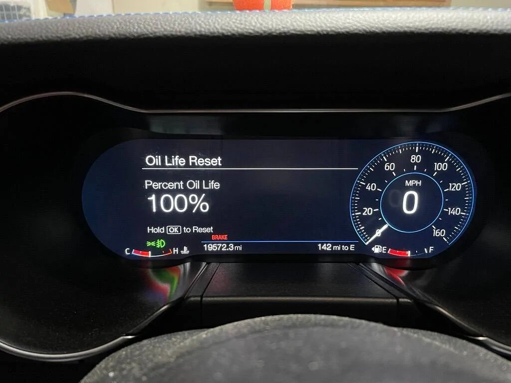

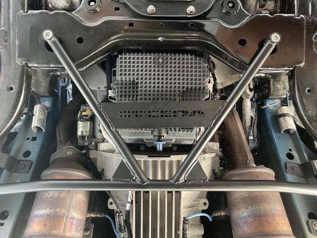

Oil change and tire rotation:

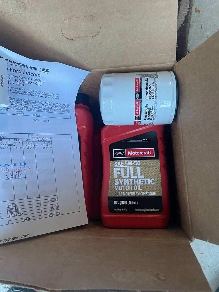

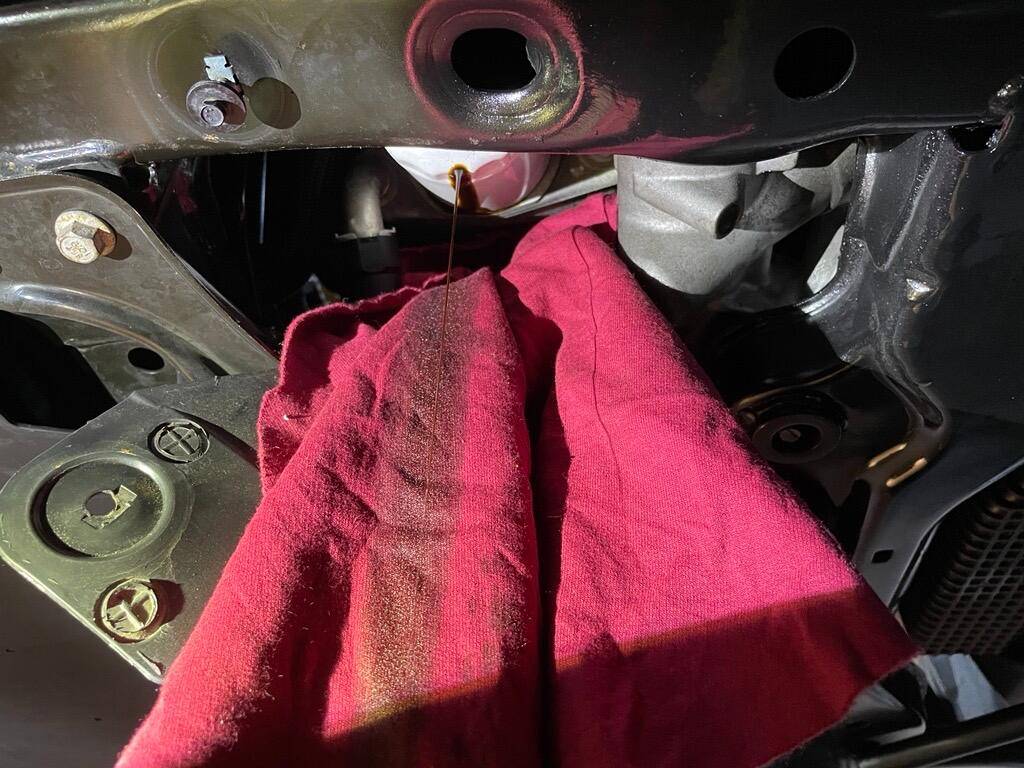

DIY oil change cost me $158. Motorcraft 5w-50 is up to $14 per quart from my local dealer. 🤮

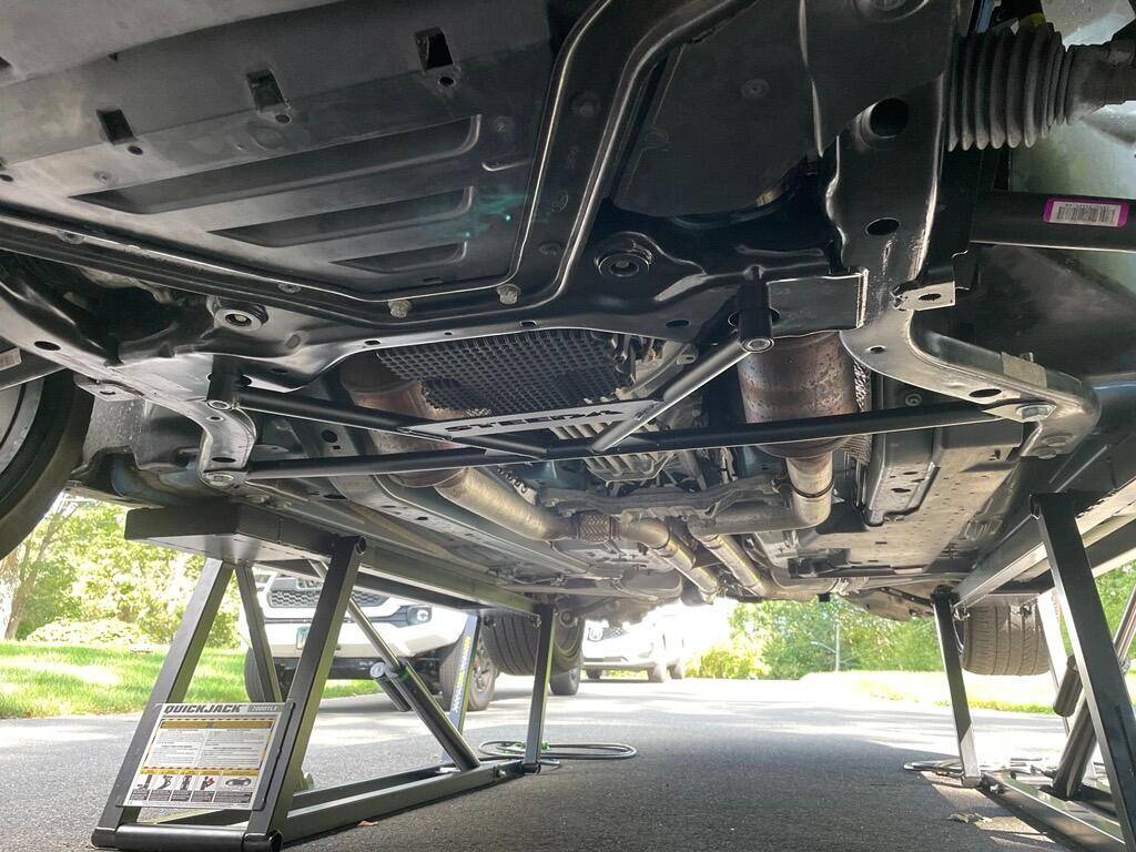

The UPR Easy Oil Drain Valve works great with a 1/2" ID hose. A must have to avoid a mess with the K-member brace now installed. It does take a bit longer to drain the pan. It was empty within the time it took me to rotate the tires.

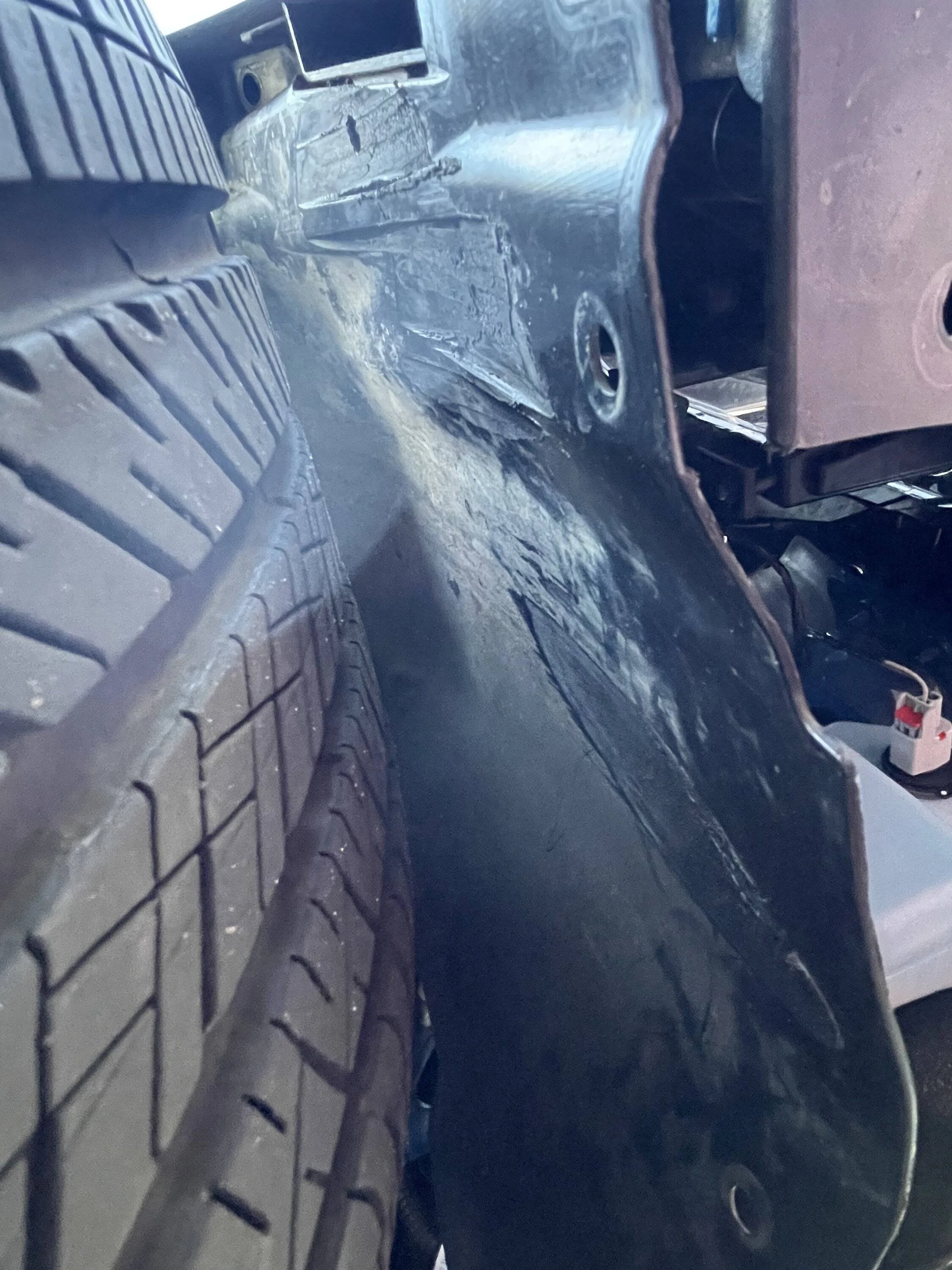

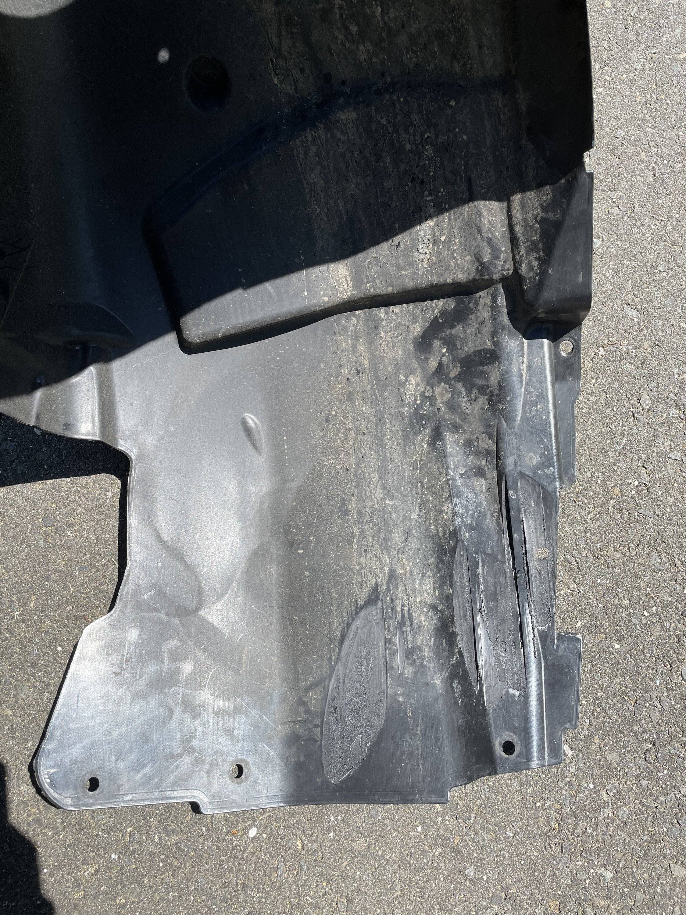

With tires out of the way, it was a good time to replace my cooked fender liner. I burned a few holes through the passenger's side doing a WOT pull with the front bumper off. 🤦‍♂️
This was a $127 oops: Fender Liner - Ford (JR3Z-16102-E)

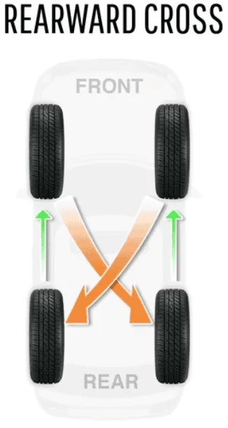

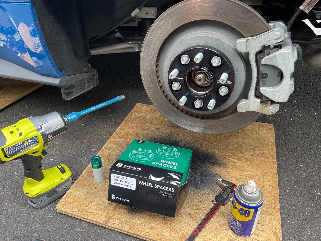

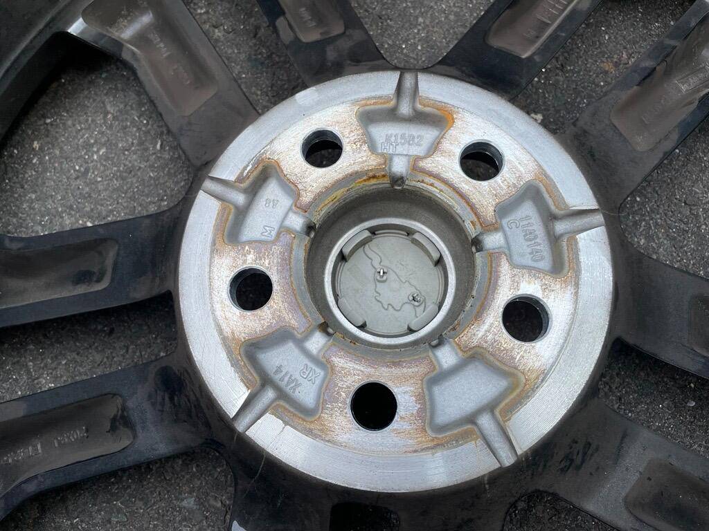

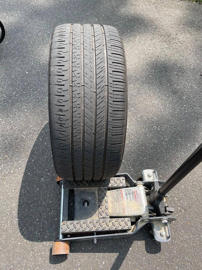

I rotated the tires in a rearward cross pattern and retorqued the 25 mm wheel spacers to 110 ft-lbs. A set of Harbor Freight 1/2" Lug Nut Impact Sockets and Torque Limiting Extension Bars with the Ryobi High Torque Impact Wrench made it quick work.

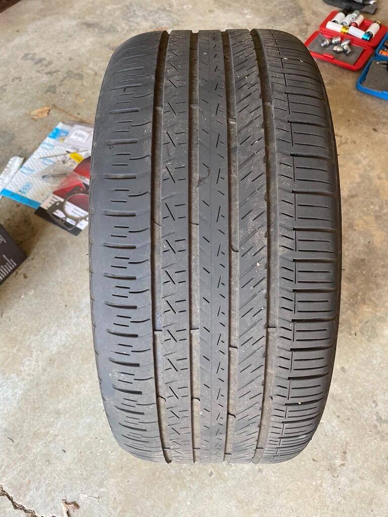

I noticed uneven wear on the inner tread of the rear tires. Hopefully the toe correct during that recent alignment corrects this. If not, I'll have the rear negative camber reduced.
It's currently -1.7° and -1.9°.
My local shop recommended that we not mess with the S550's shoddy rear camber adjustment unless necessary. I'll be purchasing the 555-4126 Steeda Rear Camber Adjustment Kit to help dial it in next time.

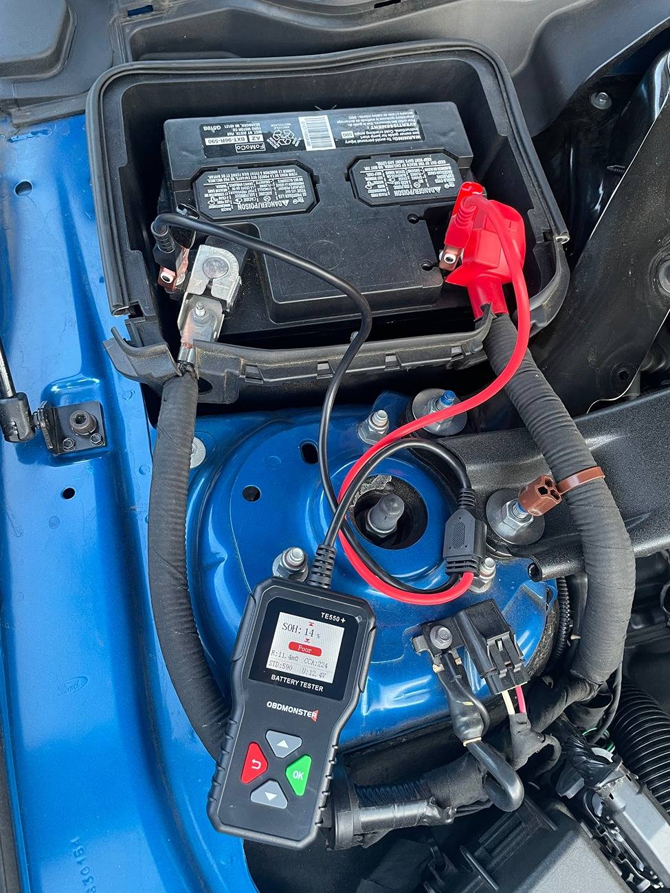

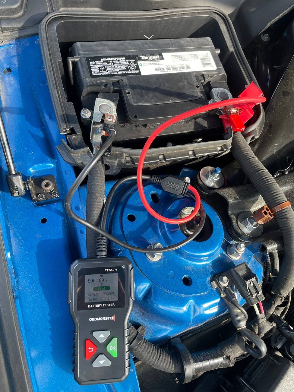

Last Fall I started having all sorts of intermittent issues at high rpm WOT.
The PCM would aggressively pull timing around 5500 rpm:
  • If I Immediately let off the gas: CEL might flash and put me in limp mode for ~10 secs.
  • If I punched it through the timing dump to redline: A p0300 (random misfire) code might log.
I've been on the hunt for chewed wires because the car sits. I was starting to think that the chiller and Roush calibration weren't getting along. It's very apparent that the Roush ACT sensor reads chilled IAT2's untrue as engine heat builds.
I finally caught a pattern in March. AFR spikes. Battery was shot. I installed a Duralast Platinum battery on March 16th. All better.

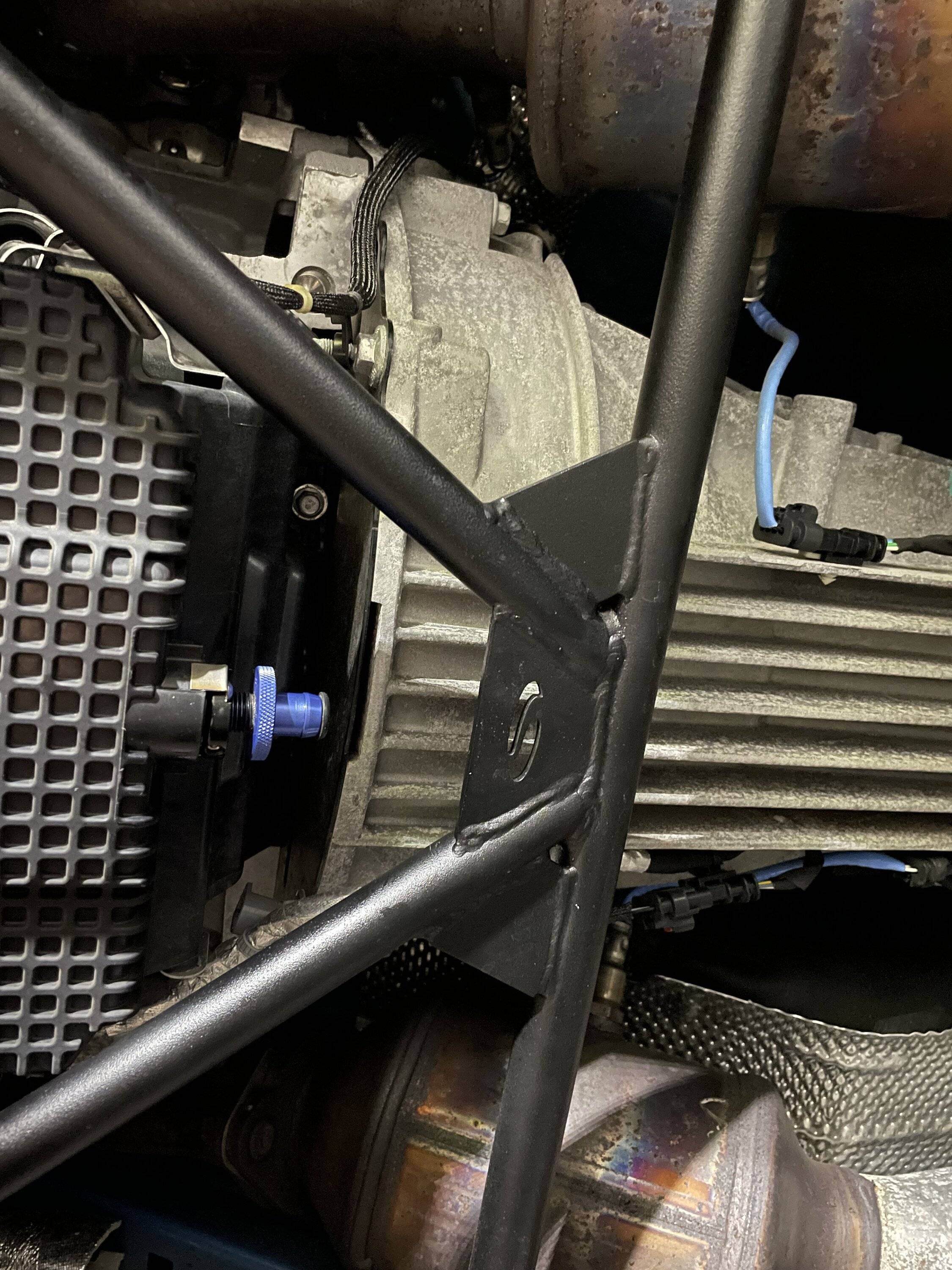

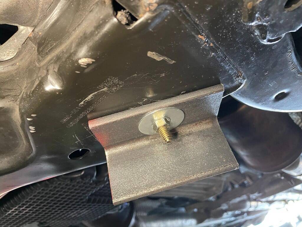

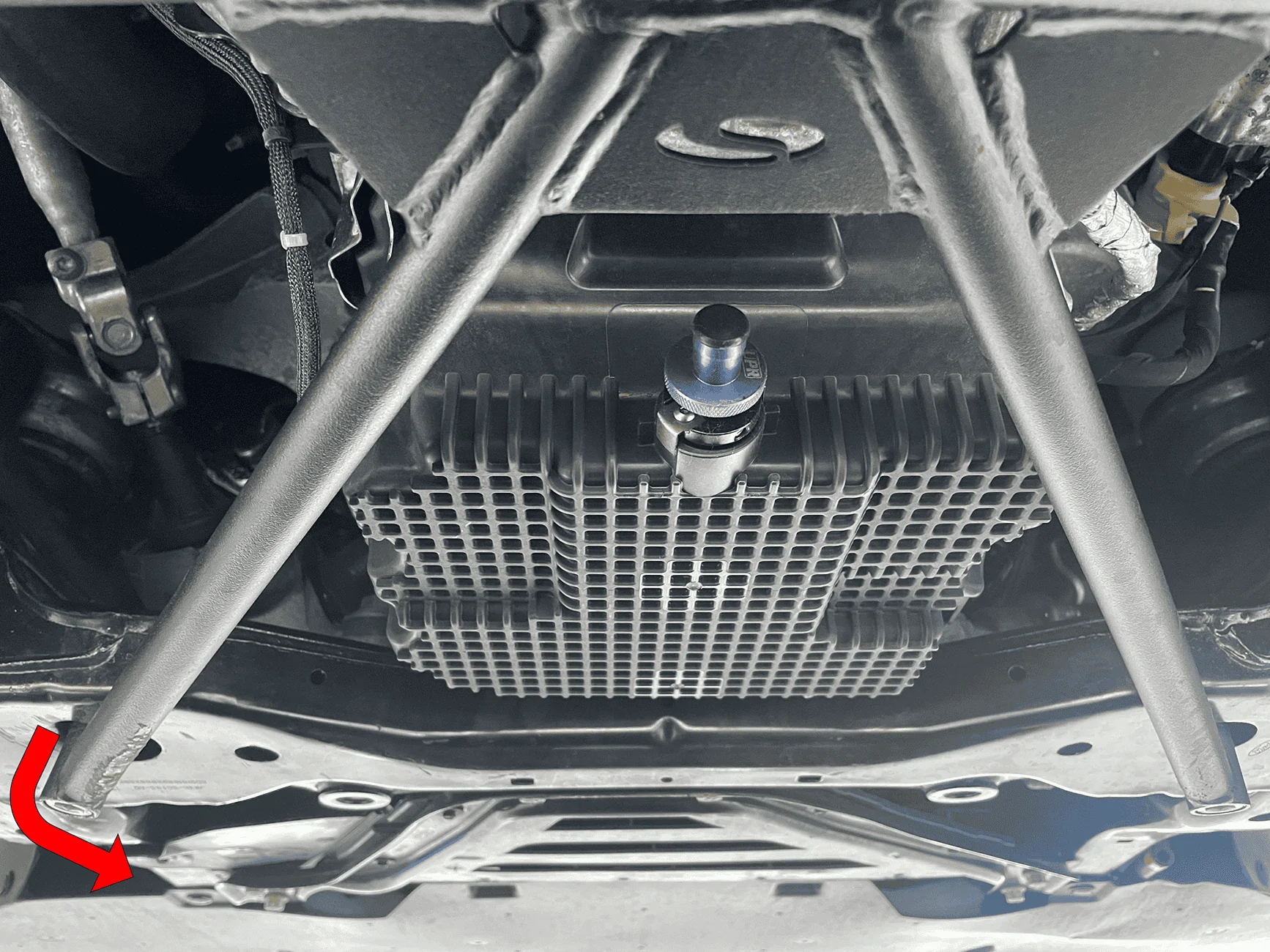

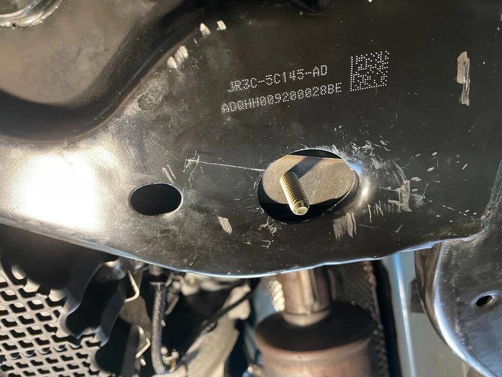

I had a brain fart yesterday... Forgot I parked next to a narrow curb border on my passenger's side. No damage to the bumper, but I clipped the front DS mounting point of the 555 5532 Extreme G-Trac K-Member Brace while leaving the parking spot. The brace held up shockingly well.
I have the tools available to correct and confirm the twisted brace. Shot a message to Steeda to see if warranty or replacement is the better move.
The subframe still seems square based on a tape measurement. I'm going to order a tram gauge to confirm. The frame mounting point definitely bent. I'll be making a clamping jig to correct that. Front end alignment coming soon.
Super annoyed with myself. 🤦‍♂️

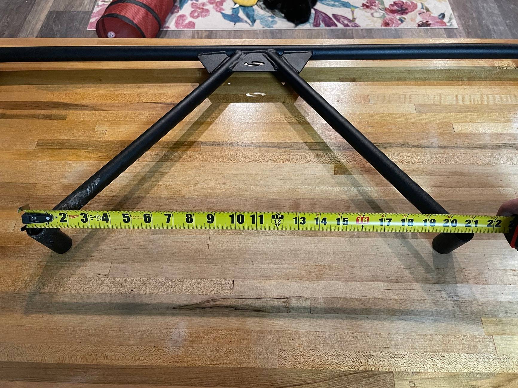

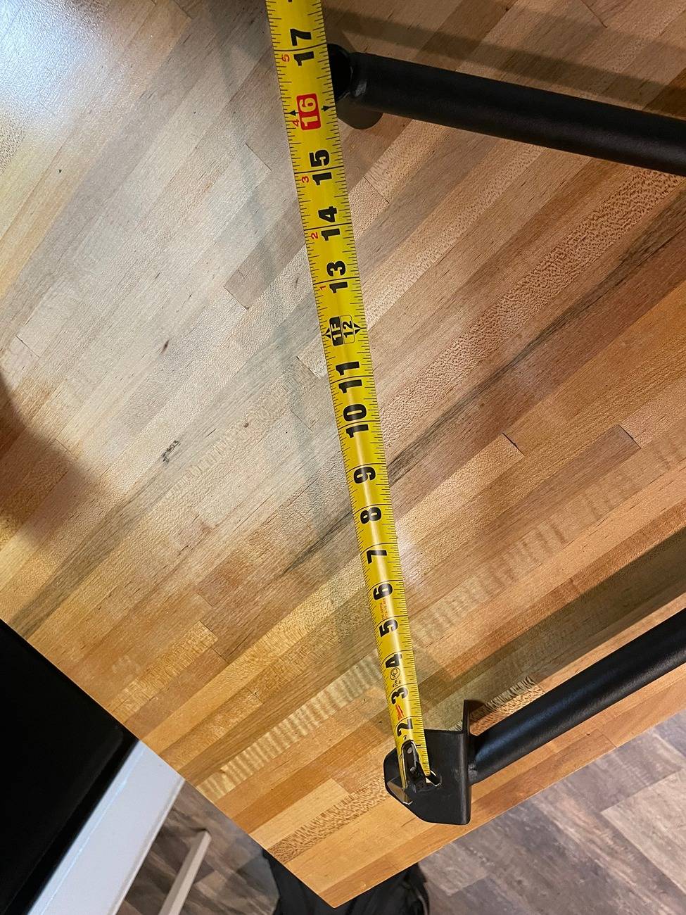

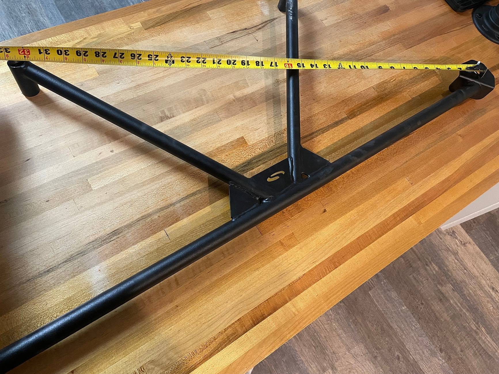

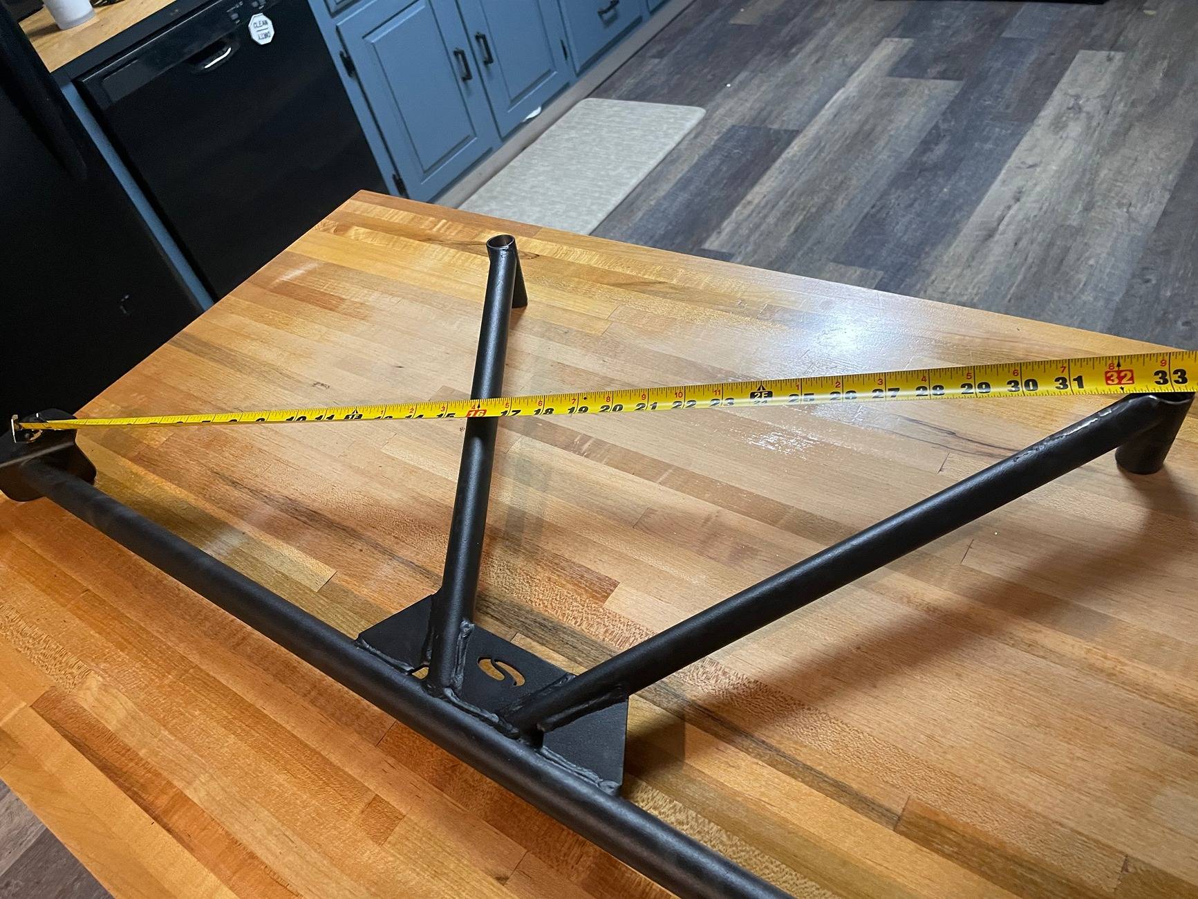

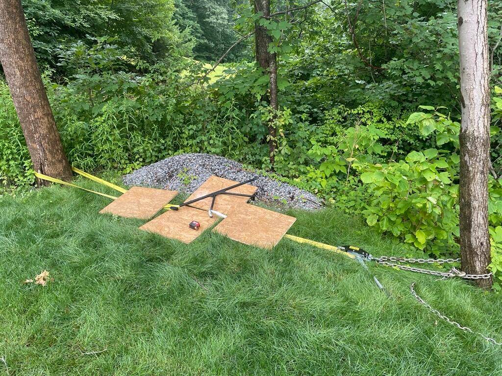

Got the brace off. Let's see how tweaked it is.
Roughly locating the undamaged front PS mounting point:
Roughly locating the damaged front DS mounting point:
FDS to RDS is out ~1/2".
FDS to RPS is out ~3/8"
Flatness is out ~1/8"
Rough game plan:
  • Twist counterclockwise 6 degrees
  • Pull down 1/8"
  • Pull away from rear DS mount point 1/2"

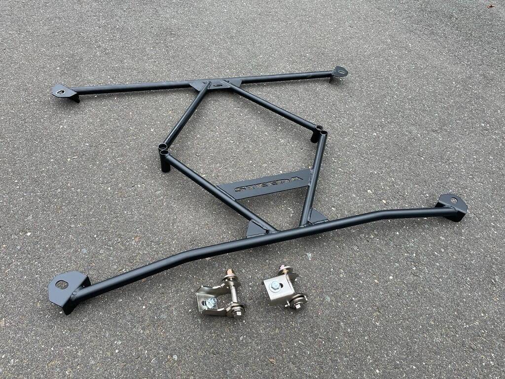

Sept 2, 2024:
I was able to straighten my damaged G-Trac brace and Steeda sent me a replacement updated version for dirt cheap. Thanks Steeda!
Fixed the minor frame damage and installed the new brace.
I had a minor alignment panic attack before realizing the label plate was welding crooked.

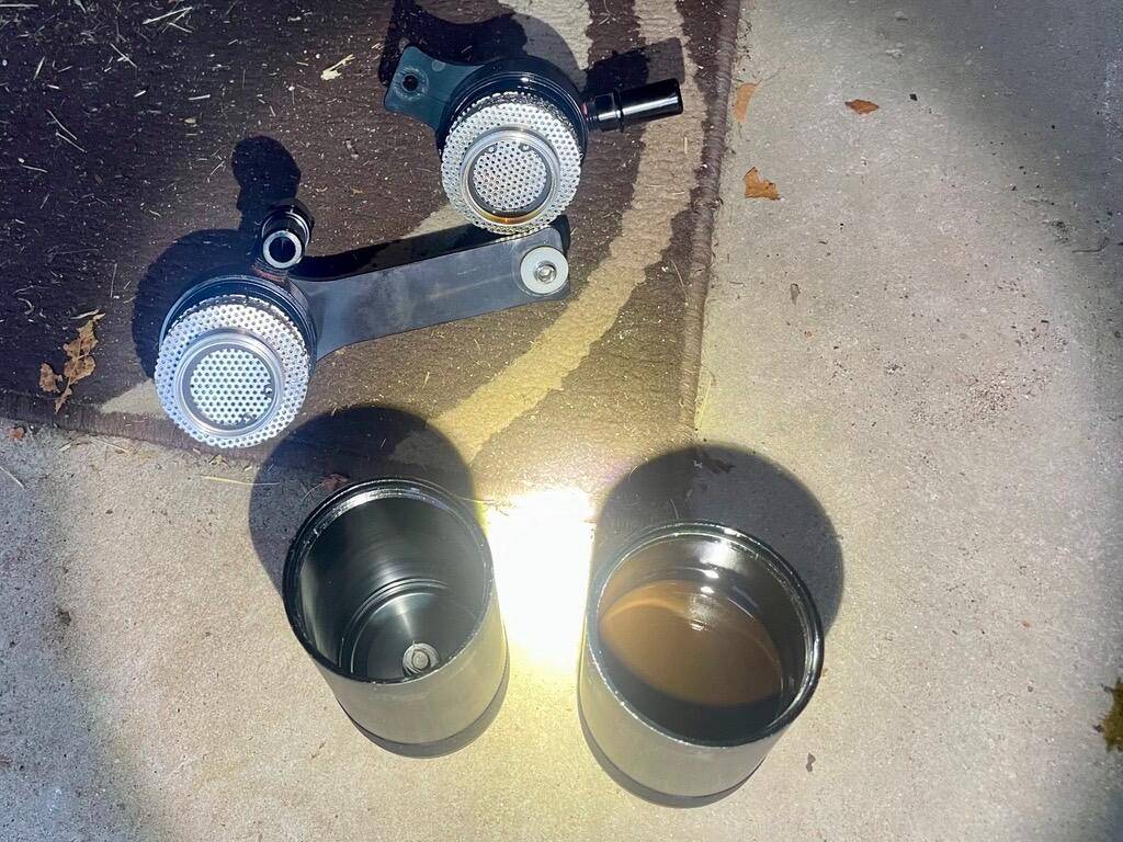

I won't wait 5,000 to empty the catch can again. The driver's side can was bone dry.

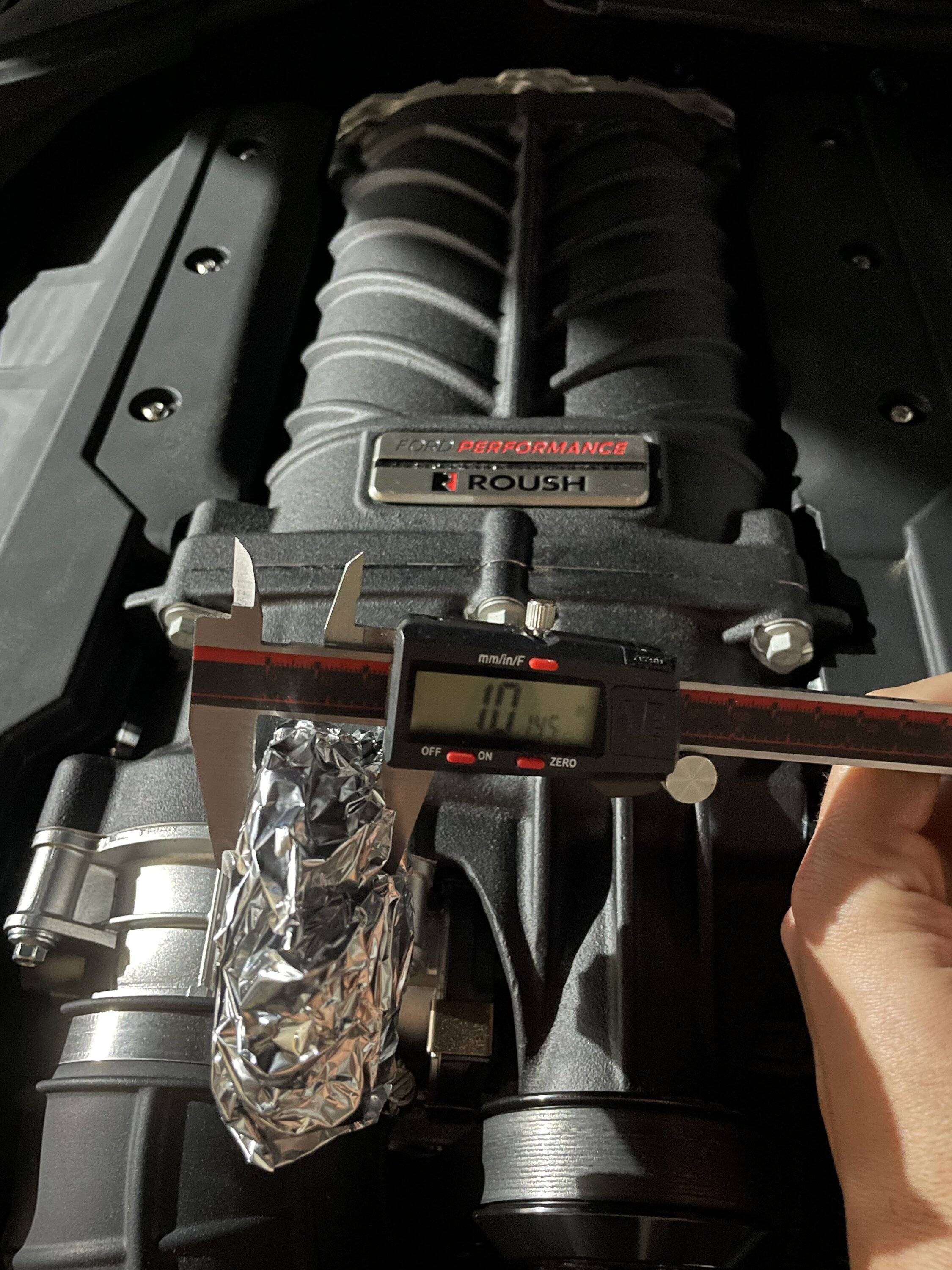

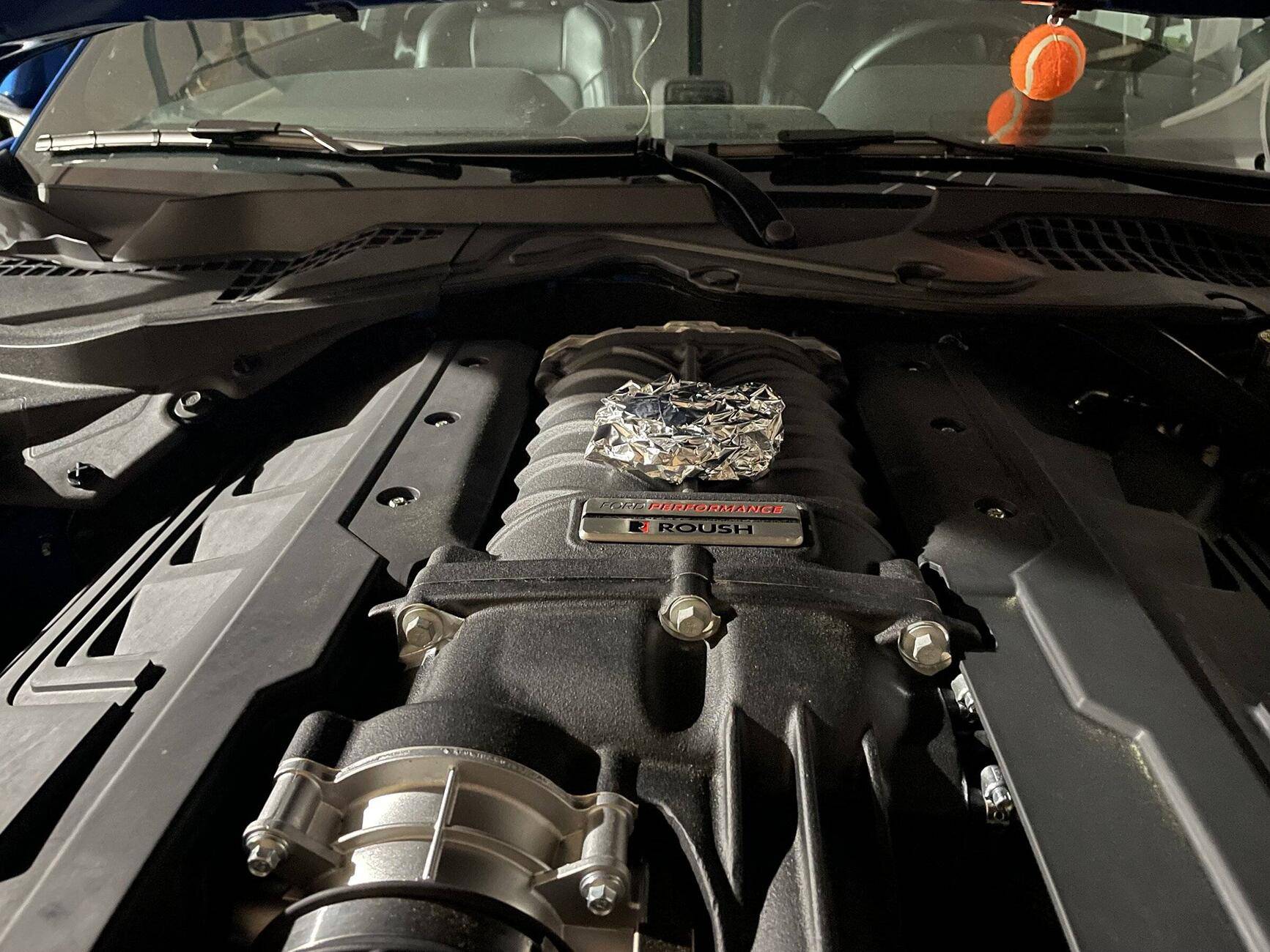

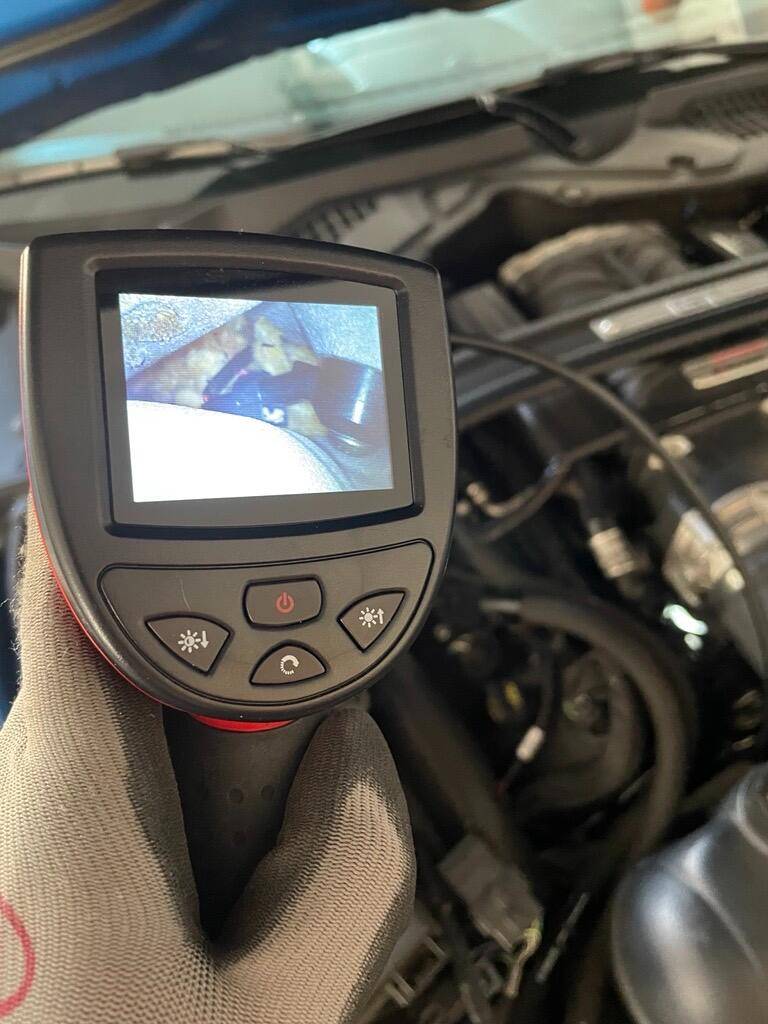

Found what looks to be a mouse nest under the supercharger today. No sign of the little bastard. Car idled for a couple minutes with no CELs. It's packed too dense to inspect the knock sensor harness.
Lifting the SC seems to be the only way to clean it. I'll be spraying the engine bay with mint from now on. Mighty Mint Rodent Repellent Spray

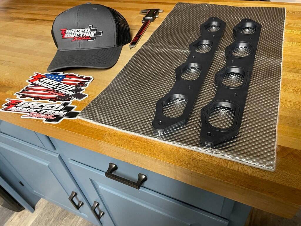

Might as well add some improvements while the blower is out of the way. I ordered the FI's Blower Spacer Plate kit. The spacers are 10 mm. Kit includes a thermal blanket to stick to the belly of the IM to reduce radiant heat.
The strut tower brace will need to raise at least 5 mm. Don't know if I have hood clearance.
$410.90 shipped. Ordered on Feb 1st. It arrived today. The spacers and blanket shipped separately.
The included thermal blanket is 12" x 21" x 3/16" thick.
My spacers are 0.387" (9.84mm) thick. Variance in thickness is 0.0005" based on my cheap calipers. Spacer material looks to be Teflon/phenolic. Machining quality is good. No sharp edges. The O-ring seals are not made from cord (no breaks). I'm happy with the purchase. This would be quite expensive and time consuming to make it yourself.
