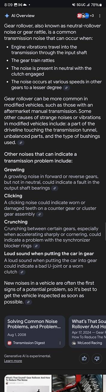

Define gear rollover, please.

Sounds like a grinding noise at low rpm. Sprung hubs will dampen it so you can't hear it but with a solid hub it can be noticeable. I believe it has to go with the harmonics that are being transfered though but I'm sure you could google a better definition. I only learned about it after my initial install. Car drive and shifted great but I hear it while going slow and freaked out thinking I was going to have to pull the trans again. Honestly you almost have to be lugging the engine to hear it.

A good way to explain gear rollover is think about when you slow down to make a turn, you downshift and then accelerate from a lower RPM out of the turn. Gear rollover usually happens below 2000rpms, you'll hear this rattle / gear clashing / box of rocks sound resonate from the trans up through the shifter typically. As soon as the RPMs go up, it disappears.
With my original MT82, the gear rollover noise from the solid hub clutch setup was LOUD. Super obnoxious, but my stock trans seemed to have a lot of slop in it from the factory. Probably why it did not last long when boosted.

Ah, I hear it a lot when rolling below 10mph and in reverse. I had a friend scare me the other day when he heard it when I was in reverse. He said, "I heard a clicking grinding noise when you backed up!!"
I was all concerned and had him drive it in reverse while I listened. I said "THAT noise?" He said, "Yeah..." I was like, "Nah, that's normal for this clutch."
Thanks guys. I never heard that term associated with it.
