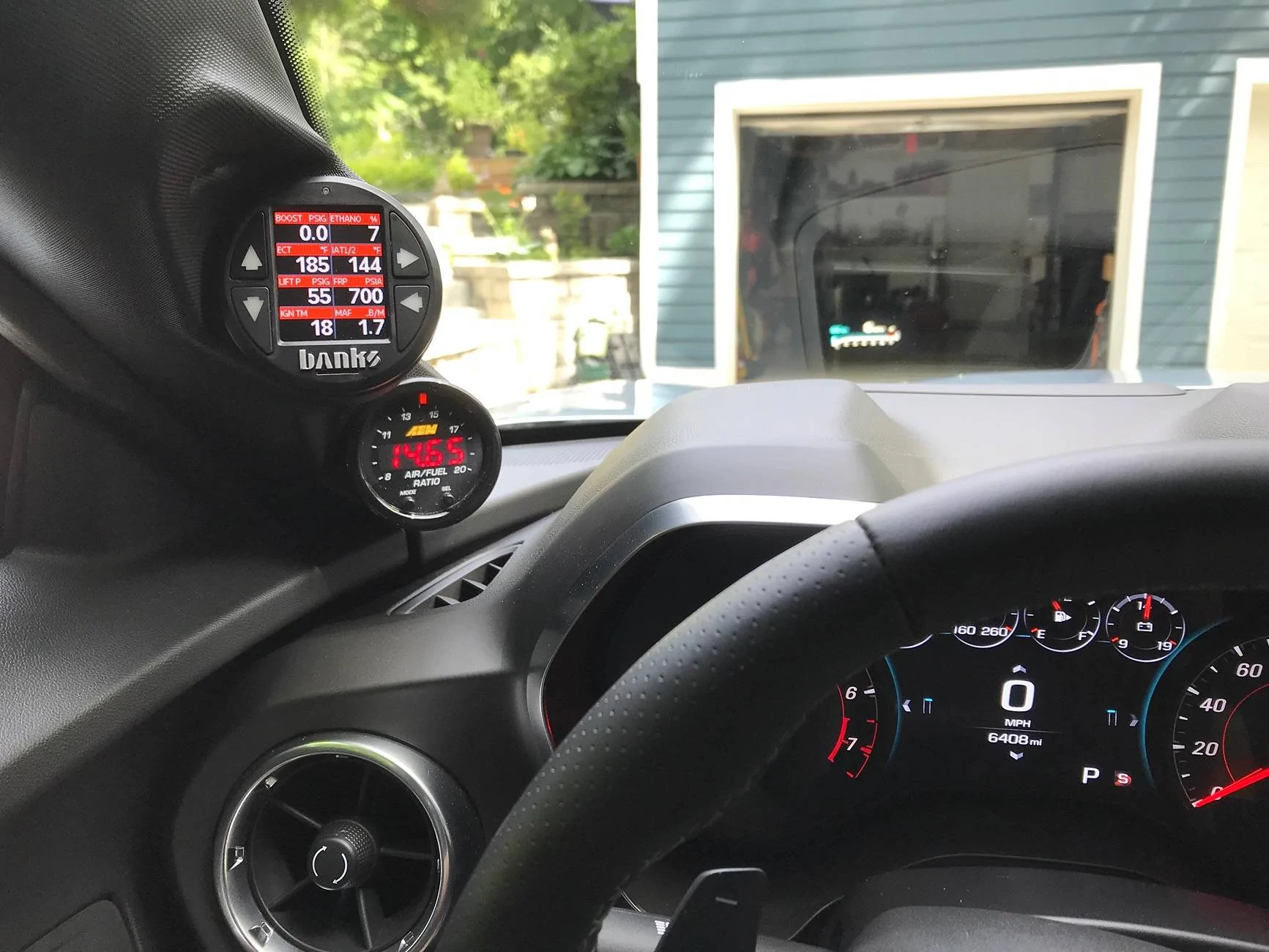

How about the Banks iDash? Can read a lot more than boost and simply plugs into your OBD-II port.

That looks interesting. How do this and the others posted that read boost pressure through the OBDII port without a hose ran to the supercharger work? Seems like an easier route, but are they just as accurate?

The car will have a MAP sensor that reads manifold pressure for the car’s ECM, so the Banks takes that off the cars canbus network. MAP - BARO = BOOST :)

Totally understand where you’re coming from, good point. That said, I can tell you from having a reasonably quick car (9.10 @ 153) you’re NOT watching that gauge when driving under boost lol…. So let the thing log it for you, then review it after the fact. A mechanical gauge is useless in comparison (even though you’re right about it being more readable).
