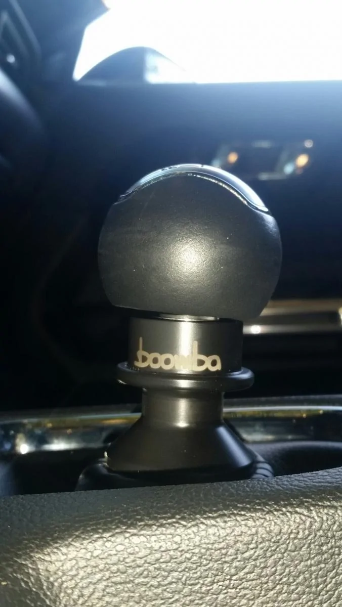

Install was simple and straight forward only problem is this gap between the stock knob and shifter. The gap was bigger but I tightened the living crap out of it. For a second I thought it was going to come through the silver piece lol. There is a little more effort when shifting and a small noise when sliding the shifter collar while going into reverse. Of course I don't mind n e of that. But besides the gab I am really enjoying this shifter so far.
