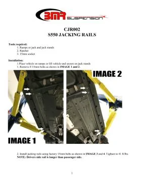

3. Install jacking rails using factory 15mm bolts as shown in IMAGE 3 and 4. Start all bolts and then tighten to 41ftlbs once all bolts have been threaded

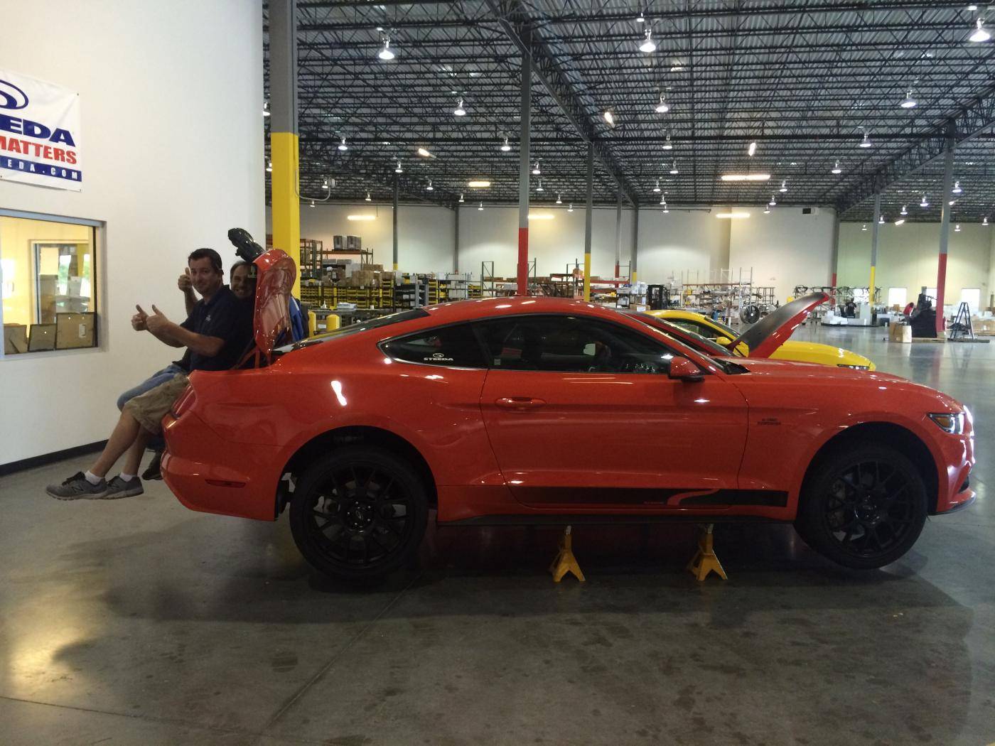

I don’t care to have a shorter tube. The balance on the longer tubes have concerned owners, so much so that Steeda @tj@steeda showed a pick with a Mustang sitting on stands under their rails, with two guys sitting in the trunk of the car.
However, if you’re using a the mini-lifts that more and more people are using, the shorter rails may possibly work just fine.
This one you say?
