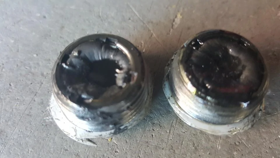

3,4xx miles and its a Torsen (if it matters). I know Ford would say no need. But if there could be significant crud in there from manufacturing/break-in that isn't just going to recreate itself after a change, might as well get it out sooner than later.
I'm guessing the shelf life for unopened diff fluid is substantial, so I'll just order the combo with 75W140 now even if you think no point in doing the diff now. I appreciate the offer to combine a later order for the diff to retroactively make it a combo but no need to complicate things.
Thanks for all the help. I'm off to order. Still interested in if YOU would change the diff now if it was your car or put the fluid on the shelf and wait awhile.
This is after the second batch of Ford Fluid was in there for about 5K miles. I changed it to BG for the third fill. Dealer changed it the first time and noted heavy accumulation on the magnets. That was at 2-3K miles. Mine hasn't blown up yet. The part that will fail on these is going to be the pinion bearing on a 3.73 car. Getting closer to the release of our cooler kit but not there yet.

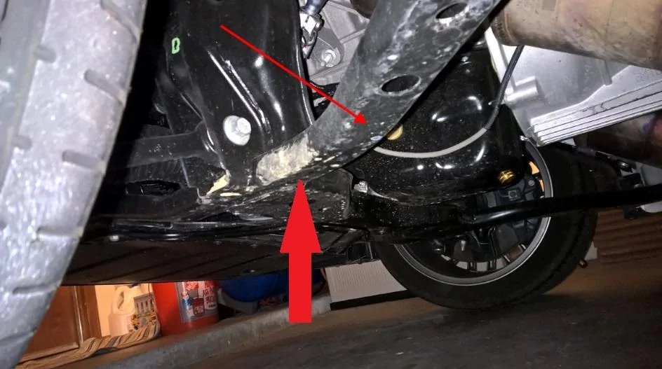

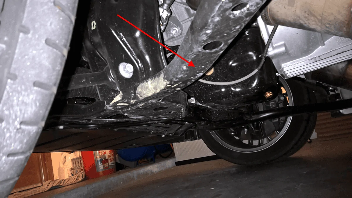

Where can I put jack stands in the front after jacking up on the pinch weld? Can I put the stand where the red arrow is on the pic below? I think that is wider than the head of the jack stand so don't know if its safe from slipping off If I can't put it there, where?
Rear is easy because the car is so stiff and front heavy that when you jack at the front pinch weld jacking point, the whole side of the car comes up and you can put a jack stand under the rear pinch weld jacking point.
Yes but as close to the cradle as possible. Solid place for the stands.
