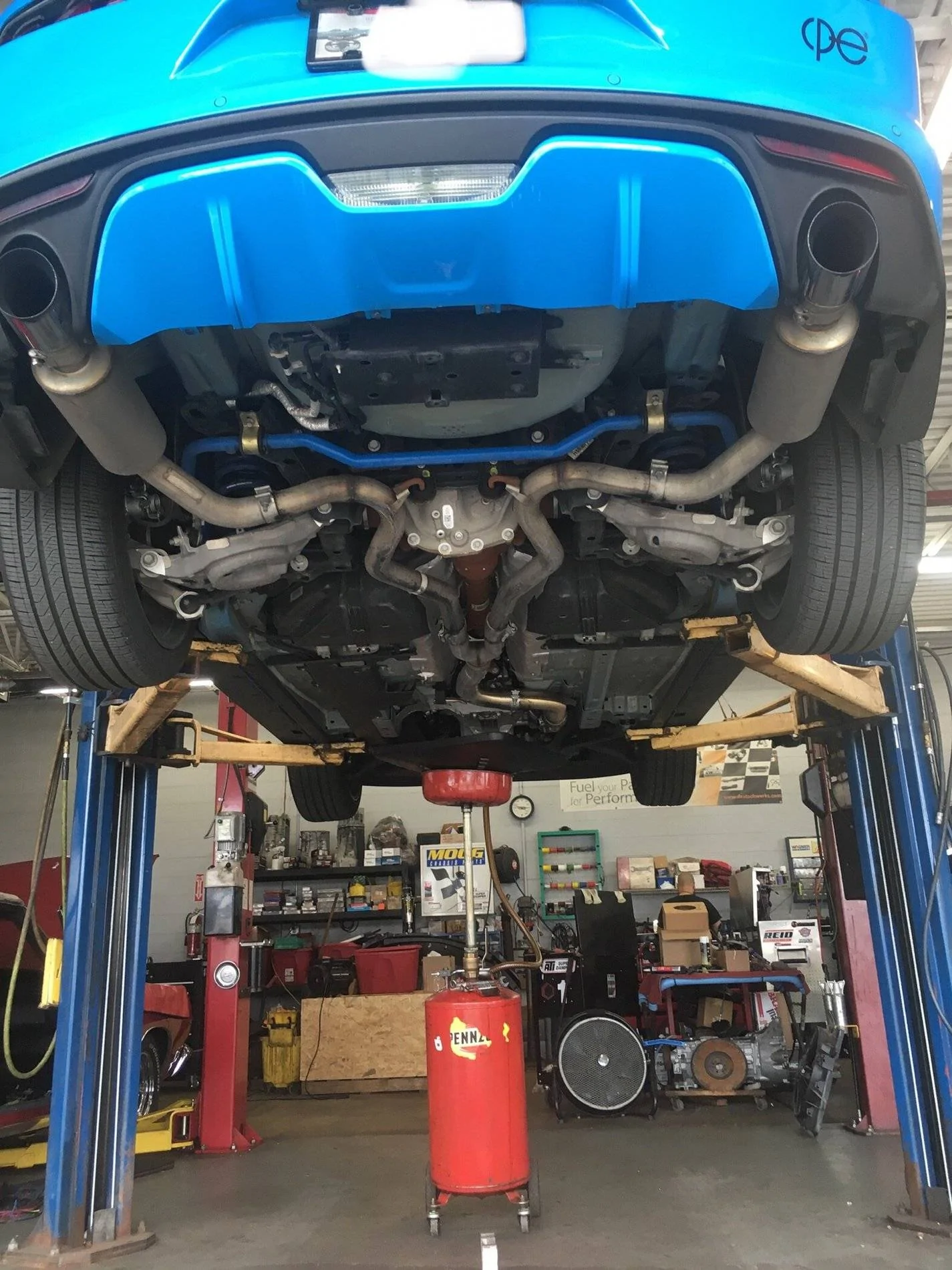

Tossed some bg synchrosift Ii in my car yesterday. I have steeda clutch spring and hybrid Barton 3 body mounted trans. I don’t really have much nibble, it’s pretty darn smooth when warmed up.
But I was at team beefcake’s performance shop yesterday for alignment and realized They sold it so I was curious. Been debating on it itself already. Then went ahead and tossed it in.
initially I felt I wasted $, didn’t really feel any difference. But after a coupledrives andcool downs,the last drive last night it was 100% bitter smooth. Not a single nibble and felt more firm.
like another increase in perfection from the oem set up to Barton, but yet another step up.
Coupe be placebo. But whatever. It’s done and now I can say I did it. Lol

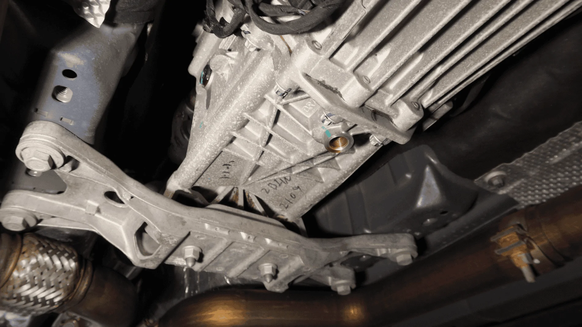

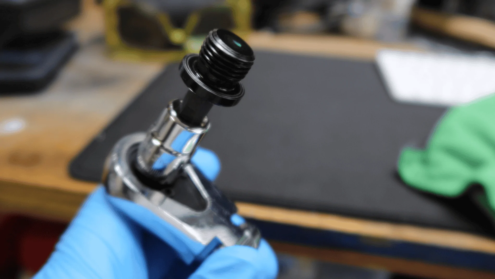

I was going through my content and theres no washer nor o ring to seal it. It looks like the two outer rings bite into where the screw seats and maybe hope oil don't pass through the threads? I was curious when I did the fluid change what was stopping a leak.

Those tranny drain/fill plugs look just like Porsche and Audi oil pan drain plugs, which makes sense, since Getrag is German too. If I remember correctly, the plugs of my Porsche and Audi were M14 x 1.5, but I'm not sure. I'll try to find out somehow, to buy a magnetic drain plug before doing the fluid change next year. I'm probably going to use a crush washer on those (I still have some left from the Porsche, I think). But since the diff plugs are tapered, we need to use some kind of sealant there. I don't like using ANY sealant, but the factory kind might be better than teflon tape, no? My concern is if the tape that makes it inside might contaminate the fluid a little over time, but it shouldn't be a big deal at all. But using a sealant lowers the amount of torque you need to put on those suckers. I wouldn't use more than 20 ft/lbs, but will probably just tightened them by feel, since the diff cover is aluminum, I believe (the diff body is steel on the Torsens for sure).
