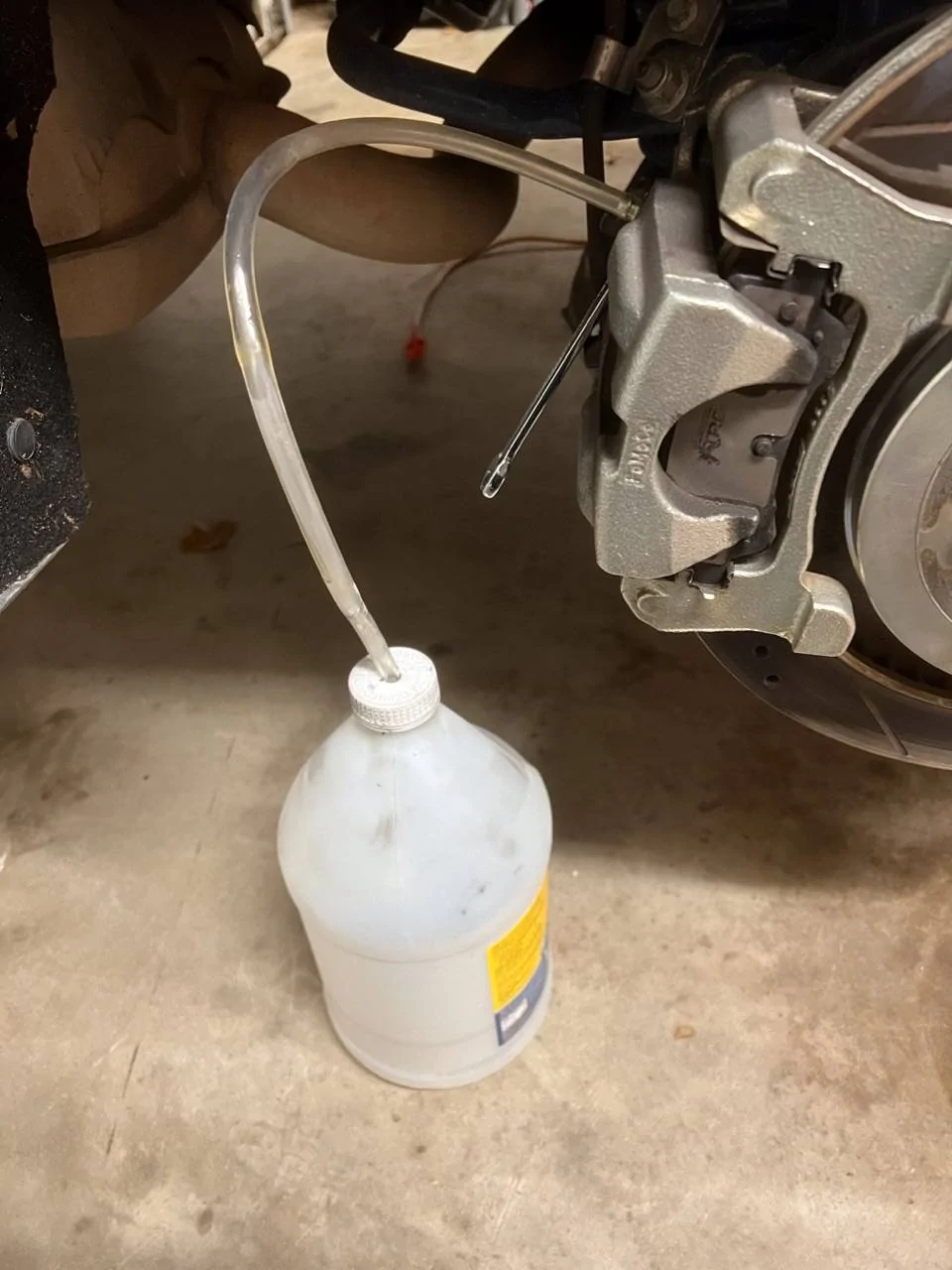

My daily driver saw 8 HPDE events last year using Motul 600 racing brake fluid. I’ve not had any issues with running that fluid on the street.

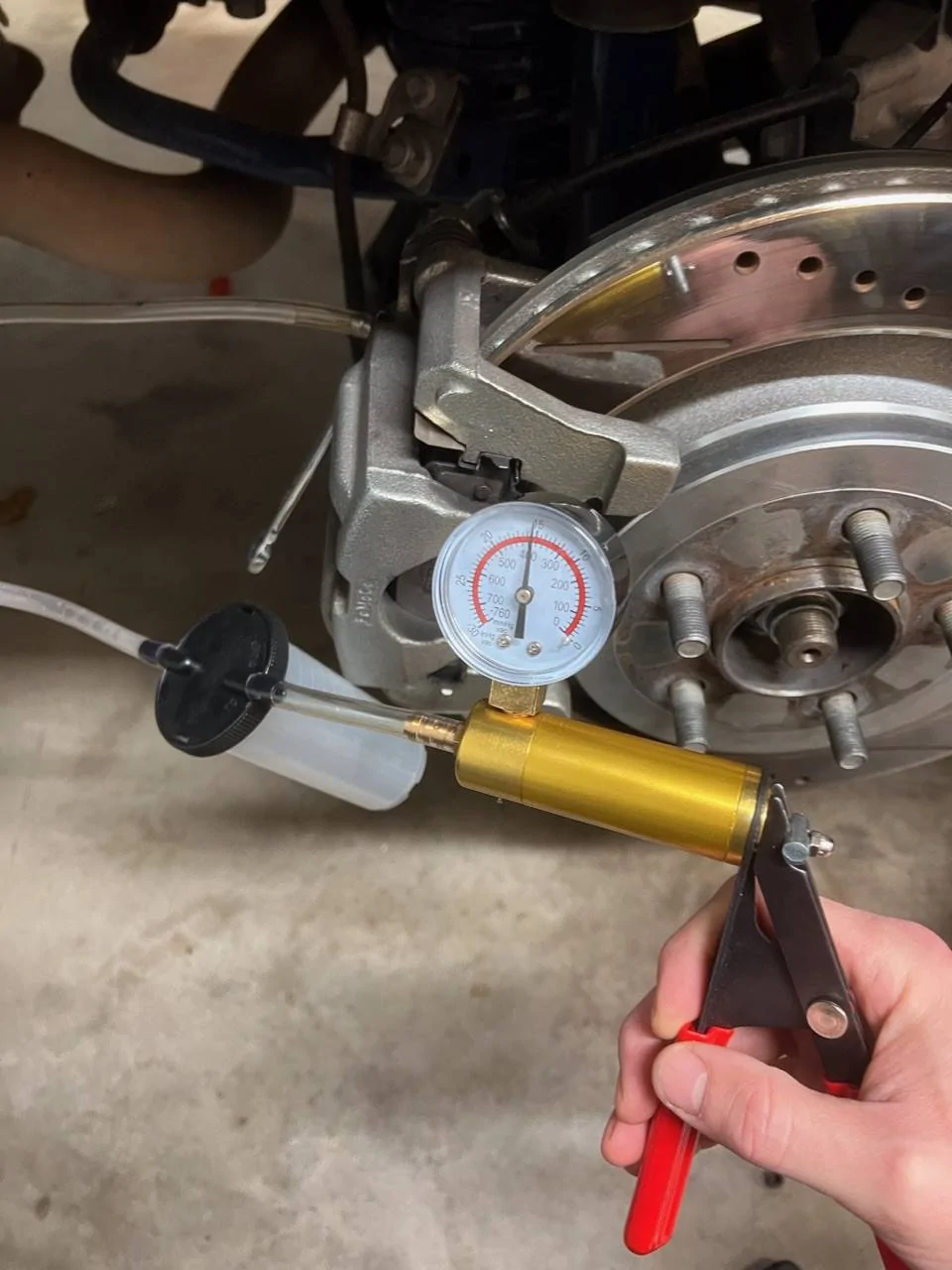

I’ve never used a pressurized method like the Motive, but I have used a had operated vacuum pump to bleed by myself.
That method took a lot longer than I would have liked and I’ve never been confident in the results so I went back to the good ‘ol two man operation with my 14 year old son (and on the rare occasion my wonderful wife).

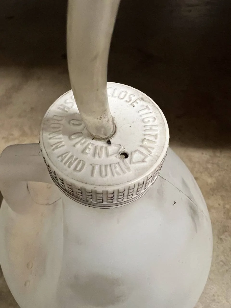

I drilled a hole in the cap of an old windshield wiper fluid bottle and fed the bleed hose through the cap. I also drilled a small air vent hole in the cap to allow air to escape the bottle as it fills with fluid.
My helper sits in the driver seat and operates the brake pedal while I handle the bleed valve. (Down and hold, open valve, close valve, up and repeat).
Next time I bleed the brakes after an HPDE event, I plan on switching roles so my son learns to operate the bleed valve while I sit back and relax in the driver seat and work the pedal 😁
