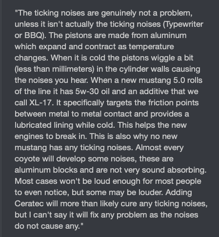

See the post in this thread, attached here.
Any chance you could be specific as to the actual post this was snipped from to save me from going through 47 pages?
Thanks!
