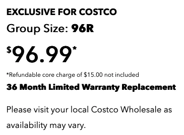

Costco has Interstate 96R for our Shelby's. $100.
