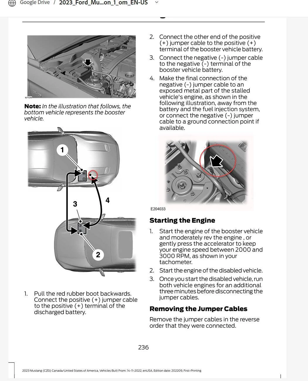

Wondering if you made the last jump connection properly (not to neg post). I have *heard* that if you go to neg batter post it can mess up the electronics of the car.
Aye, I always ground to an exposed / paint-free section of the body on the vehicle I'm jumping.
