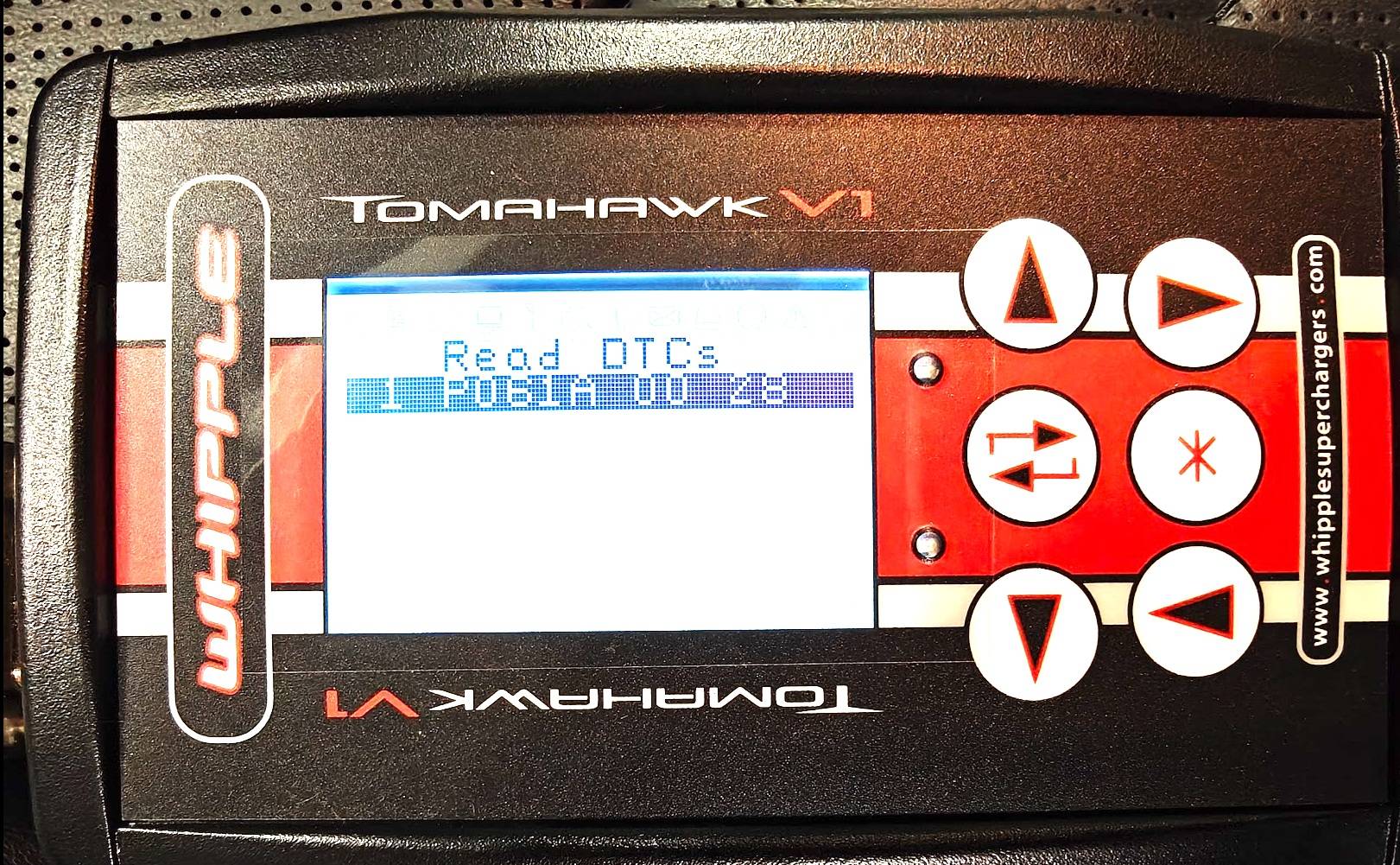

1 DTC was present (P061A) which was cleared. It had no effect, of course -

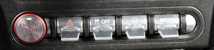

3 of the 4 toggle switches in the center console have no effect when pressed; only the far left toggle (hazard lights) works:

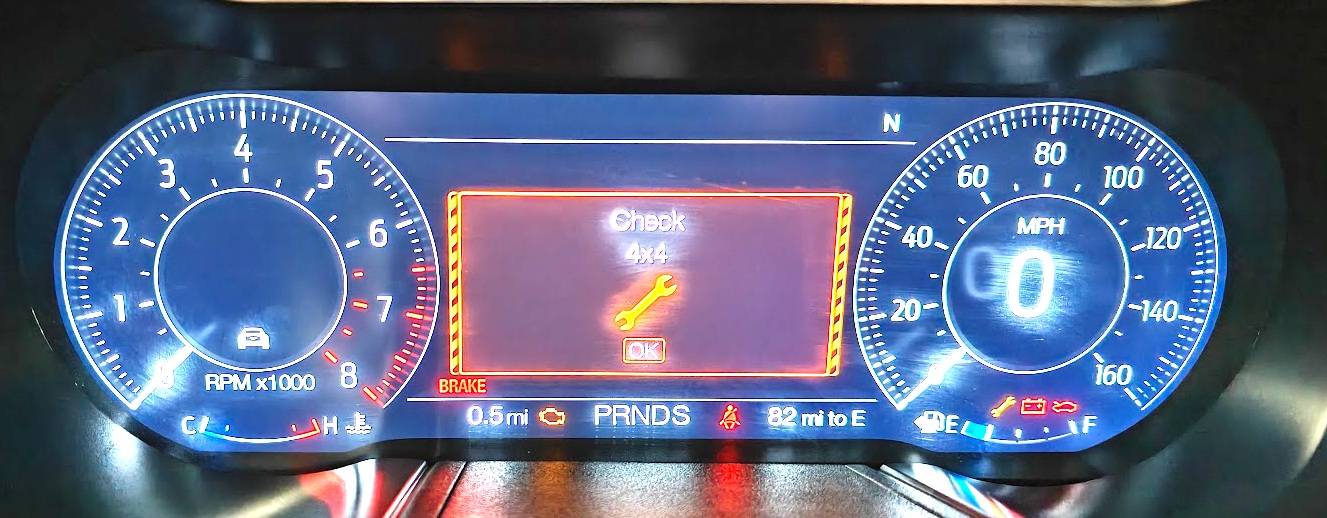

"Check 4x4" Error Message -

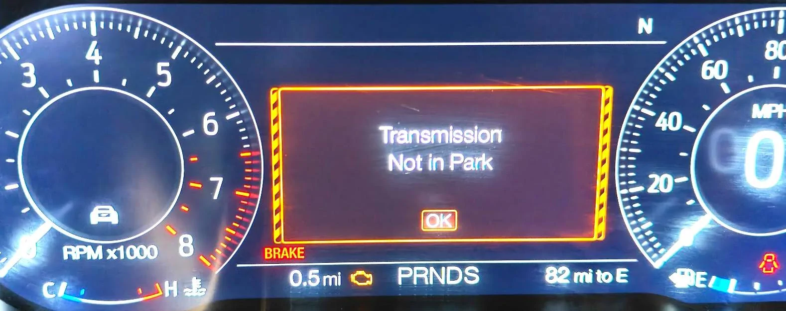

"Transmission Not in Park" Error Message -
Both of these pictures are with the engine off. After starting the vehicle, only the wrench icon (on the right, under the speedometer) is illuminated (no CEL).
