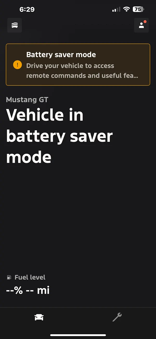

Battery Saver message on a new battery

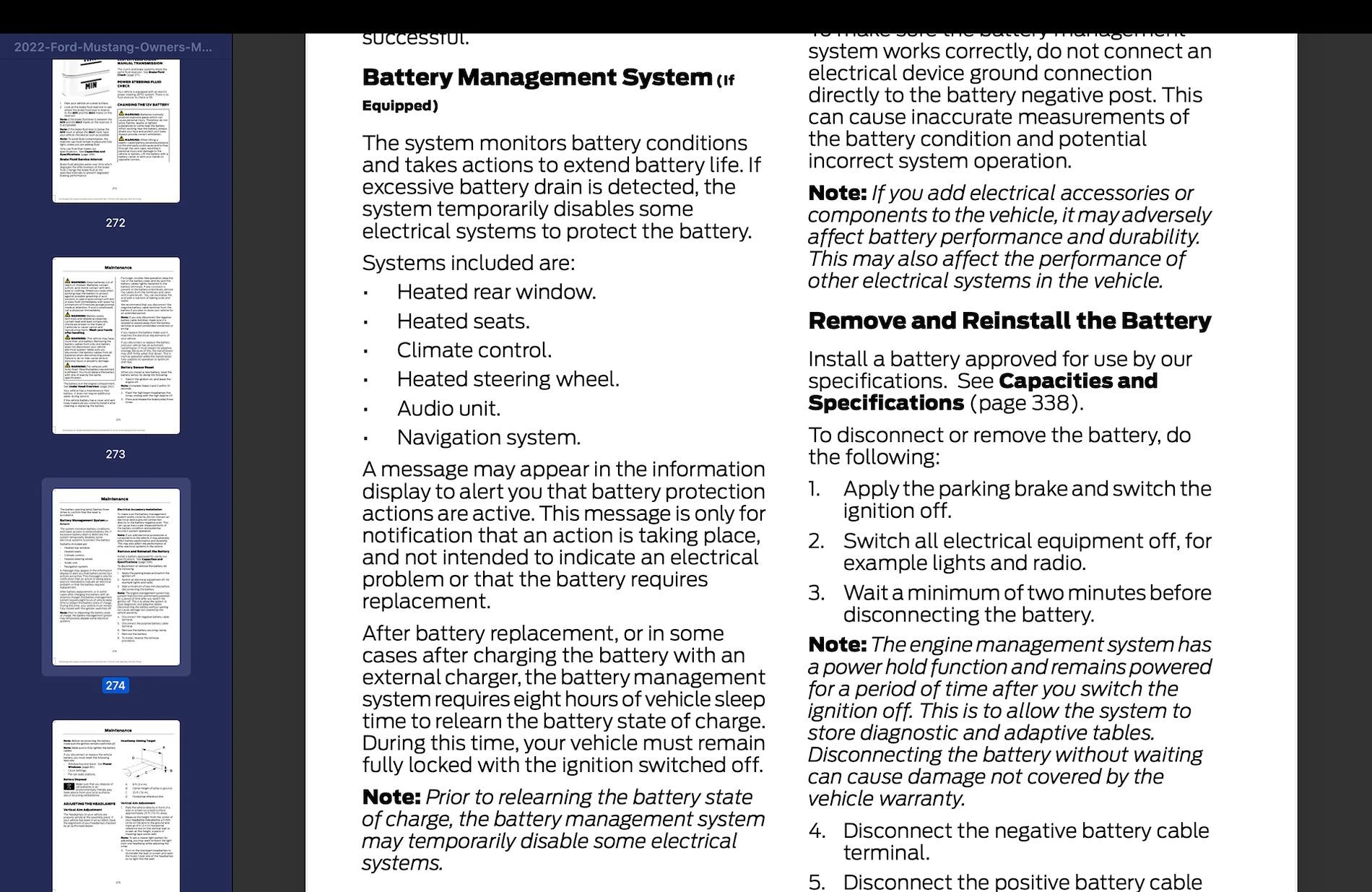

Attached is an excerpt from the 2022 Owners Manual. Along with resetting BMS to let the car know a new battery has been installed, the car should sit (I recommend locked, with no tender attached) for eight hours.
The SoC test is a function of BMS to evaluate the battery. It's like an overnight load test.
BMS tracks battery replacement and adjusts the charging profile over time. The SoC evaluation provides data to support that.

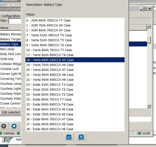

I continue to study BMS, the BCM, FORScan and its use for making the change to an AGM.
Some Mustang and F150 owners have installed an AGM and not changed the battery type in the BCM. Most have. Some have claimed the vehicle will automatically recognize an AGM type, from the SoC evaluation data. But I haven't found any definitive documentation on this.
FWIW, if I were making the change, I'd want confirmation the correct type is listed in the car's systems. From the information I have thus far, I'd be willing to wait a few days to see if it auto-changes. If not, take to dealer to have them adjust or make the change via FORScan, Ford Diagnostic and Repair System (FDRS) or something else.
When using FORScan or similar program, a list of batteries will be presented. Your battery might not exactly match something available in the tables. If in that situation, select an AGM with the closest, but lower, Amp-hour (Ah) and Cold Cranking Amperage (CCA) rating. Selecting one higher would lead to overcharging.

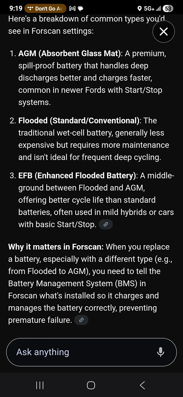

When using forscan you will be presented with 3 options. Std , AGM , EFB
You don't need to change your SOC rate or anything else.
Forscan is the only option available to make this change. Your dealor will not do anything with forscan as it is a 3rd party platform. There are tons of videos on you tube to teach you all about forscan and how to use it.

I continued reading up on these topics this morning. The following are some links and insight I found useful.
There are a lot of sites, threads, and comments on BMS. I was interested if, in even the latest Ford software, BMS was capable of auto-sensing battery type. I was also interested on how that could be possible.
With respect to 6G threads, I parsed the sensing comments into three buckets:
- Those that claimed BMS senses the battery type, or the battery type does not matter, and no BCM changes are required
- Those that felt, if a battery was selected with the same Ah rating as the original, the battery type setting could stay the same
- Those who changed the battery type, size and capacity via FORScan
The following thread is from a Maverick forum. In post #26, someone who had changed battery type monitored his system over several days. He confirmed BMS does not sense the type (Flooded, Absorbent Glass Matt, Lithium, etc.).
https://www.mavericktruckclub.com/f...onitoring-system-bms-explanation.43482/page-2
The next thread, from an F150 forum, highlights many of the BMS-related parameters that could be changed. Note the post is from a 2017 era F150 forum. It's simply an example of the Ford software.
https://www.ford-trucks.com/forums/1677378-forscan-agm-battery-setting-2.html
In the last thread, several screenshots in post #6 highlight battery case types. This is from another F150 forum. The parameters displayed in the thread might not exist in a Mustang. This example and the one above show how granular the software can be, depending on model and year.
https://www.f150forum.com/f118/battery-size-change-forscan-553330/
One 6G discussion on selecting battery type.
https://www.mustang6g.com/forums/threads/forscan-setting-for-agm-battery.146806/
Another 6G discussion, showing (Post #15) some of the 6G battery parameters in FORScan.

Where is the standard 96R battery size?
Skye
Jan 18, 2022
3,033
4,254
≈39N
"Skye" Mach1 N2144
I do not have an answer. Just a thought.
As a reference my battery is a BXT-96R-590. The stock, OEM unit.
From what I've seen thus far, there is no AGM 96R in the selection menus, just the more modern "T" and "H" case sizes. Post #20 in the following thread confirms that.
https://www.mustang6g.com/forums/threads/performance-battery.138087/page-2
Here is a thread discussing case sizes and AGM batteries. Several have used a Group 48 size battery.
https://www.mustang6g.com/forums/threads/48-agm-battery.208970/page-3
Group 48 translates to a "H6" battery size.
https://antigravitybatteries.com/he...cmtRvNOHIpMphkWDWw1eRlhj3fs3MCuuzaRsuapmgoBHe
Given all that, the closest AGM selection to my batt I see in the menu is "1- AGM 70ah 600CCA H6 case".
