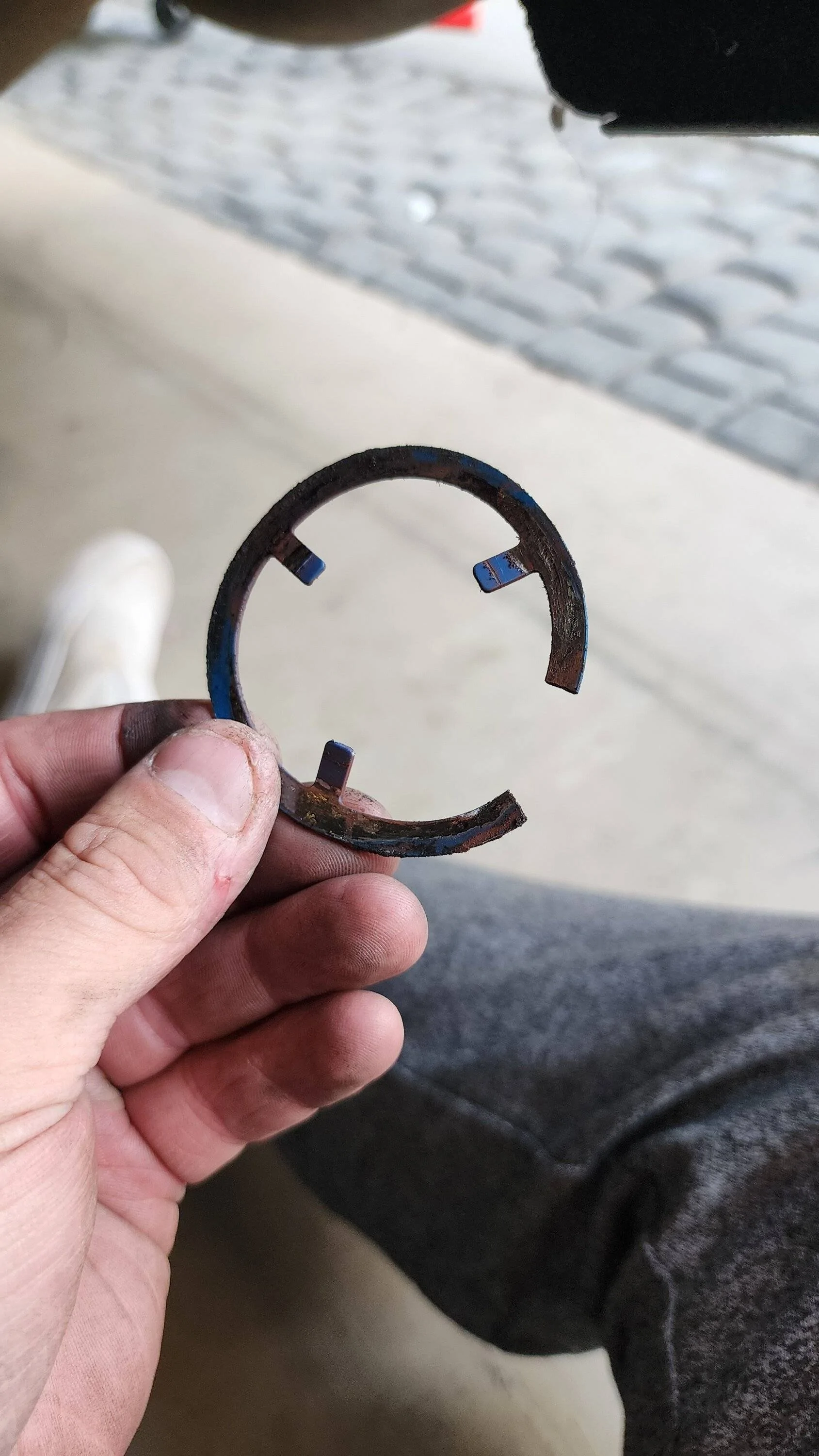

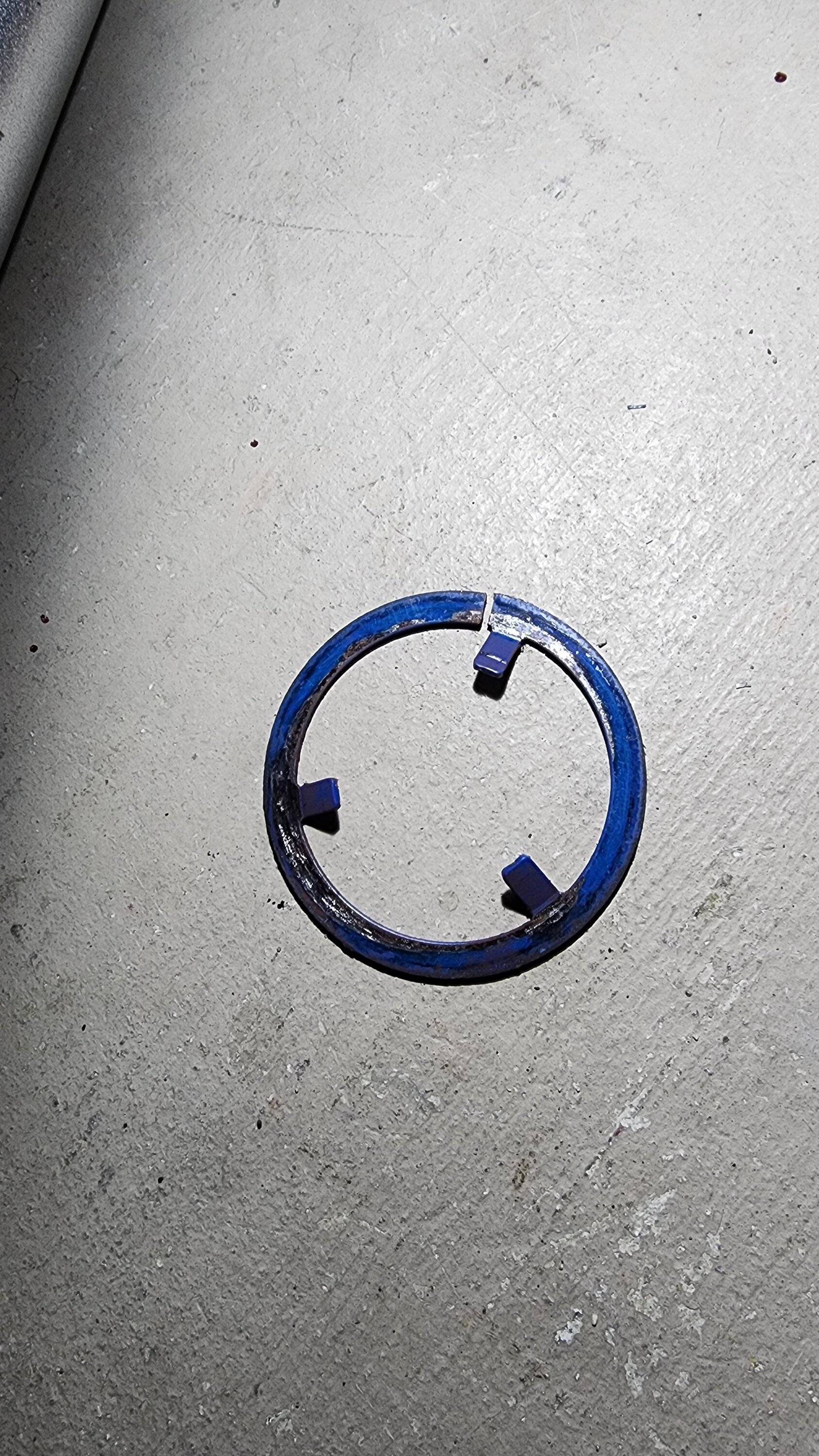

Pulled off both wheel hubs and found both thrust washers were broken. I'm so happy I bought two when I went to the Ford dealership (it was an hour drive away each direction).
Put everything back together and all the lights cleared as soon as I got up to speed. No more fault lights on the dash whatsoever.
