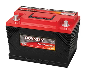

I have been looking for an AGM battery that properly fits the S550. Finally found one. Odyssey 96R-650
https://shop.odysseybattery.com/p/96r-600
Those bastards actually stopped making that battery ALREADY. It hasn't even been a full year since this post and it's already no longer available. Lol.
I'm buying one from AutoZone today assuming they honor their veteran discount.
It sounds like they resumed production at some point. Amazon has them as well as a few local auto part stores. Odyssey's on-line store has them out of stock at the moment.
For warranties It's not good if a brand drops a type for your size or a store drops a brand. I bought a Bosch from Pep Boys for my S550 4 years ago (3 yr full replacement). Died with a few months left but Pep Boys had closed all stores and just had service centers left. Those didn't carry Bosche, so they would only put in a Champion which now won't hold a charge a year later.
