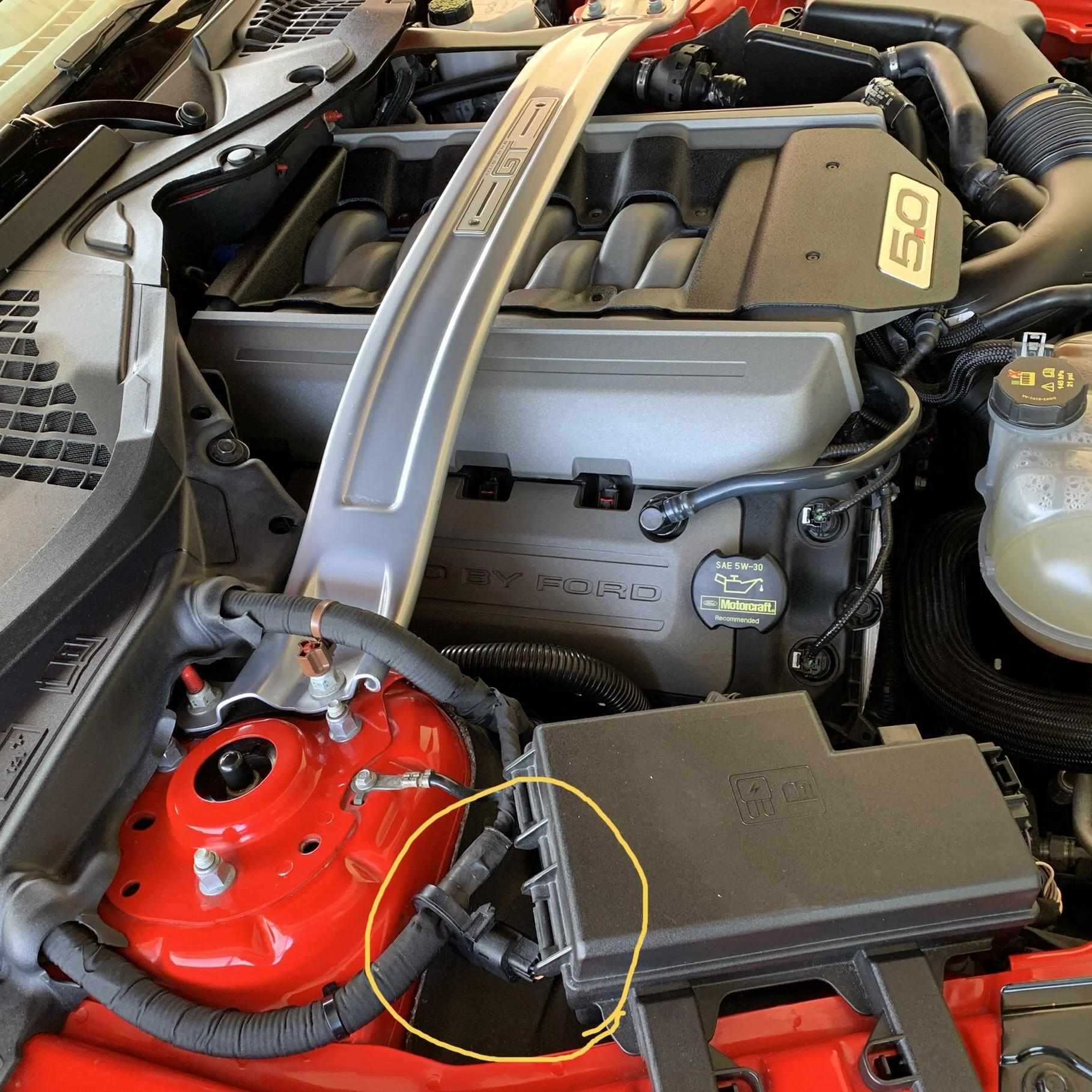

Yep. I just unplugged mine and taped the ends.
I can see the part above near the fuse box under the hood, but where is the other one located?

I think the dealer may try to blame me for shorting out the sensor.. if so no warranty. If that happens I'll just get my car back and unplug...….

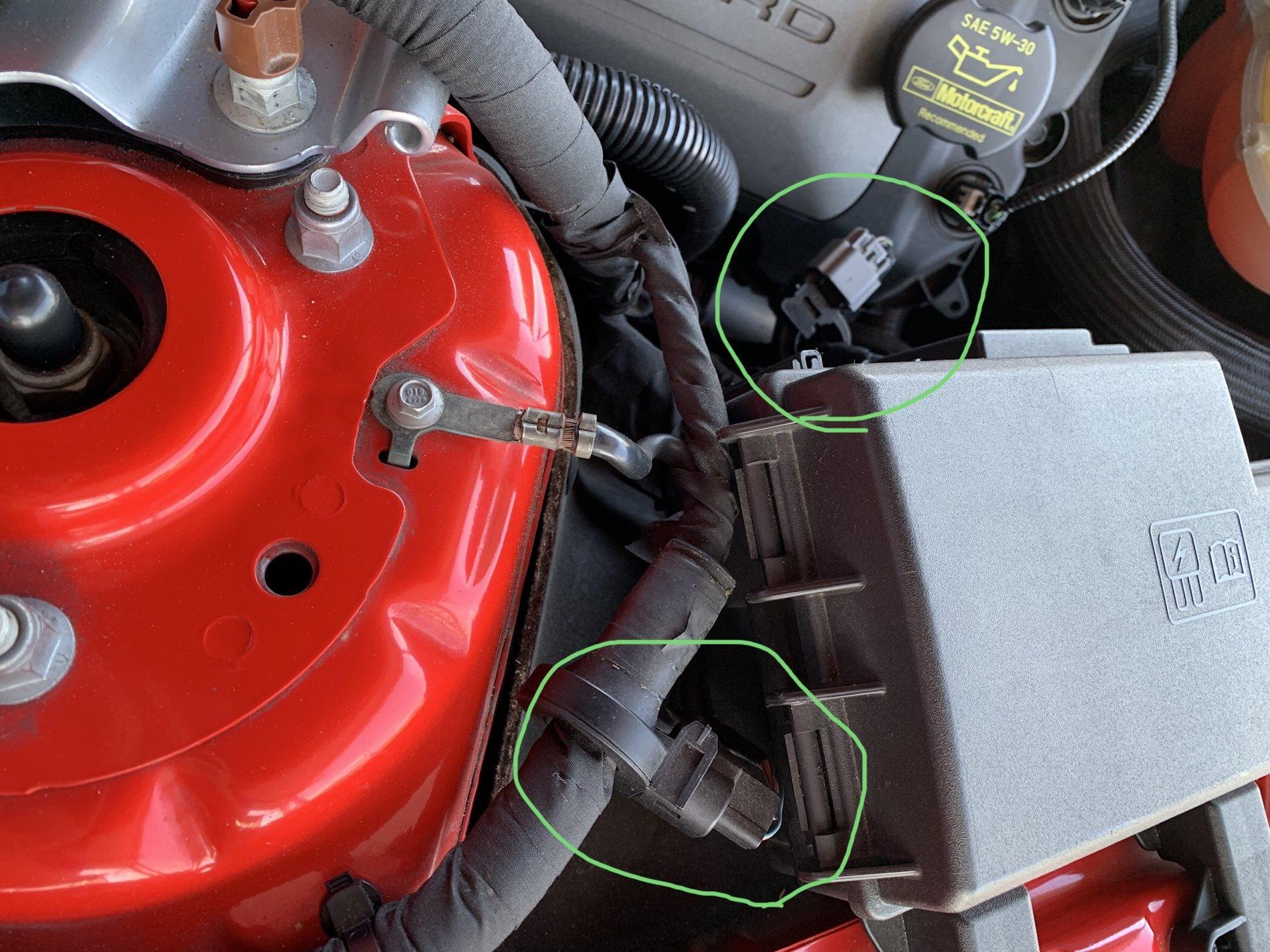

I thought I would take a picture for future reference if anyone was interested. Thanks go to those that pointed me in the right direction. These are the two sensors that thehunteroo was talking about. My system seems to be working fine and it has a new battery with a January 2019 date so hopefully I will not have any issues. But it is nice to know for future reference.

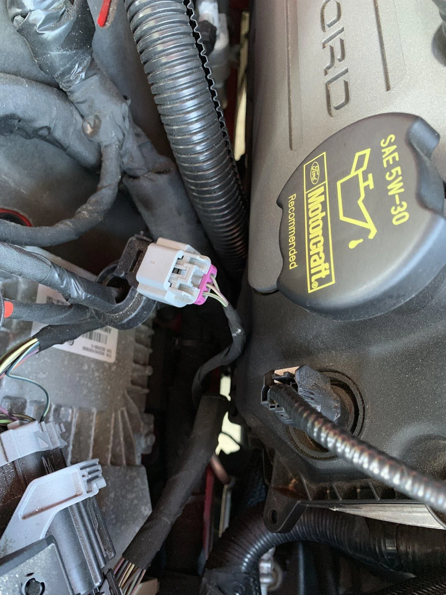

I almost forgot I had taken another picture of the BMS sensor located between the fuse block and the engine. This one better shows that sensor.

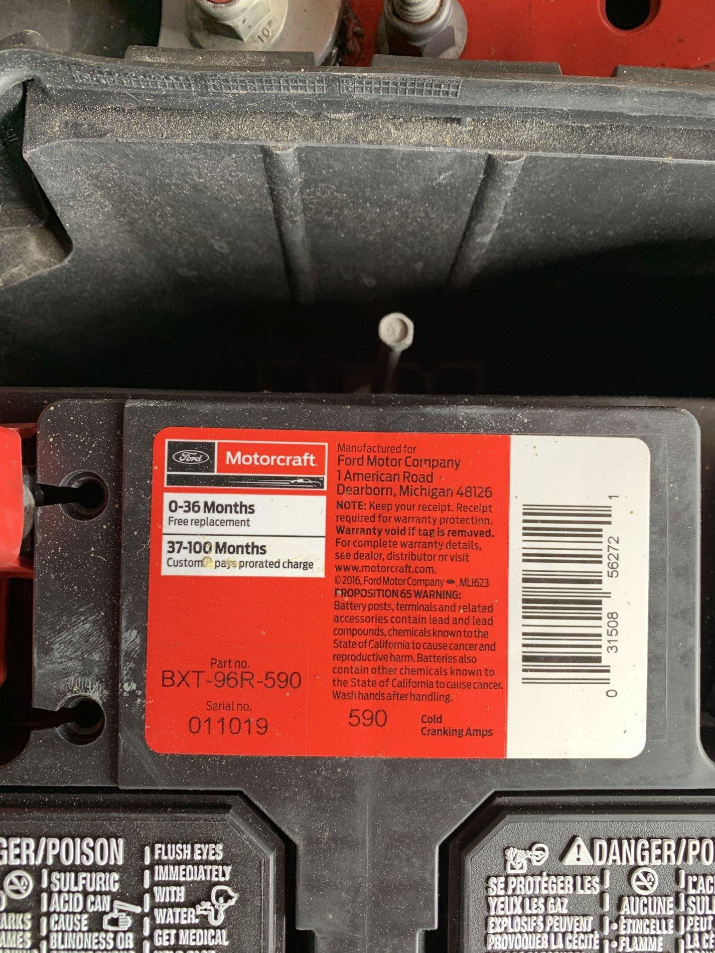

Both. You need to put 3-4 key cycles on it. You may also have battery on it’s way out.
Ah, okay. I only tried it twice. I will keep an eye on it tomorrow and see what happens. This is the battery....
