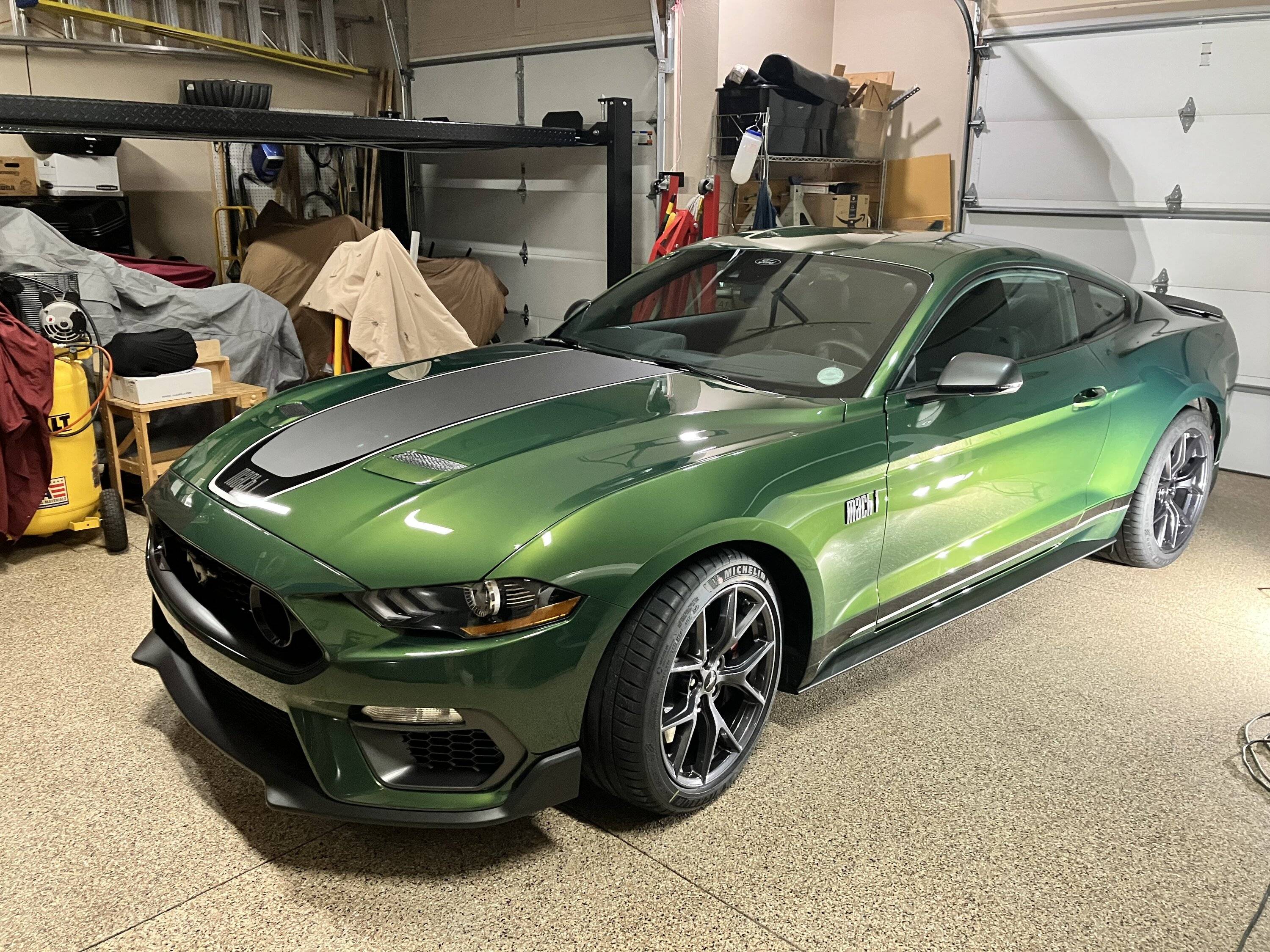

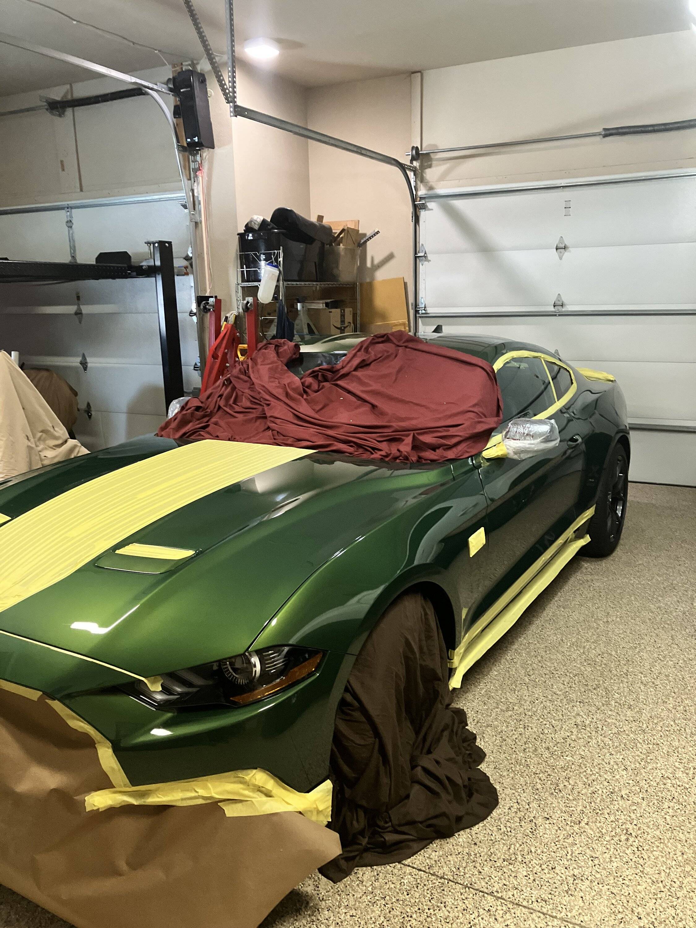

DFB is the forum Guru on the subject. I'm just wrapping up my new Mach 1. I'm not fast, but thorough. I've got at least 25 hours in mine. The process I picked up here and off of a few Youtube videos was the same or very similar. Snow foam wash, iron remover, wash/dry. Mask off the decals and rubber trim. (Edit: forgot the claybar step followed by Eraser) Paint correction for scratches, Carpro Reflect fine polish with a 6" dual action polisher. Eraser (isopropyl alcohol solution to remove any wax/oil and get to bare paint.) Then two coats of ceramic coating. Doesn't sound like any professional could do that in 5 hours. or anywhere close. Look elsewhere.
PS - The UK Quartz ceramic product I used said to ensure it isn't exposed to water for 24 hours to avoid water spotting.

I haven't had a chance to clean up the glass or do the wheels yet, but it's getting there. Best of luck with yours.

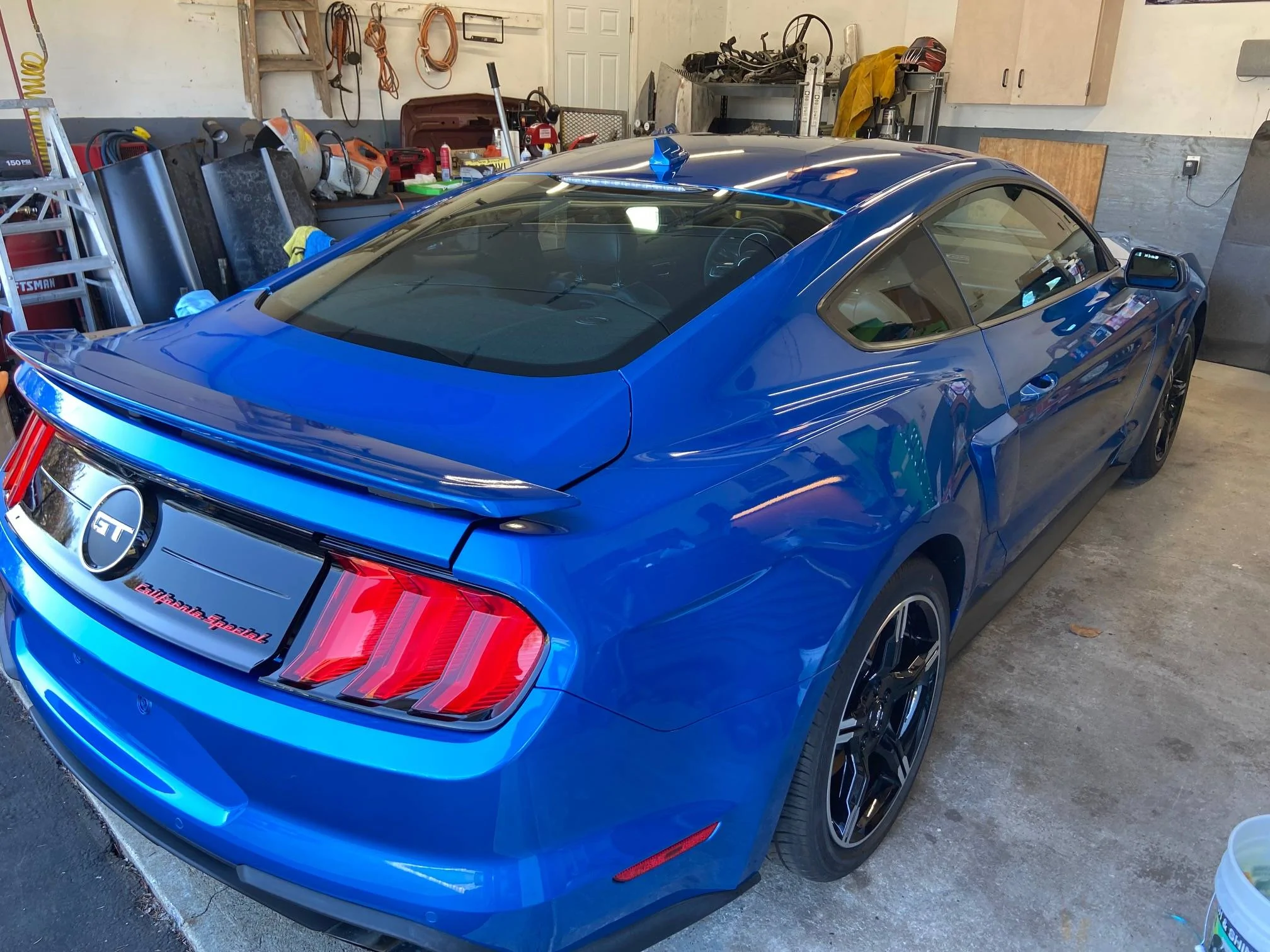

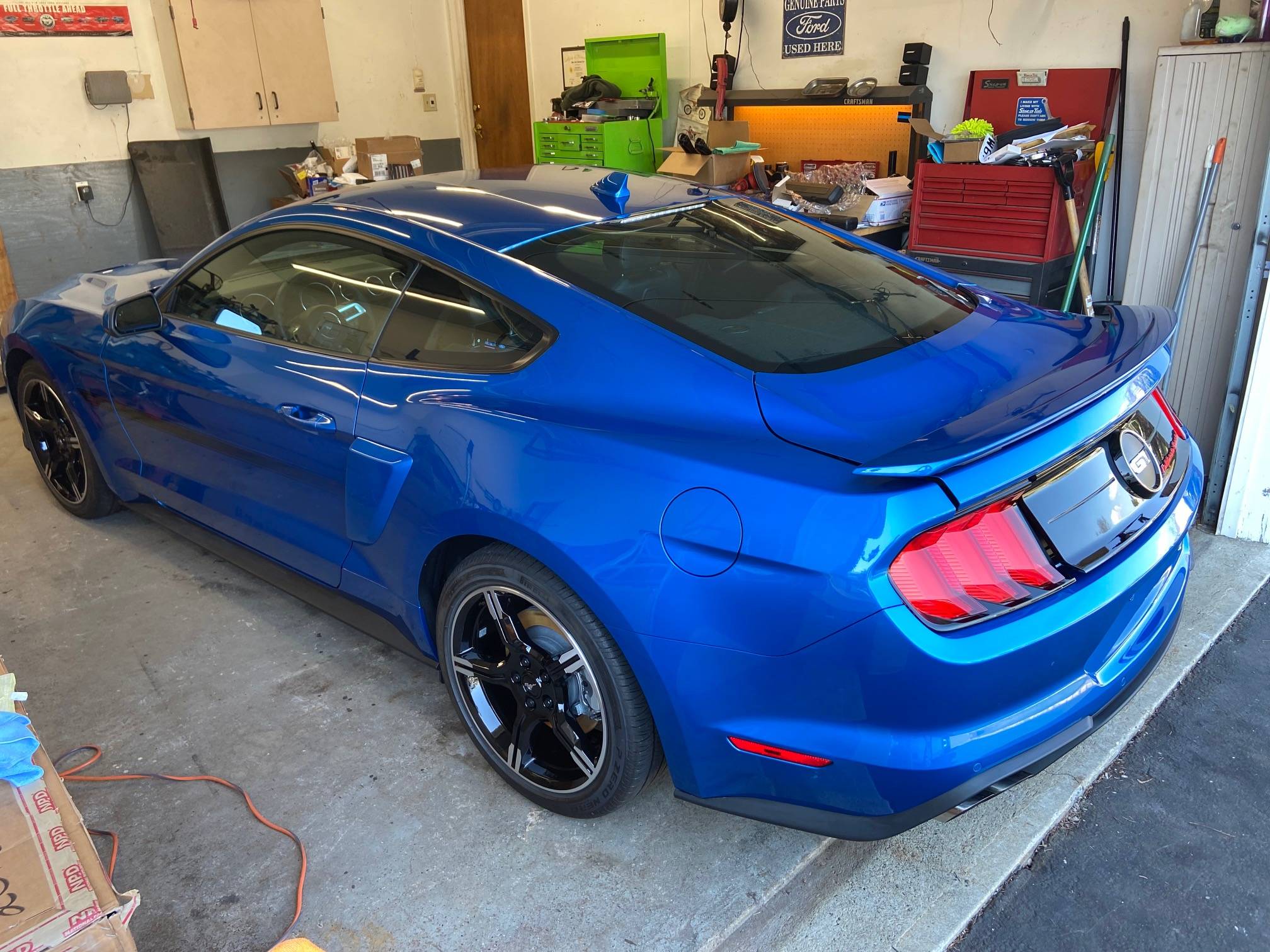

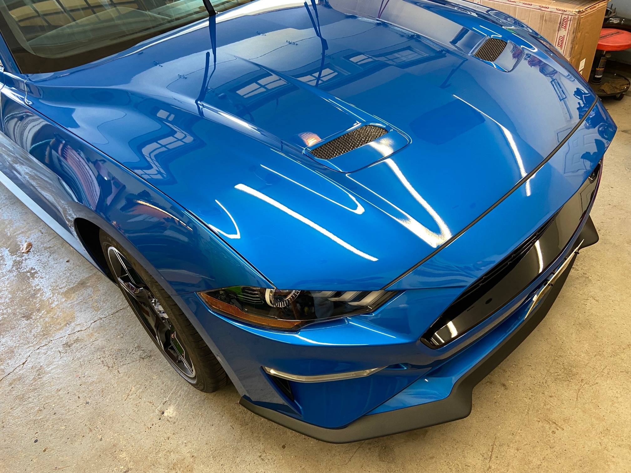

I coated mine in 2021 using Gyeon Q2 Mohs EVO. I'll admit I'm slow...followed all Gyeon's instructions and additional input from DFB5.0. It took me the better part of a weekend to complete all the prep...and about an hour to actually apply the coating. I let the stang sit in the garage for 2 days before driving. 5 hours to do a complete and through job seems a bit rushed to me. 2 days for a pro with everything set up seems more reasonable time frame.

Bobn, did you do some cutting to flatten the orange peel? I did not. I wasn't game for getting a meter to measure clear coat thickness and cut it down. Yours looks pretty darned flat. I just fixed the scratches and used the Reflect fine polish.
