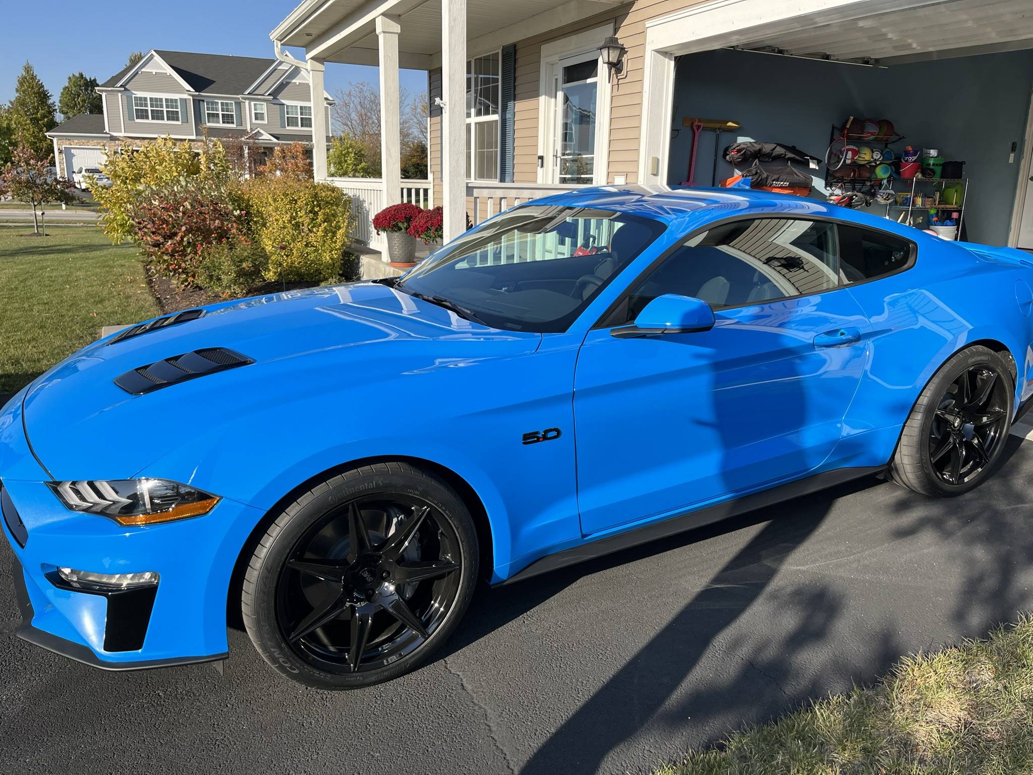

I did mine a few weeks after i took delivery of my car, so early October last year. Day 1 was the wash and decon, left it in the garage overnight for any remaining dampness to dry. Got up the next morning and did the light cut & polish. Used 50/50 Urofiber pads and Turtle Wax Hybrid Solutions Pro One and Done polish. Ethos Matrix Graphene V2 coating. Ethos says not to get the car wet for a minimum 24 hours so it just sat in the garage (ended up sitting for about 36 hours before I drove it again). As others mentioned, don’t worry about dust and stuff once the coating has been applied as the residue is wiped off during the application process. It’s dry to the touch right away. No washing for 7 days as the coating was still curing but 75% of curing is done in the first 24 hours. It just takes a while for that last 25% or so.

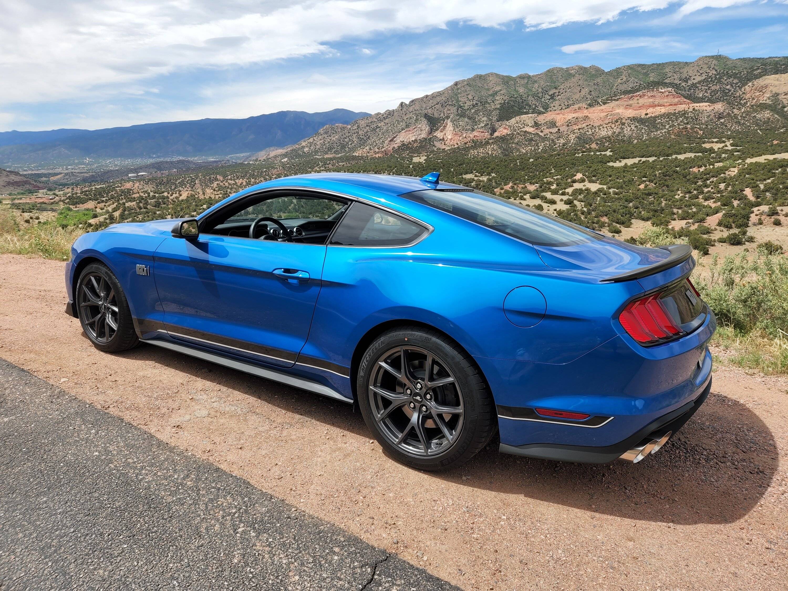

The crisp reflections show the work you did cutting the clear coat. Nicely done.

Your car looks fantastic.

Thanks. And totally understand about not being comfortable with it. Sounds like you have a couple options as far as shops go which is good.
